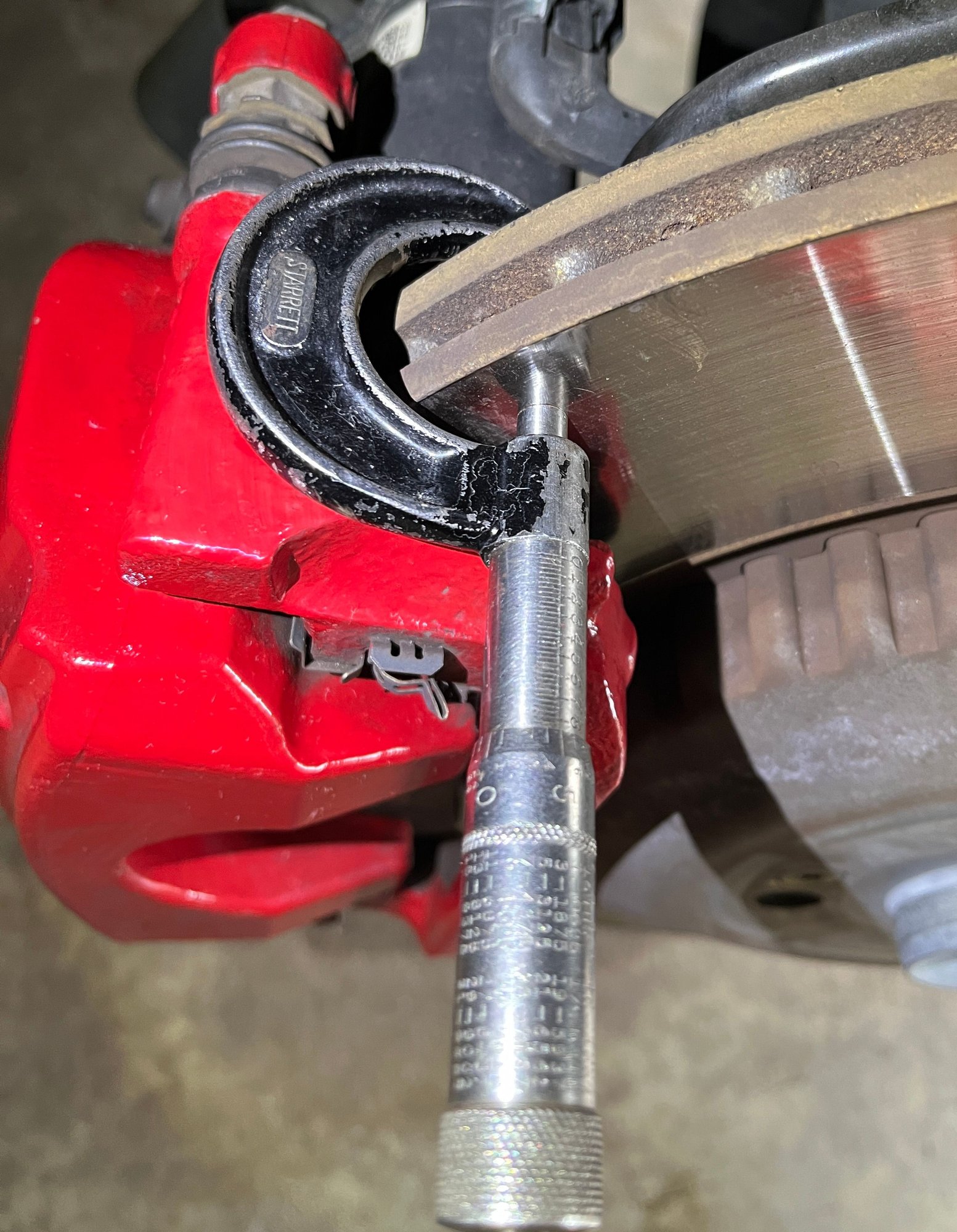

I am taking my EQS SUV to the dealer for its annual PA Safety Inspection tomorrow. I decided to check the condition of the rotors and pads beforehand.
The minimum thickness stamped on the rotors is 30.4mm for the front and 19.4mm for the rear rotors. After 44,500 miles the actual thickness (measured with micrometers shown in photos) for the rotors is 32.8mm and 21.7mm for the front and rear respectively. I haven't been able to find specs for the thickness of new rotors, but I suspect that it is 33mm/22mm for front/rear. Based on the wear over the last two years, I think the rotors could easily make it to between 150,000 and 200,000 miles.
I estimated the thickness of the pads by comparing them to hex wrenches as shown in the attached photo. The front pads were about 7.5mm and the rear pads are about 5.6mm. I purchased a new set of rear pads and measured the thickness of the friction material to be just under 8mm. I do not know the thickness of new front pads, but I speculate that it could be as much as 10mm. Based on the condition of the pads, I estimate that they will last for 100,000 miles. The minimum thickness is 1.6mm to pass the PA State Inspection. i would estimate the rear pads to be down to 3mm by the time I reach the 100,000 mile mark. The rear wear sensor will trip at between 3.5mm and 4mm pad thickness, so the sensor may have to be removed between 80,000 and 90,000 miles.

Estimating thickness of front brake pad.
Measuring thickness of front rotor.
Measuring thickness of rear rotor.

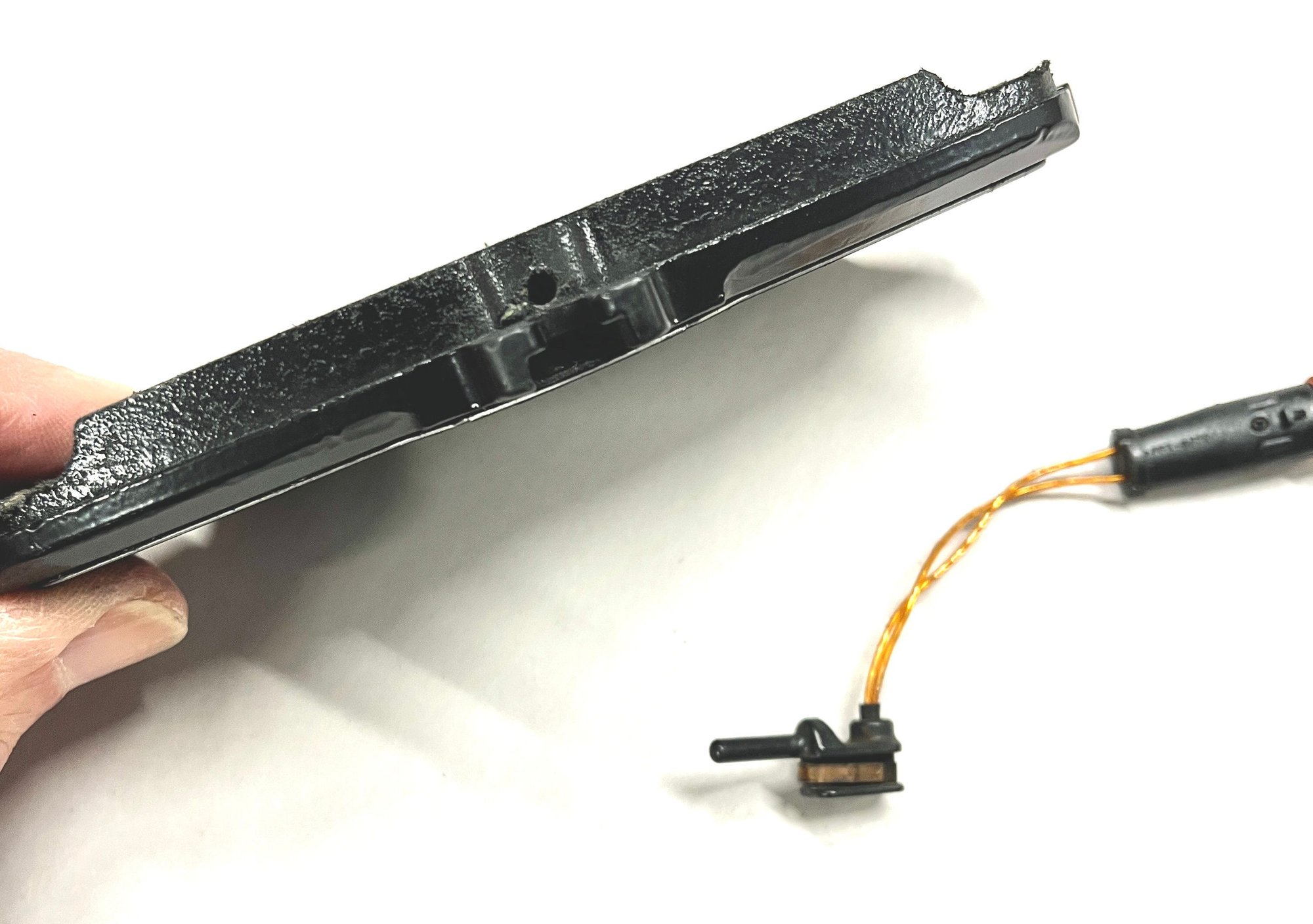

I really doubt if your rear pads are worn down to 3mm thick. I attached a photo of an EQS rear pad along with a brake pad sensor. The thickness of the friction material on a new pad is 7.6mm. The diameter of the pin on the sensor that plugs into the pad is about 3.1mm. The edge of the hole where the sensor plugs into the friction material is about 4mm from the surface of the pad. You should remove a wheel and inspect the thickness of your pads, or at least have another shop do this for you.
New condition EQS rear brake pad. 7.6mm thick friction material.
