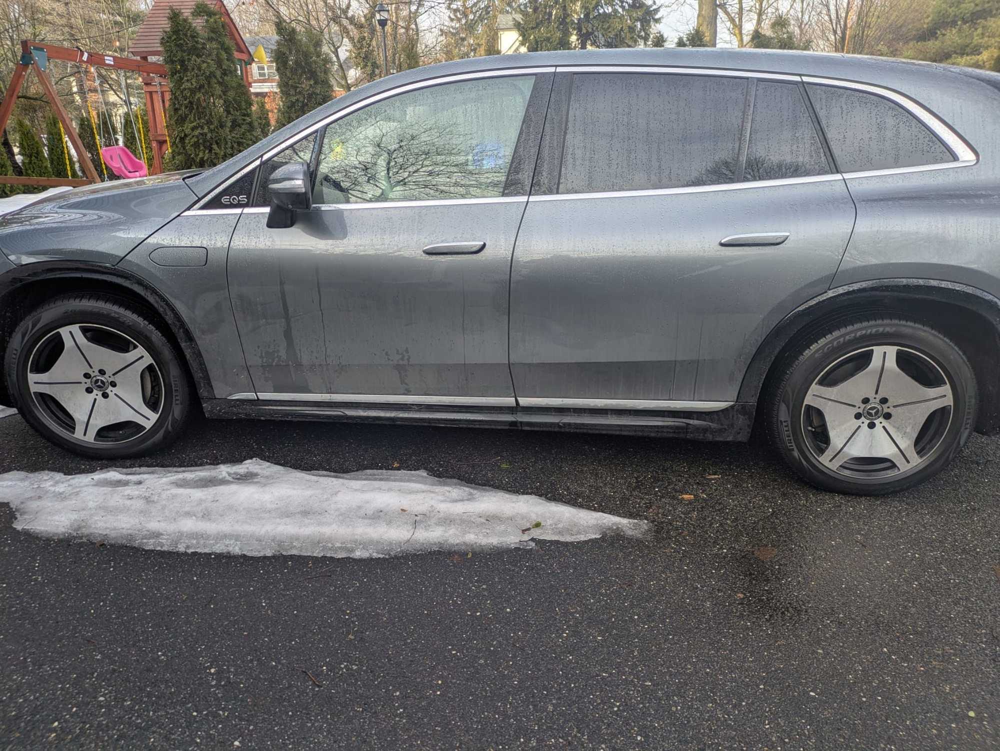

I got some cheap(ish) chinese knock-offs to downsize from the stock staggered 21" rims, to a symmetrical 20" set.
They don't look bad, but my main goals were a smoother ride & more tire options. I ended up getting the Pirelli Scorpion AS Plus 3 that Lazaru5 recommended.
For anyone curious, here are the spec's I found for 3 OEM rim/tire sizes that came with the car:
Staggered 21":
Front width 9.5, offset 30.1, tire 275/45
Rear width 10, offset 36, tire 285/45
Symmetrical 20":
Width 8.5, offset 29.5, tire 265/50
Symmetrical 22":
Width 9.5, offset 30, tire 275/40
The aftermarket rims I got (Model H3069FA or FBX035-20 by Jiangxi Fandian Wheel Forging) are symmetrical 20", width 9.5, offset 43. The increased offset was not an issue on the Rears because of the reduced width. However, the Fronts were lightly rubbing on the suspension, so had to add a thin spacer there.
