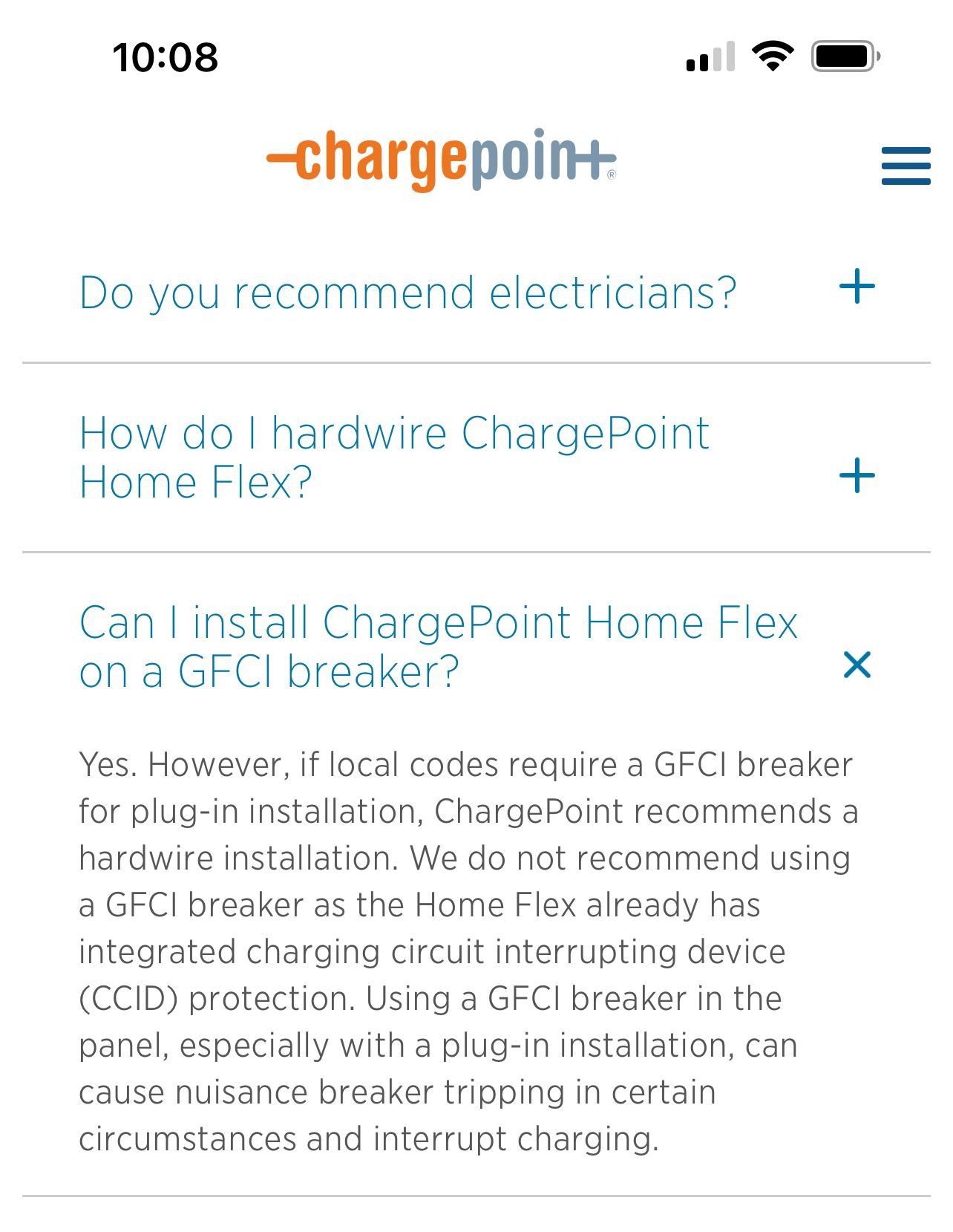

I am not a certified electrician but have experience working with county building inspectors. They usually don’t have all the answers. In this case, I believe the ChargePoint Home Flex has a GFI built into the unit which means you don’t need a GFI breaker. I would recommend replacing the 50 amp GFI breaker with a regular (and much cheaper) 50 amp breaker and I think your issue will be solved.

Here is information straight from ChargePoint website indicating that an interrupt t I jot is built into the HomeFlex and this GFCI breaker is not needed and can be problematic.

Thats what I was referring to. However, he doesnt have any additional ones that he is aware of, unless the breaker has one?

I think your earlier post is correct. The circuit breaker in his panel is a GFCI breaker so combined with the GFCI built into the HomeFlex there are 2 GFCI on the same circuit which can/will cause issues. Removing the GFCI circuit breaker in his panel and replacing with standard circuit breaker should fix the issue. If the county inspector has an issue with replacing the GFCI breaker then show him ChargePoint’s specs indicating built in GFCI.

One more (hopefully) the last update. My installation with the GFCI had not been inspected yet so when the county inspector came out I was ready for him. I had the Chargepoint FAQ excerpt with me. We had a nice discussion about the problem. He agreed that the best way (and the code compliant way) to get around the code was to hardware the Chargepoint box. It's a fairly easy process as the breaker panel in about six feet from the Charger so I will have the electrician back to kill this snake once and for all.
