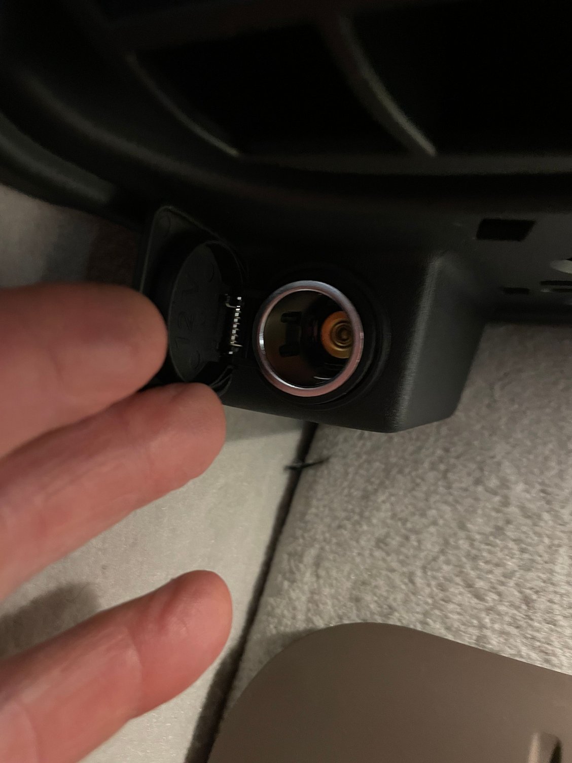

2019 SL550/2023 EQS 580 SUV
This is under the glove box on my 580 SUV. Why MB doesn’t finish these on all units is a mystery. It is absurd to think that just because a vehicle originally comes from the factory with run flat tires that it will always have run flats mounted. I also don’t know why some new EQS’s come with run flats and some standard tires, some staggered and some not. Maybe there is a shortage and they use what is available at the time of manufacture.

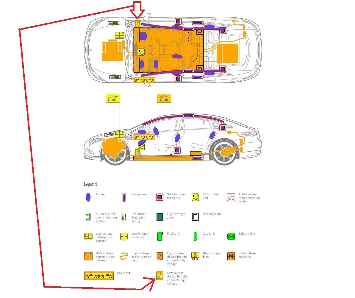

It does not seem that the fuse box is related to the Hyperscreen, but as a ''low voltage device that disconnects high voltage'' (eg in an emergency situation).
Take a look at this:- (https://rk.mb-qr.com/en/297.155/)
It should house a device to disconnect the car's high voltage system in an accident by rescue workers.
