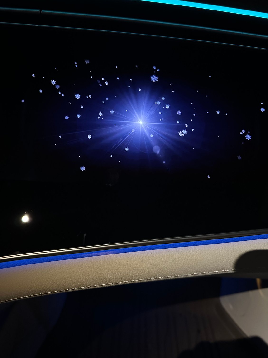

Mine looks like this now with empty passenger seat.
I can’t seem to turn it on by myself as others have said. Haven’t had a passenger yet to make sure it turns on when they are seated.
Edit: Had my nephew sit in seat and immediately the on/off button popped up.
