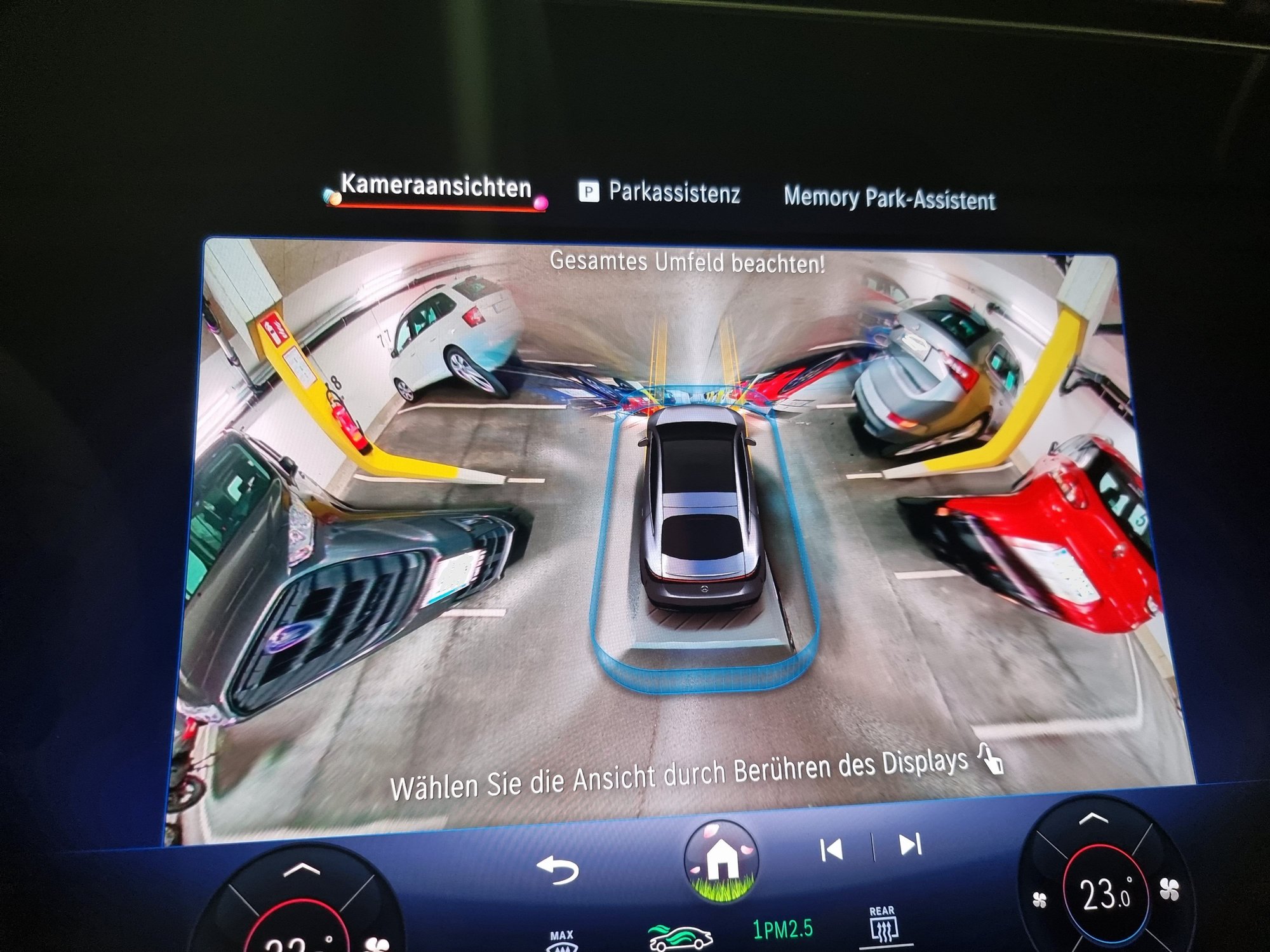

I think they claimed 3 hours working time. So not sure if you call that straight forward. On the receipt it says only a short check was performed. No recalibration mentioned.
I any way believe that the front camera auto calibrates itself every time it is started. I only one time had the funny incident that the front camera image was stitched into the 360° surround image rotated by 180 degrees, see the photos.
Luckily the EQS has no autopilot like Tesla, otherwise it would try to evade a tree on the left which it sees upside down on the right by steering left and crashing right into it...

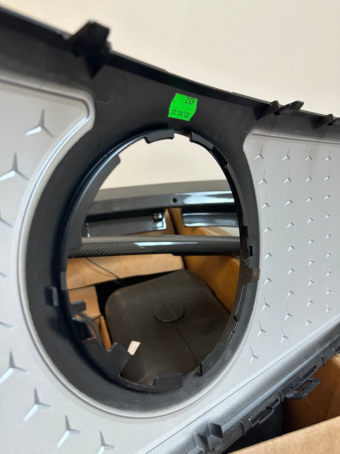

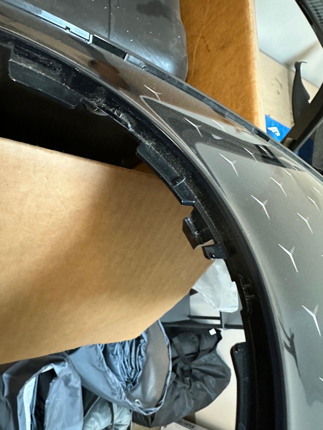

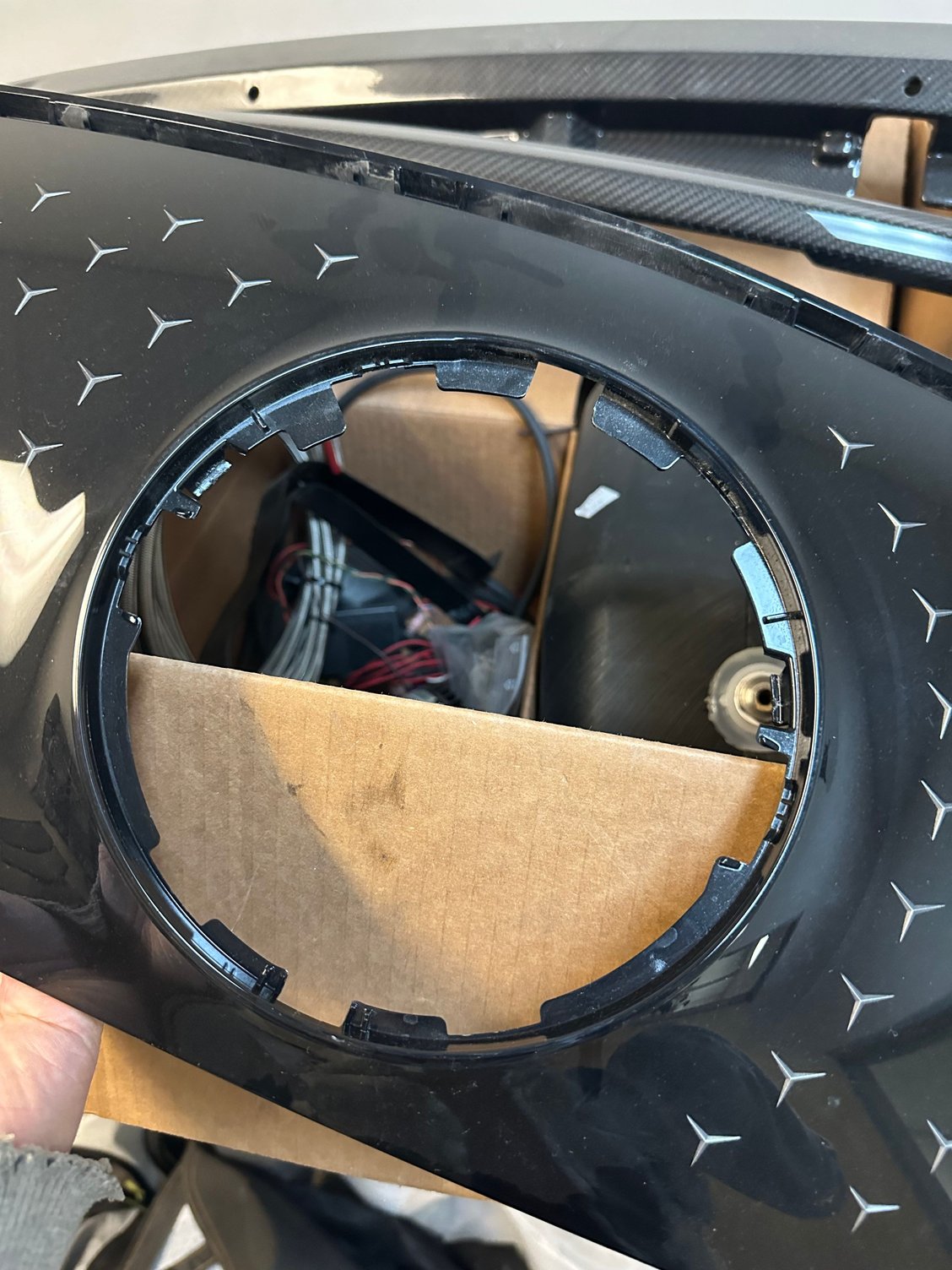

I took few photos for you. It looks like turn and also clip. I tried to remove the grill before, I stopped before disconnecting camera because the notice I can’t do this alone within 2 hr. I use a 3 iron to keep the hood open but yeah it is one big problem to keep it open
Originally Posted by MB37
Thanks for the tip. I'll try to get the hood open, remove any bolts and light bar. As for the back side of the emblem, the EQS as the flat MB star, and I saw other tubers having to unclip it (instead of turning clockwise) from the backside. I think it will depend on how much room I have once I remove the light bar. My other challenge is probably keeping the hood open since there's no struts.
