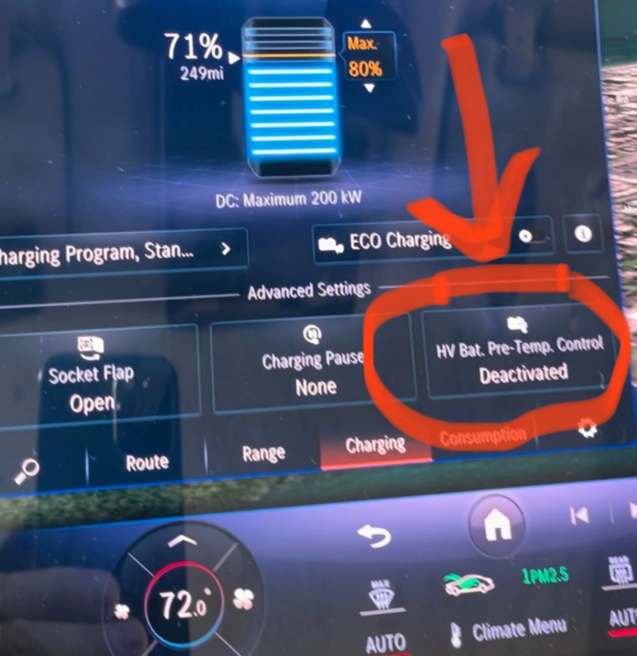

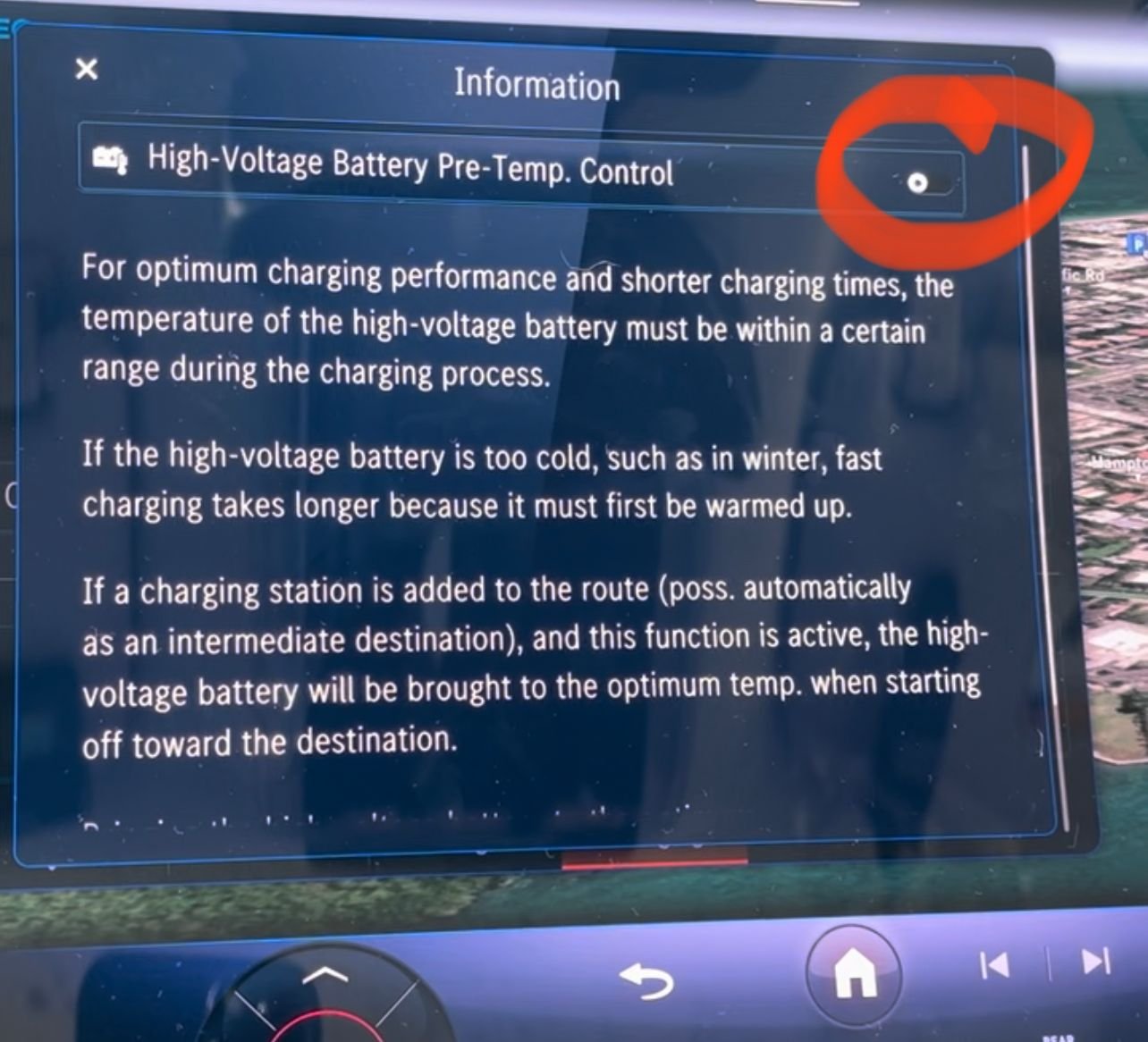

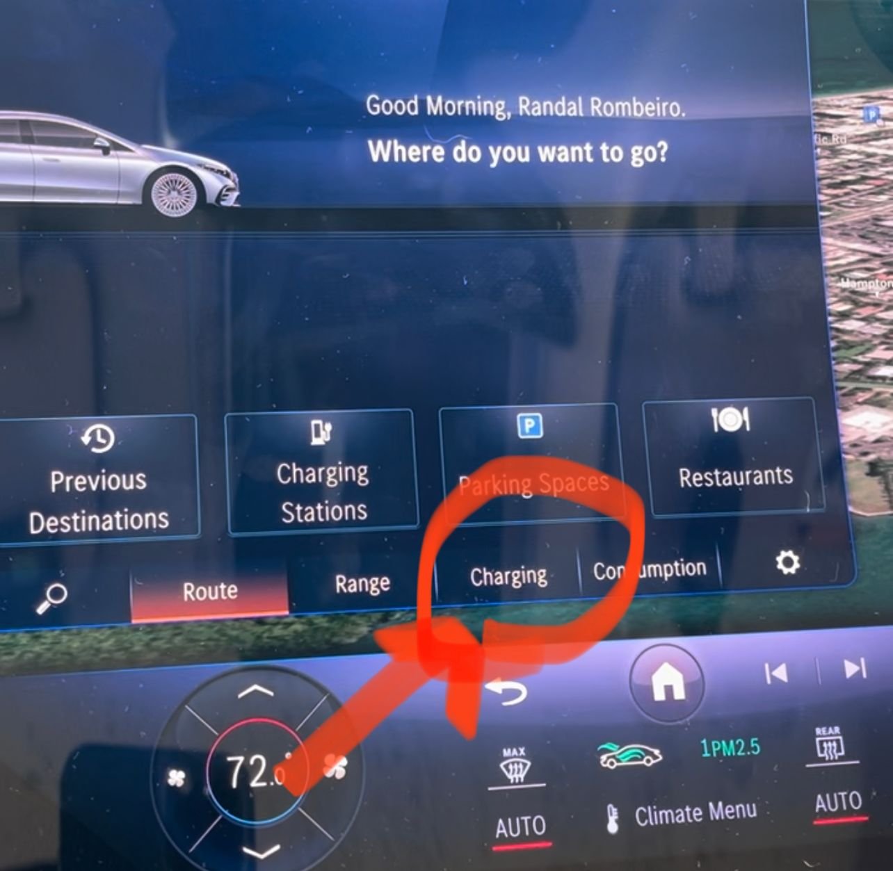

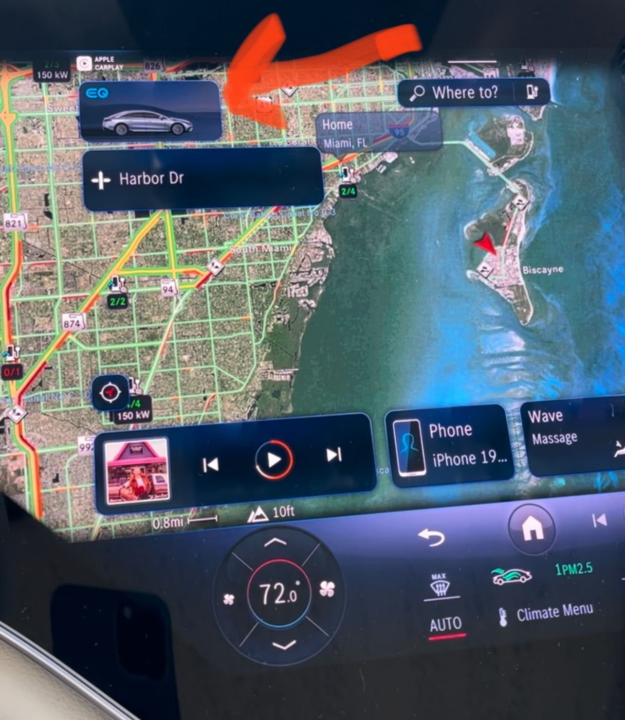

lyes you can precondition anytime you want. I made some photos for you showing how to do it.

the preconditioning does not happen automatically in my 2022 580 sedan. You have to manually activate the pre-conditioning (I posted a series of pics showing how to this elsewhere within this post. See message in this screenshot. I circled the applicable provision.

I own a 2022 EQS580 and I cannot view the information shown on your photos. When I touch the EQ symbol and then charging, the options you show are not there.

My 2023 580 SUV also does not have that screen. Mine only allows automatic pre-conditioning while driving towards a charging station if you choose that station on my route towards it.
