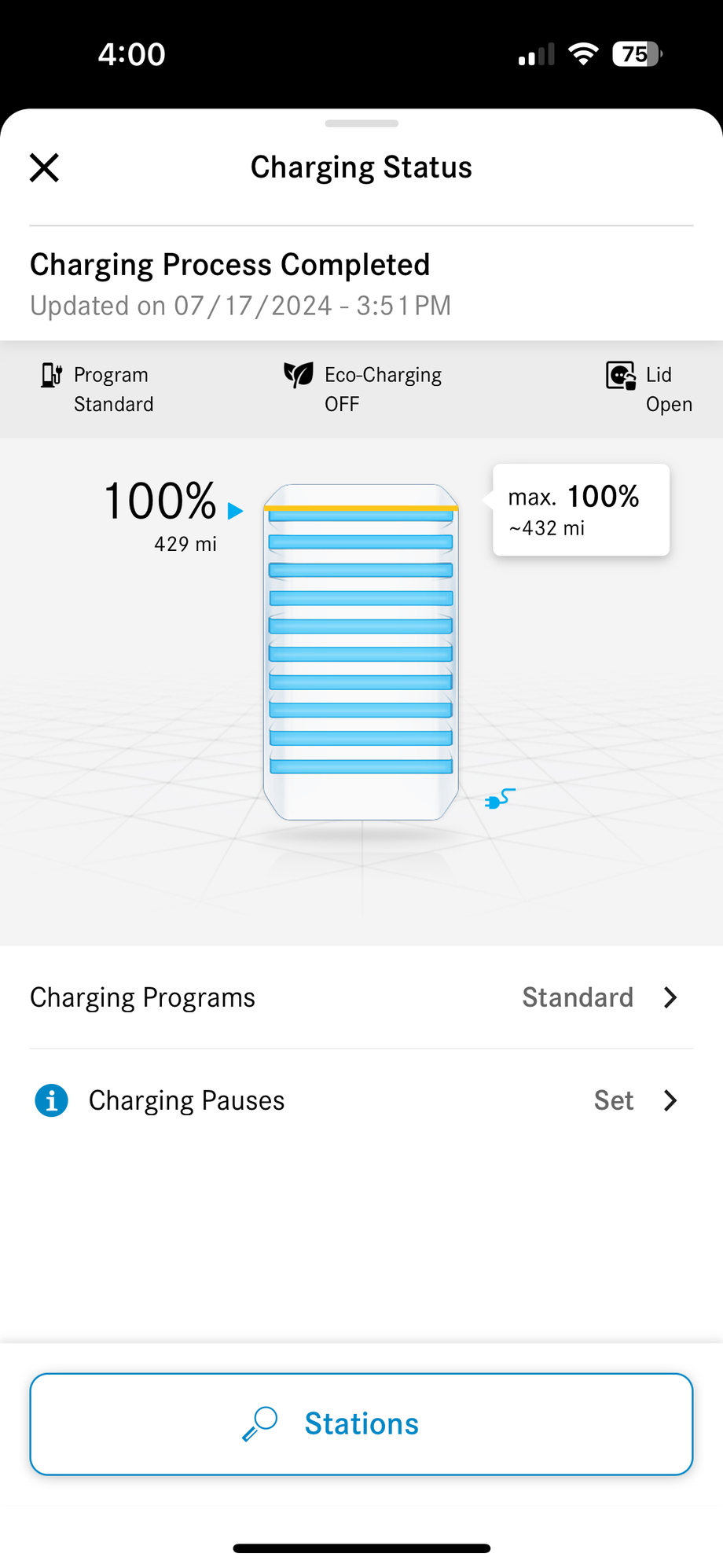

I have a 2022 Mercedes EQS450+. I used to get 416 miles at 100% charge; I have noticed the charge dropping to 308 miles at 100% charge when I am driving for at least 3 hours. This is an ongoing occurrence when I am driving long distances. I have brought this concern up with the dealership; not sure that they understand the problem. They indicated that they did software updates and road test and said the car is running according to specs. They also said that the range decreases based on the way the car is driven; I told them that I understand that and it’s not the range I am talking about but rather the battery capacity (to hold charge). This really is frustrating!

Just to be clear you used to get 416 miles and now get 308 miles going the same route, at the same speed, with the same wind conditions, same ambient temperature, same cabin temperature with the same tires inflated to the same level?
Sounds like the car’s range estimate is lower. No mention of what the car is actually achieving.
That is correct. Same route, same speed and same weather conditions, same ambient and cabin temperature, tires inflated per specs. See attached pictures.

So where you live the temperatures in October are the same as in July? You must live in Hawaii.
I live in Orange County, Southern California where whether is fairly consistent; it does not go in extremes.
Still not apples to apples. Need to show both with the battery topped up and same prior driving history.

Same prior driving history as @MBNUT1 said is also a key factor.
