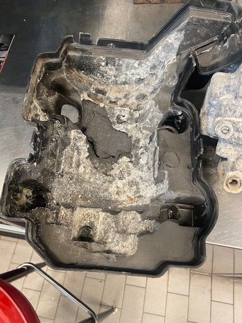

Compressor Corroded

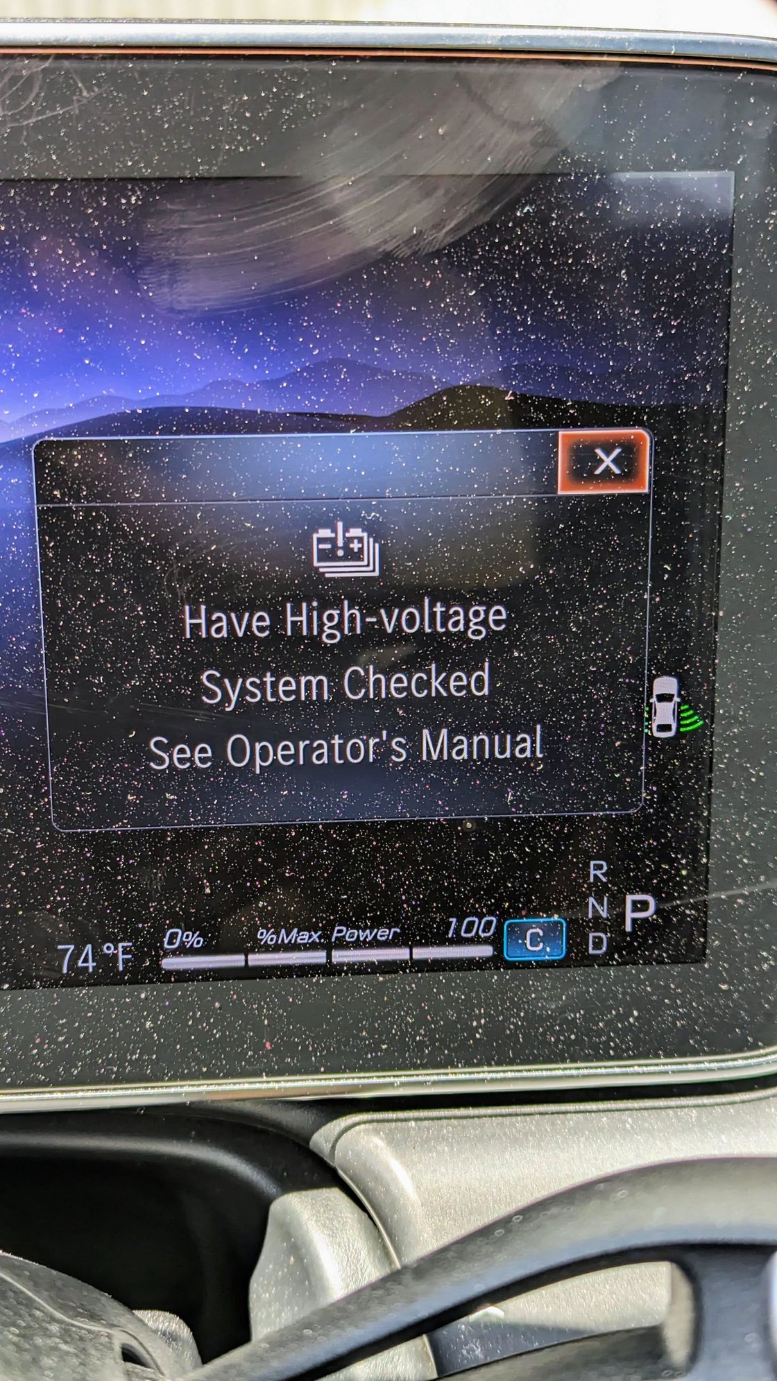

After 7 days of diagnostics, the dealer identified the A/C compressor as the cause of the messages. They ordered a new compressor but when they took out the old compressor, they saw it was totally corroded. EQS 450+, 18 months old. This took sometime to appear; maybe at time of delivery???
Compressor

That is nasty looking and no clue as to the source of the cause and no other components damaged?

Dealer claims that I must have gone into a flood or driven through water. I did not. Insurance adjuster coming on Thursday. The corrosion is so significant it makes me wonder when this occurred -- it was not recent. Could the A/C fluid been leaking over the past 18 months?

what was original problem?
I think I see a wet area in center, which makes think the Compressor let loose all the refrigerant & oil quickly.
Like maybe front shaft seal or a body seal?
todays refrigerants are somewhat nasty...
Now if they say you drove thru high water have them show you other things under car that show signs of rust?
should be plenty.
If only compressor, well then WHY?
because it failed and caused corrosion.
This should be easy one for you.
good luck

Thanks! I think you are correct but convincing MB of this might be a challenge. Original problem was this message on the dash. They eventually (after 7 days) diagnosed the problem as a short in the compressor.

It would be interesting to know if there is an error message that specifically calls attention to the A/C compressor. If not, then the general HV System Check message may be one of the default messages that is displayed when an unanticipated (by S/W engineers) error occurs. I wonder how much of the 7-day diagnostic period was due to lack of a trained EQ technician. If everything was not so concealed from the bottom and top of the vehicle the issue could have probably been identified in 30 minutes with a visual inspection.

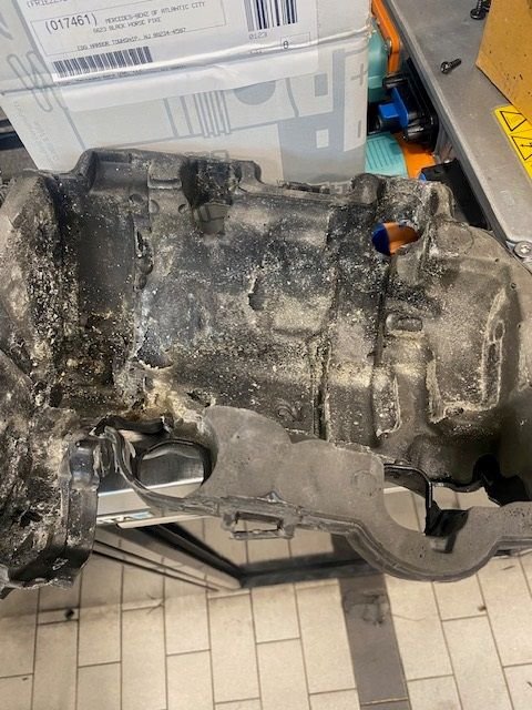

The compressor is surrounded by insulation (see below some more pixs) and only when they opened up the compressor to replace the damaged/shorted compressor did they see the damage.

That is utterly destroyed. If it were flood other things would be trashed too. Maybe wrong fluid? A galvanic issue like steel directly connected to aluminum?
Sure looks like galvanic to me. But I'm only used to seeing this type of thing on boats.

for galvanic that would have taken years, and this is an EQS so has to be relatively new.

Where is the compressor located? Is it relatively easy to access the areas where your photos show the corrosion on the connector covers? Is it simply a matter of lifting the rear seat bottoms?

The compressor is located in the front about 2-3 feet off the ground. As to the high voltage connectors, they are under the rear seat but it is not as simple as lifting off them rear seat. The dealer had every thing disassembled when we got there.

Wouldn't the steel bolts be rusty orange-brown if it was salt or galvanic action? Looks like it got wet to me too but my guess is that foam stuff contains a large amount of sulphur and/or chlorine that leached out and it acted like a sponge keeping the corrosion going for a long time after the rest of the car was dry. Might have even dripped sulphur/chlorine-infused water onto parts below it.
That's my guess for the betting pool. Put me in for $10.

Saltwater or caustic cleaning solution which saturated and was retained by the insulation.
This was user induced. Whether or not it is “normal” is a matter of opinion. The OP got out of the situation with a $50k depreciation write down and can start over with a new car.

Note the absence of corrosion on the connector area, which is the highest location of the compressor in vehicle position. This thing got wet, likely with bad stuff (salt or caustic) and stayed wet because the insulation got soaked.
