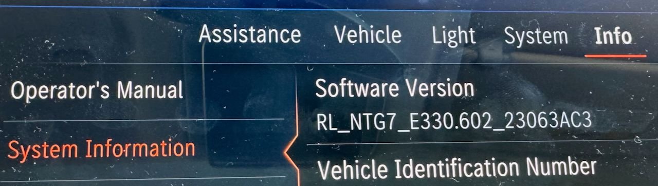

UPDATE: After a fourth trip back to the dealer, Mercedes had them install a new software update that solved the iPhone problem I was having. Although the "new" software update is actually an old software update. The trouble started when they updated the software to E445.001. When I got the car back yesterday the software was E330.602 (see photo.) Everything seems to be working now....so I'm happy.
This is my version after the latest update. Everything seems to work perfectly. You will notice a few updates to the screens and the charging options like turning off the battery preconditioning and how the radio favorites are displayed.
