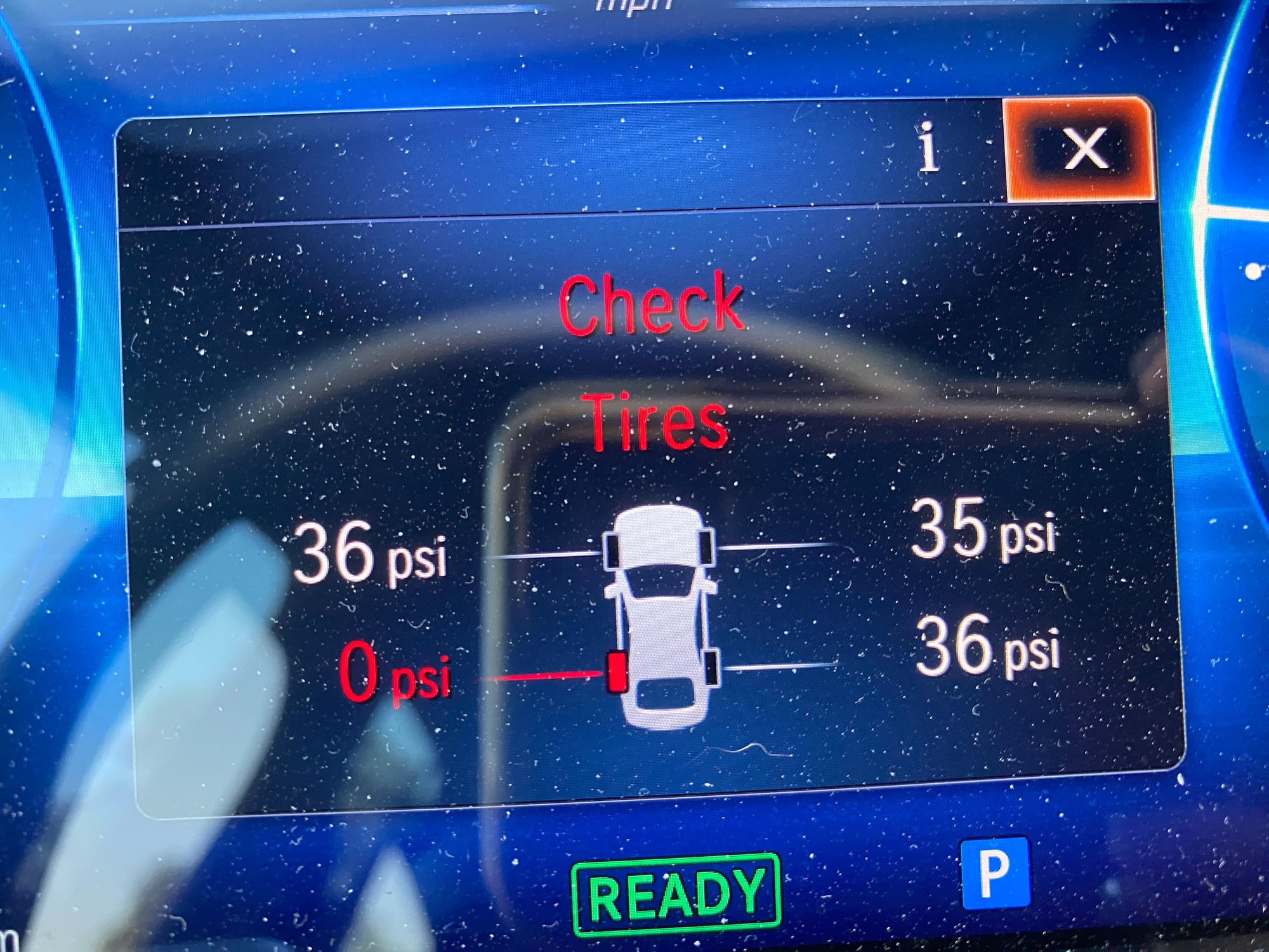

Is this issue user resettable or does this require a trip to the dealer? (tire has air).

If the tire always had air, then it may be a TPMS failure which would be a dealer visit. If a tire was repaired/replaced, driving for a few miles will reset the pressure reading.

OK, thanks!
