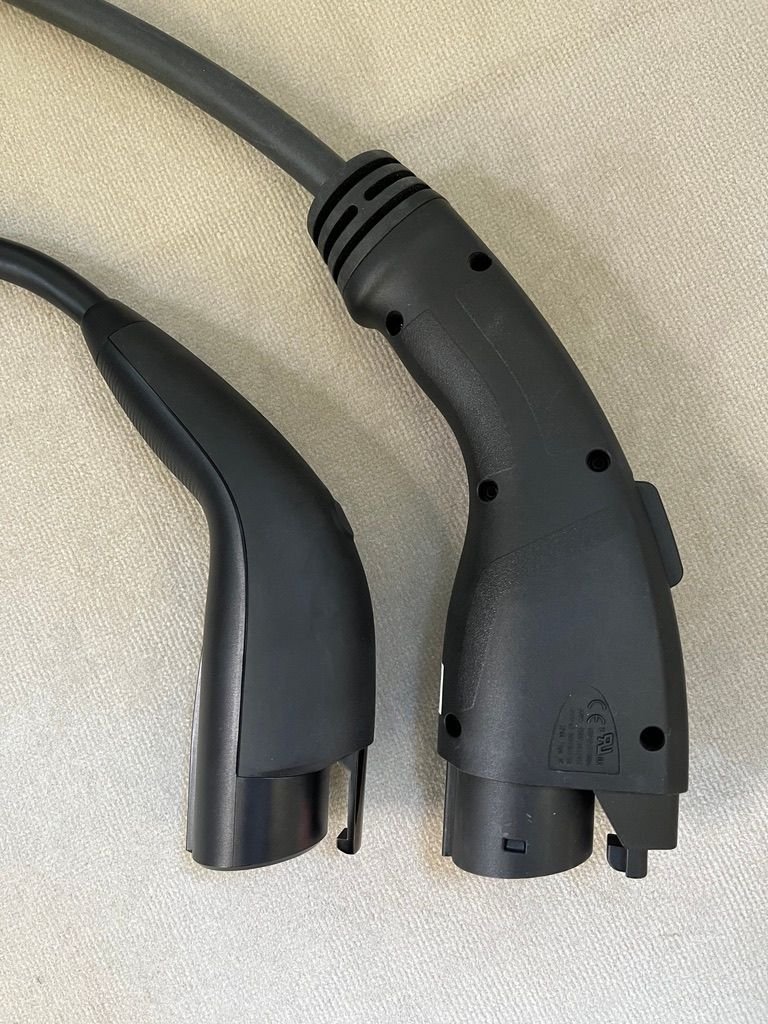

Tesla offered its Gen3 Wall Connector with a J1772 connector for a few months about two years ago. It sold for a small premium over the same unit with the standard Tesla connector. This EVSE has been superseded by the A/C Tesla Universal Wall Connector which like the Magic Dock Superchargers work with both Tesla and non-Tesla EVs. See link to this Universal EVSE in my post above.
Photo showing elegantly designed Tesla J1772 connector compared to typical larger J1772 connector.
Tesla J1772 on left.
Damn you reply fast. I also have a Tesla charger but it happens to be for the '24 S, so it would be the NACS connector. Is there anyway to preserve the existing wall mount for charging the EQS?
