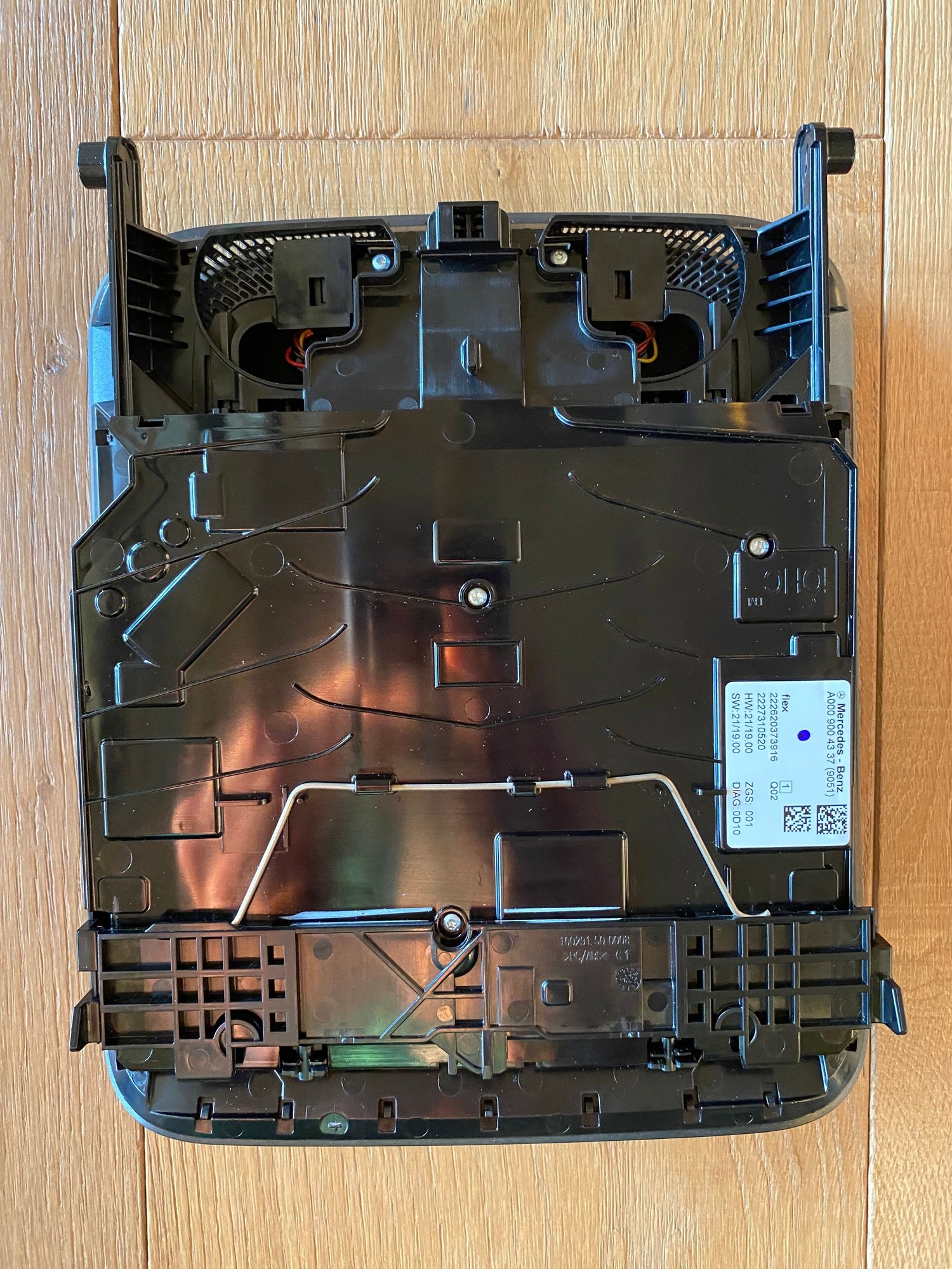

Answering my own question, in case anyone else has this issue....I was able to finally remove the overhead console. Surprisingly, Mercedes did not know how to do it, or at least the tech who worked on it. You take a thick credit card, and wedge it into the rear center of the console, between the headliner and console. Push really hard. That unlocks the spring mechanism you see in the photo below. It almost falls out of the ceiling once this is released. This seems to be the same setup as previous S class, so I'm surprised the tech did not know how it worked. Regarding the buzz/rattle, it is within the unit itself, and not anything obvious on the outside of the component. I tried taking it apart further, but could not--not meant to be taken apart. So, I'll go to see my SA today, and try to convince him that it needs to be replaced. The problem is that the sound is very subtle outside of the vehicle with the console sitting on my counter, but loud when driving as you can tell from my video.

I’m wondering if there’s any follow up to this issue. I have the same overhead console assembly in my 2025 E class (W214) and a similar rattle. Took it to the dealer and they installed some felt tape to increase the tension on the retention clips once reinstalled, but I think something inside is rattling, as you also guessed.
