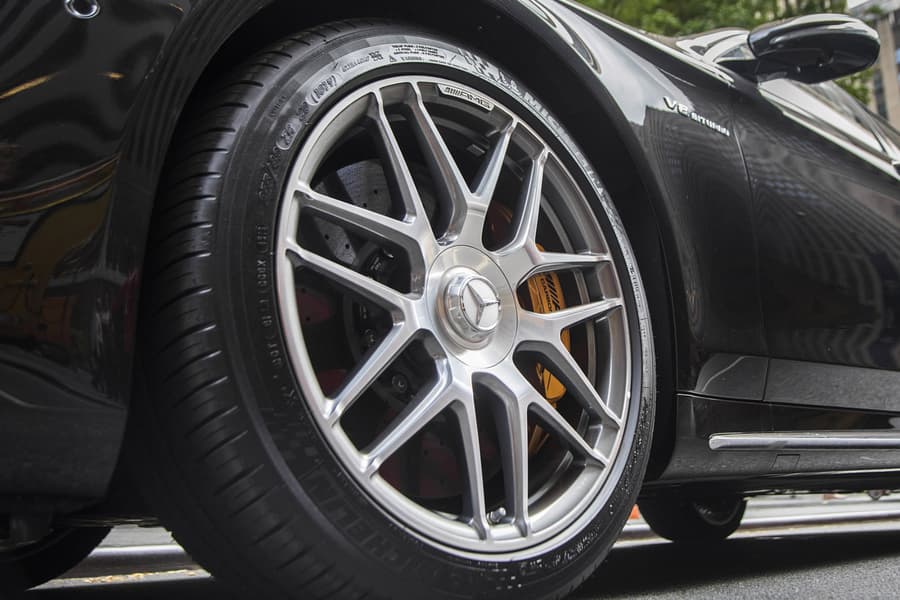

On top of being hard to clean. The tool is made of plastic and can break. That said, most MB forged AMG 63 S wheels used this fake centre lock design for a long time, nothing new.

Here is an example: https://mercteil.com/s3/s-63-amg-him...0163768122.jpg
To clarify previous post on the hard to clean part, mainly because of the spokes.
Guess the 45 S vehicles also have this design.
