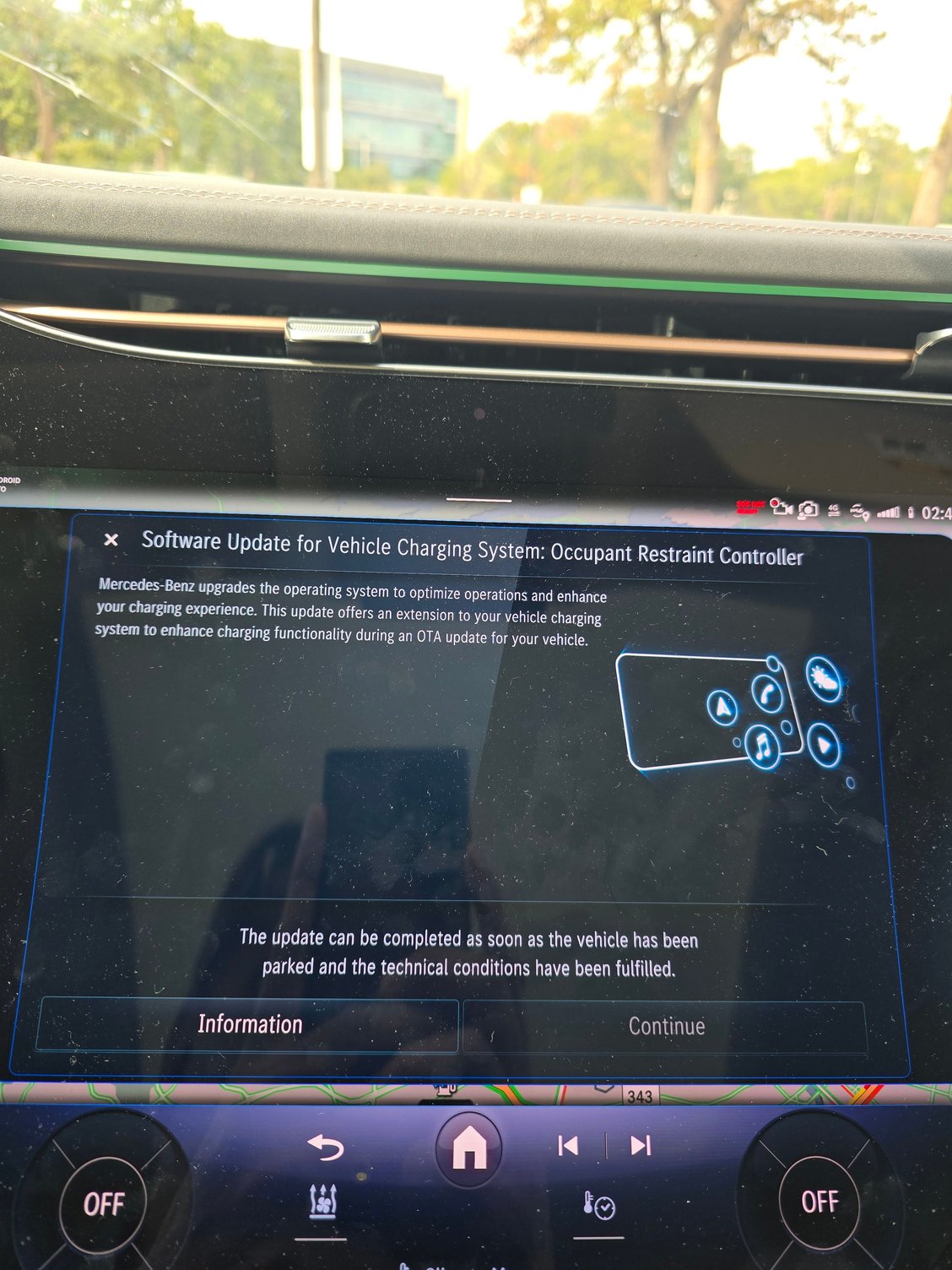

Anyone able to make the following software update install? Both my EQS and EQE have this update available, but when I try to install it, the continue button is always greyed out. I have plugged in and tried and charged to 100% and tried and no luck. Took it to the dealer and they said they cant install it, it will install when conditions are met????
Any get past this?

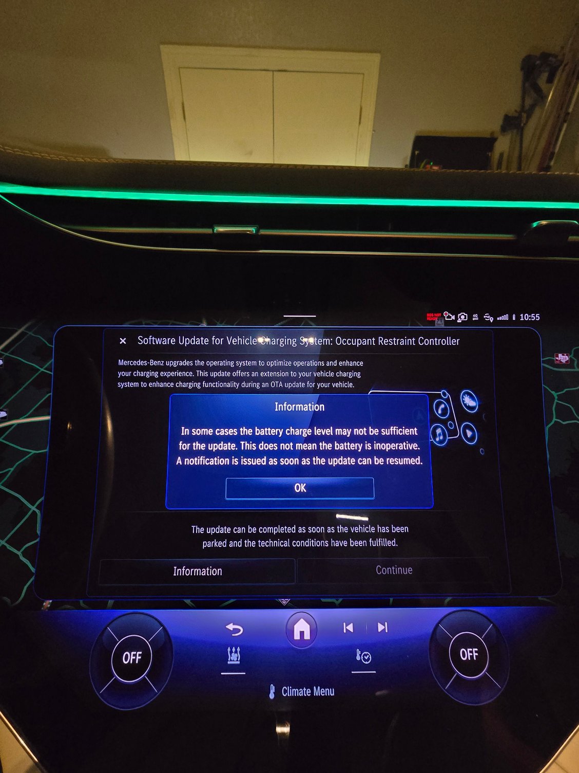

Press information it should list what conditions are not met.
When u press information, it just gives the following message which didnt make sense because I tried when the battery was 100% as well as charger plugged in.
I started playing around and when I hit the setting button on the software update tab, I realized my car was connected to my phone Hotspot which is usually off. I connected it to my home wifi and also setup to update automatically. After 1 day I got this installation failed message when I went back to the software update tab.
Then the software update disappeared from my list. I went to the app to see what happened, because there is an update history in the app, and I saw this.
Now I had taken it to the dealer while this update was pending due to disconnection problem with my android phone, and they updated software, but this update was still showing pending after I got the car back. But maybe they did some update that made this update no longer required??? No idea what is going on.
Going to try to connect my EQE also to my home wifi and see what happens with this update which is pending there also.
