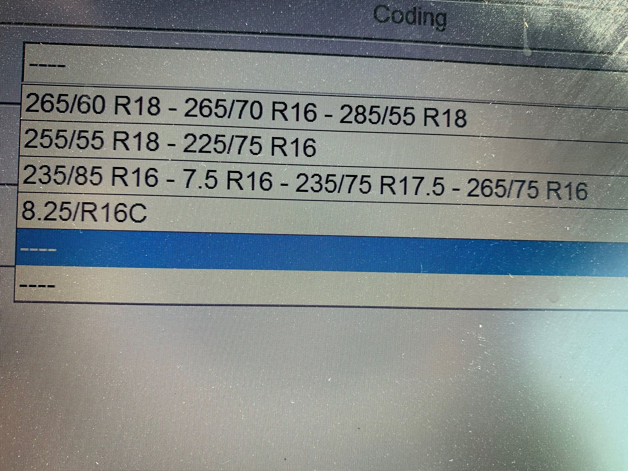

Hi,
Okay, I was able to get to the part of define the tire size and the axle ratio. But was not able to define tire size 35" as the system is limited to some specific small sizes, had no option to define 35" or 315/325 size
Any idea?
