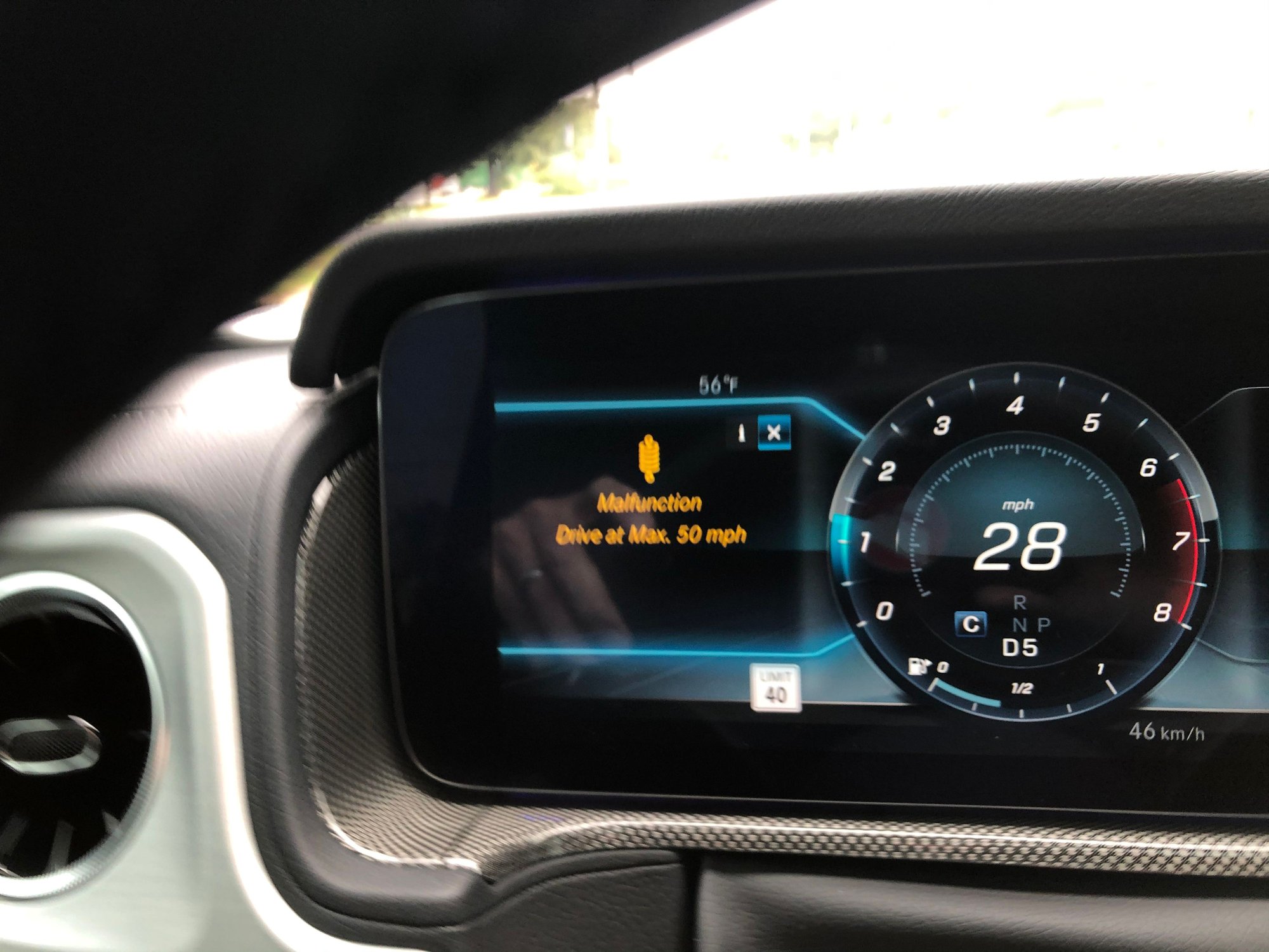

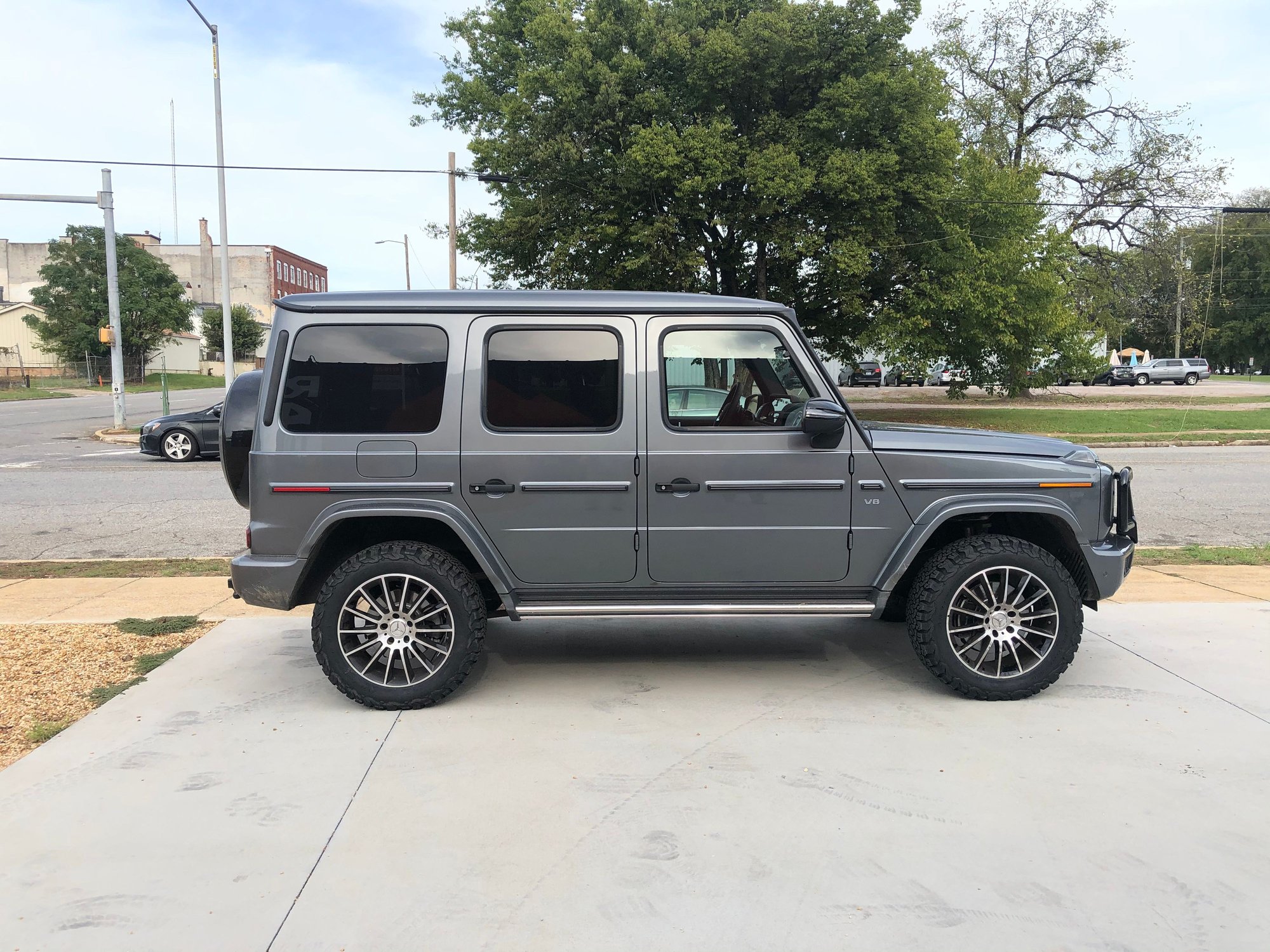

1.5” lift with BFG 275/55R20.
I lifted my g550 with a 40mm spring kit and now my adaptable suspension is screwed up. Warning light goes off ever time I start the vehicle and the suspension setting is constantly in sport mode. Any advise welcome.

How tall are those tires?

2019 G550
Looks amazing though! That approach angle is hot! I would love to do the same. Mine is being produced this week. Same color combo but with the all black AMG package wheels.
More pictures of your G please!
This is the very reason I skipped out on the adaptive suspension. Some lifts note “not compatible with adaptive suspension”.
Driving in sport mode isn’t necessarily a bad thing with that lift given the quicker rebound rates.
What spring kit did you use? Please let us know how the ride quality is!

Checking Connections for adaptive suspension
Originally Posted by will175
Check your connections bud. Had the same problem and it was just a plug.
I had the dealer check out the car and error codes for all four tires pop up. Not too impressed where those connections are located anyway. Southern mud is not that forgiving. I did not have all the cables replaced.
Does your G have adaptive suspension?

Tire Typo Correction
The tires are about 32” tall with 275/55R20. Any taller and I would have rubbing in a tight turn with a bounce. I did not want any rubbing. It would have bent the air vent fins in the wheel well.
