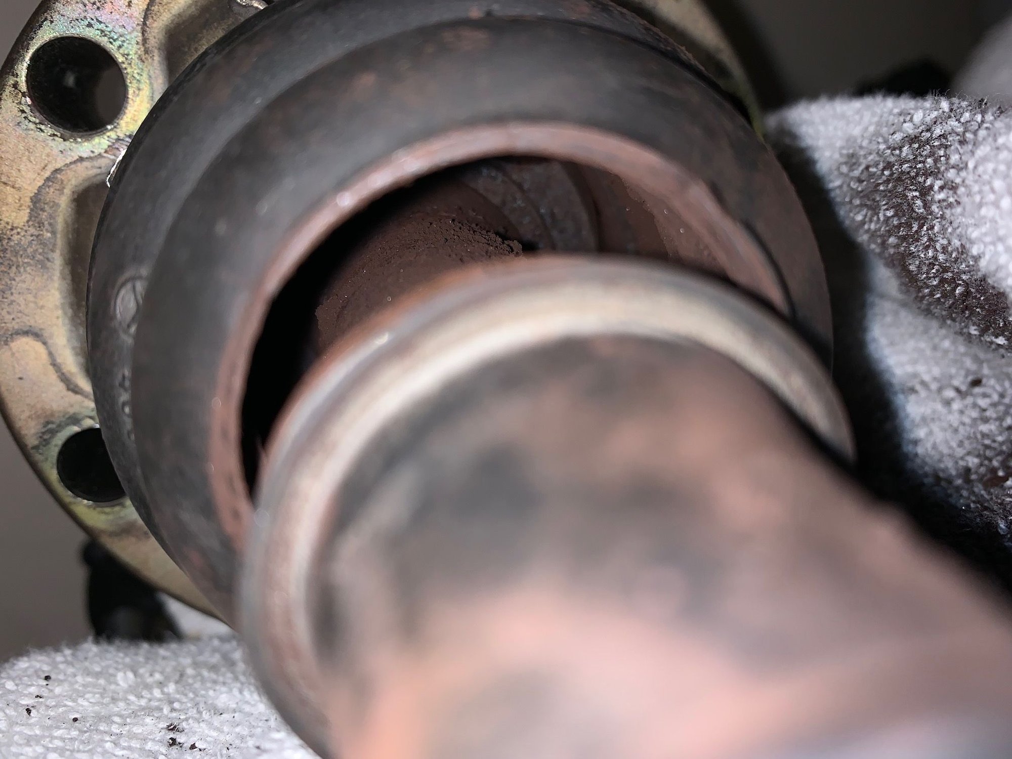

However, upon further diagnosing of the clunk and shuddering/vibration, I saw the that the propeller shaft boot was torn and there was lateral play in the prop shaft (between transmission and transfercase).
Below are pictures. I removed the car with the G on the ground and it wasn't that hard to do. Power tools would have made it much easier. It took a little bit of work to wiggle it out.
I am looking for a replacement or seeing if a local shop can rebuild it...

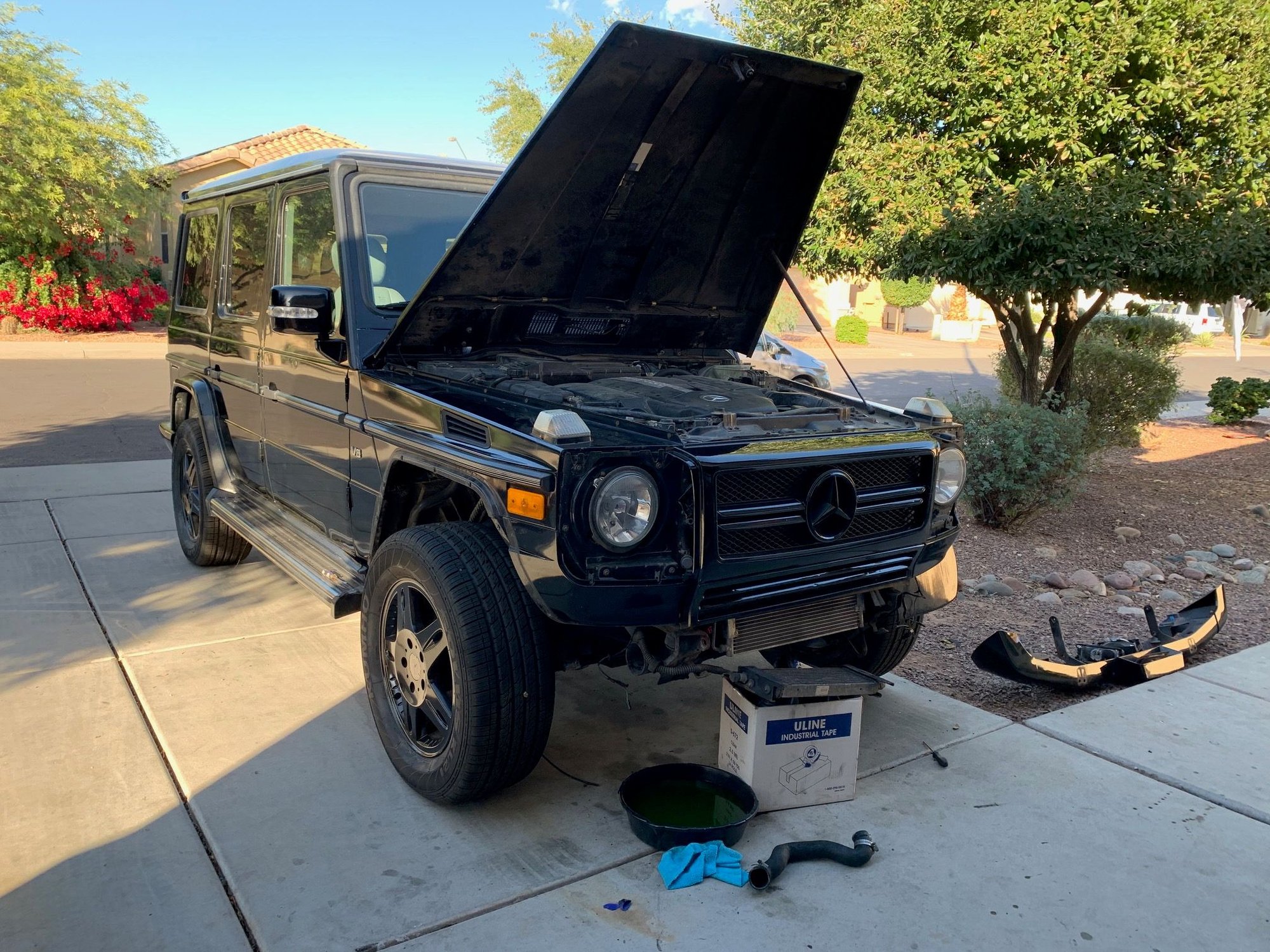

Here are pictures of the facelift I did!
I changed out the diff/transfer case fluids, replaced the cooling hoses, PDR on the dings, repaired some rust, and flushed the coolant out so far. Overall the truck is solid. Replacing the stereo with a double din pioneer unit. LCD screen on the instrument cluster is going out and will be replacing that soon.
It saves a ton of money being able to do all of this myself. I can't imagine spending dealer prices on these items.

Had a local shop rebuild the prop shaft with new joints and boots, installed it and it drives like new. No clunk or noises. Wow. Only 325$ to rebuild the shaft. Installation took 2 hours.
