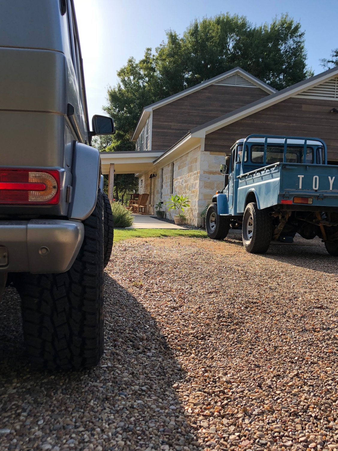

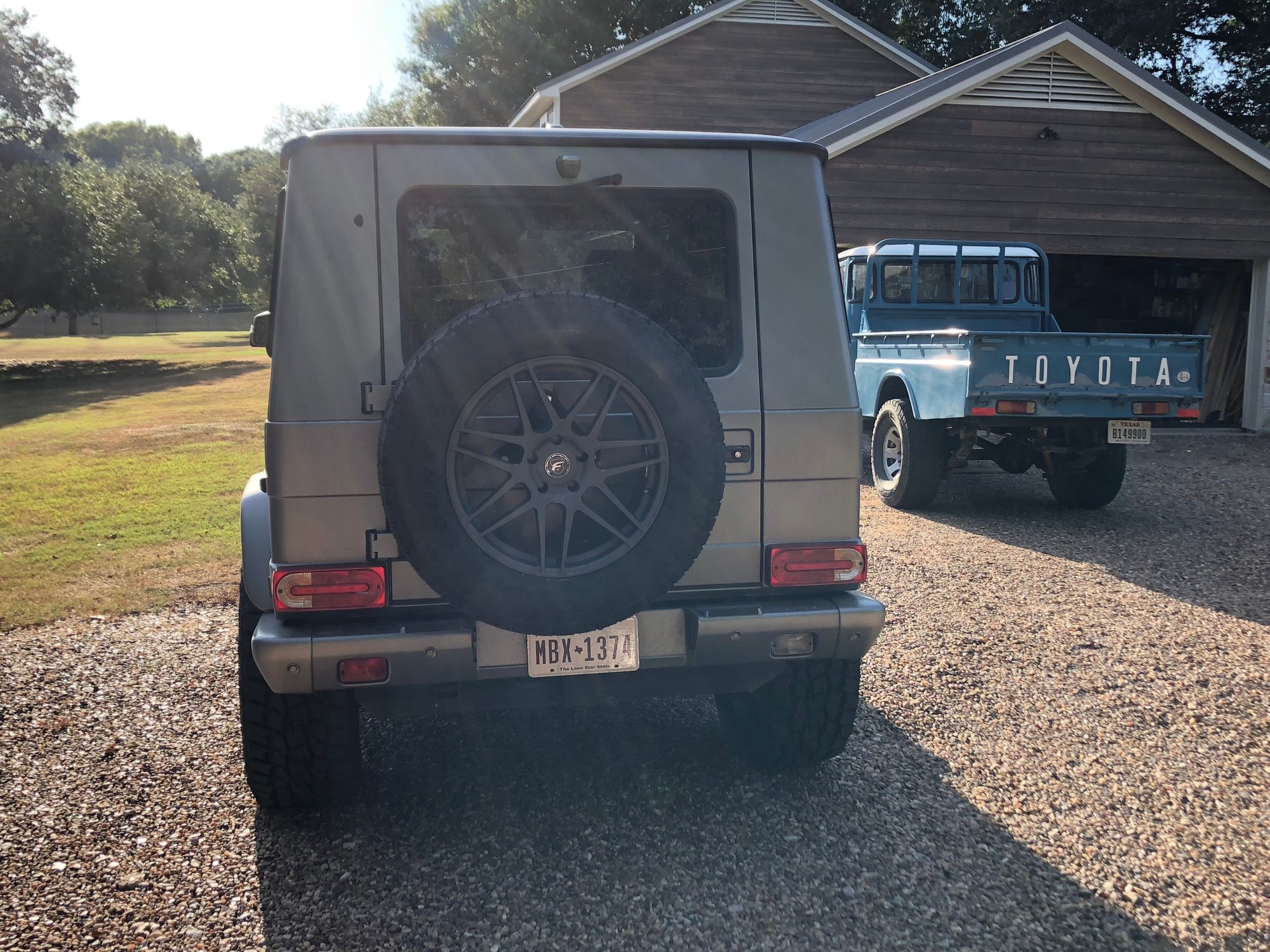

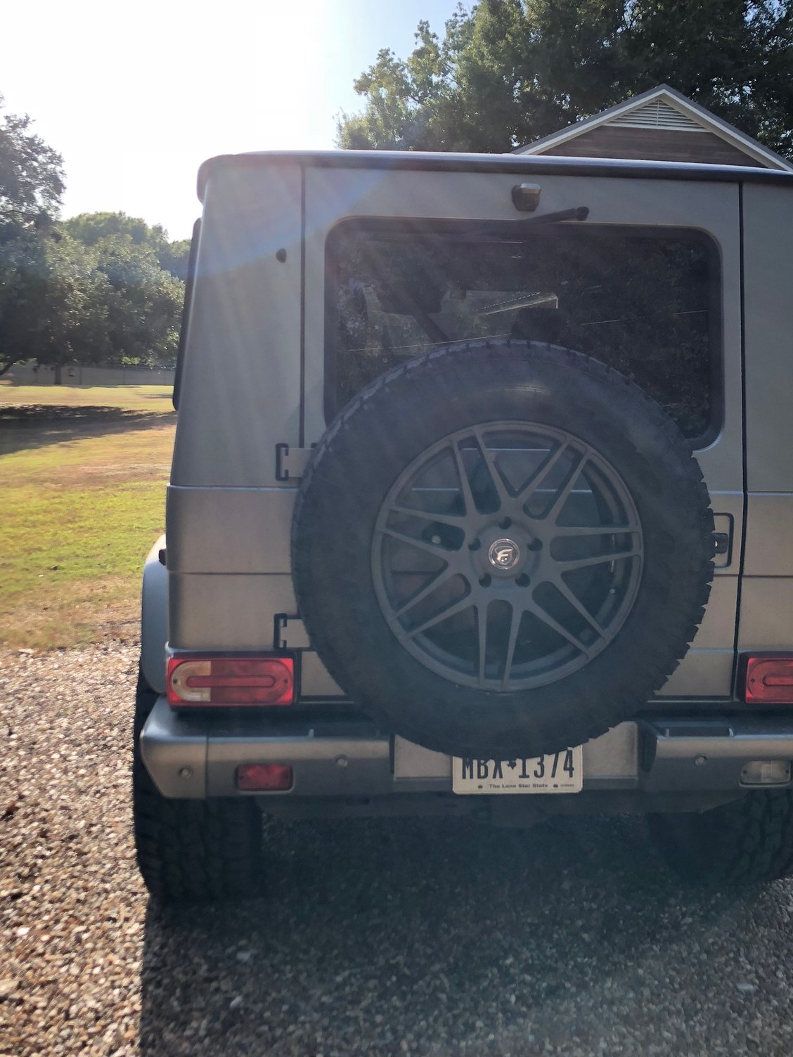

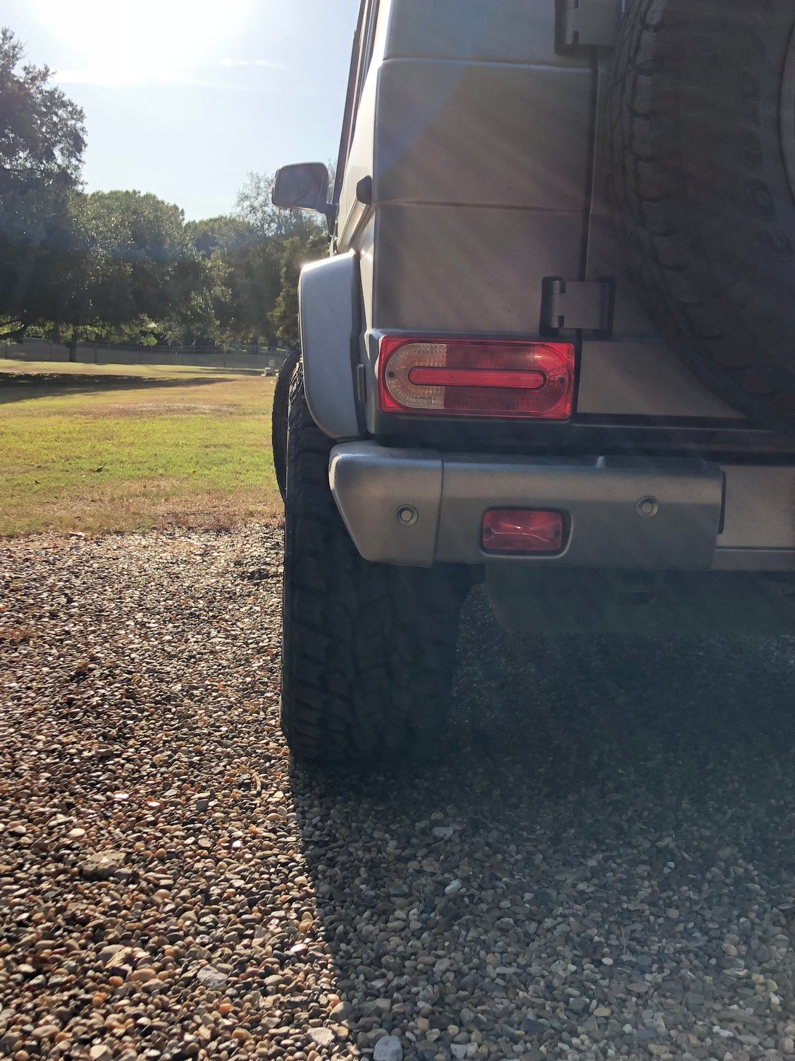

I'm running 20x10.5 Et 20 w/ 305's...... on a G63 so not sure if the flares are the same.... it's perfect imho

Those looks great and very flush.

the rims had custom offset to remove need for spacers..... saves a ton of unsprung weight, 18lbs roughly - and then the rims are 7 lbs lighter each over OEM - more then offseting the larger/wider tires extra weight.
