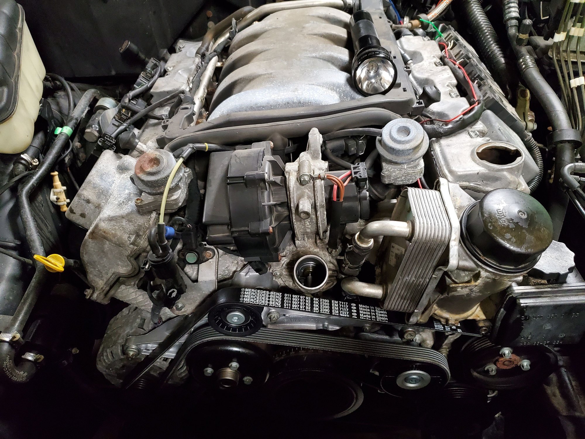

It's plumbed to the oil cooler. One line goes to the thermostat housing, the other to the water pump. Mine is almost back together. I used factory parts for everything except the fan clutch​​​​. The clutch will be here tomorrow so hopefully I'll have time to finish by the weekend.
Thanks for the pictures 👍🏼
Now I’m wondering why my (and some other m113 engines) don’t have that oil cooler? I’m wondering if I should buy one and plumb it in?
