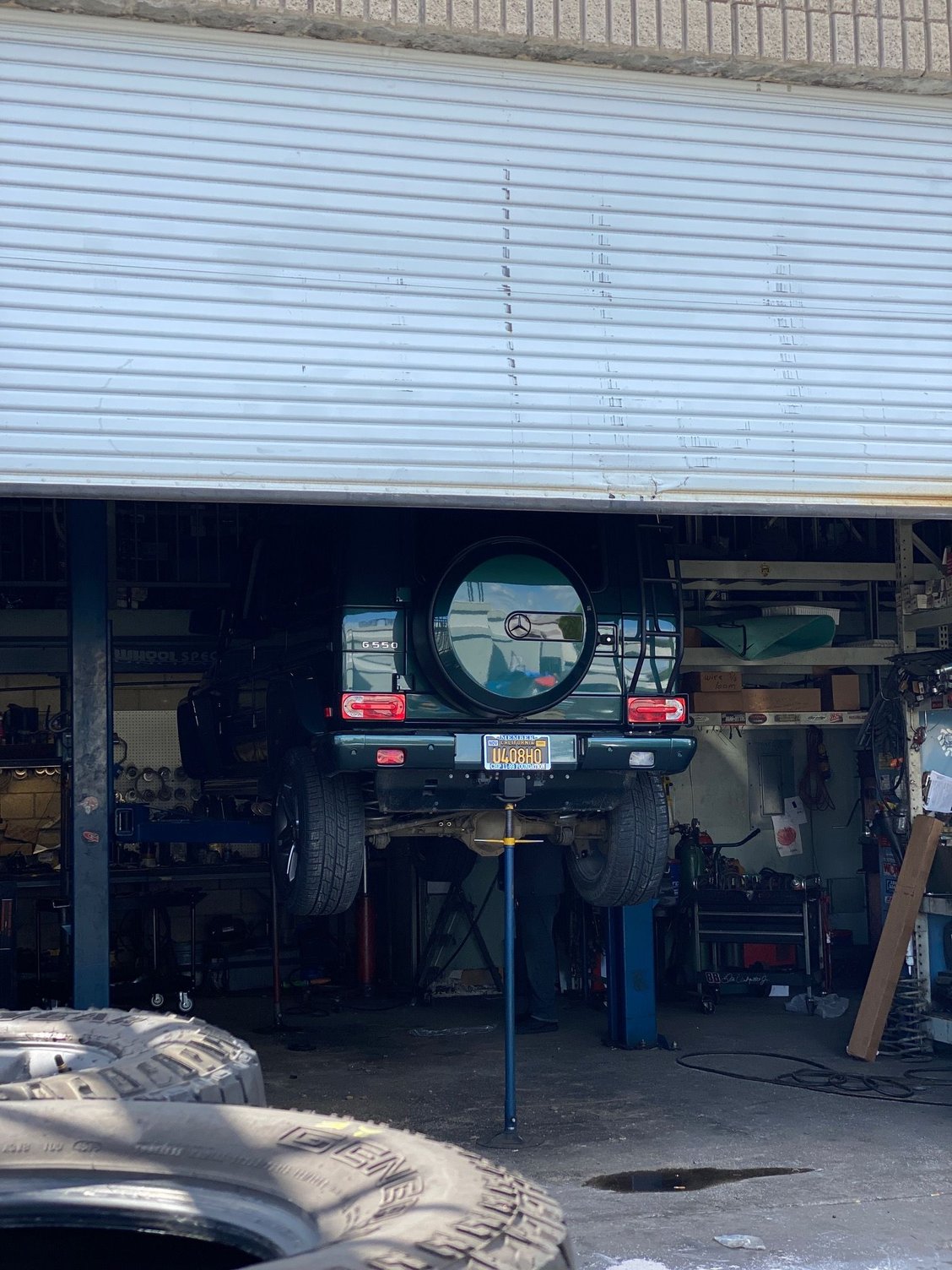

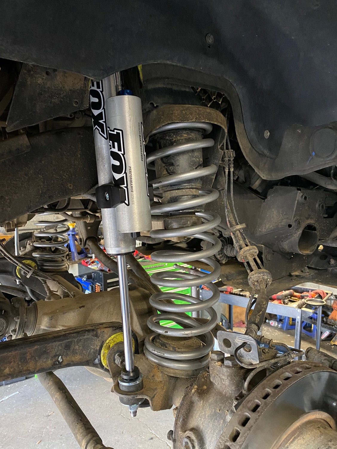

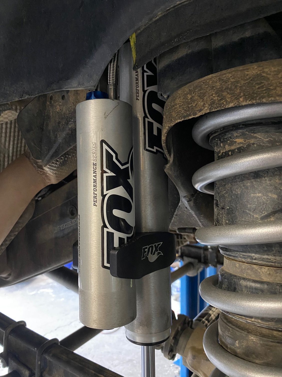

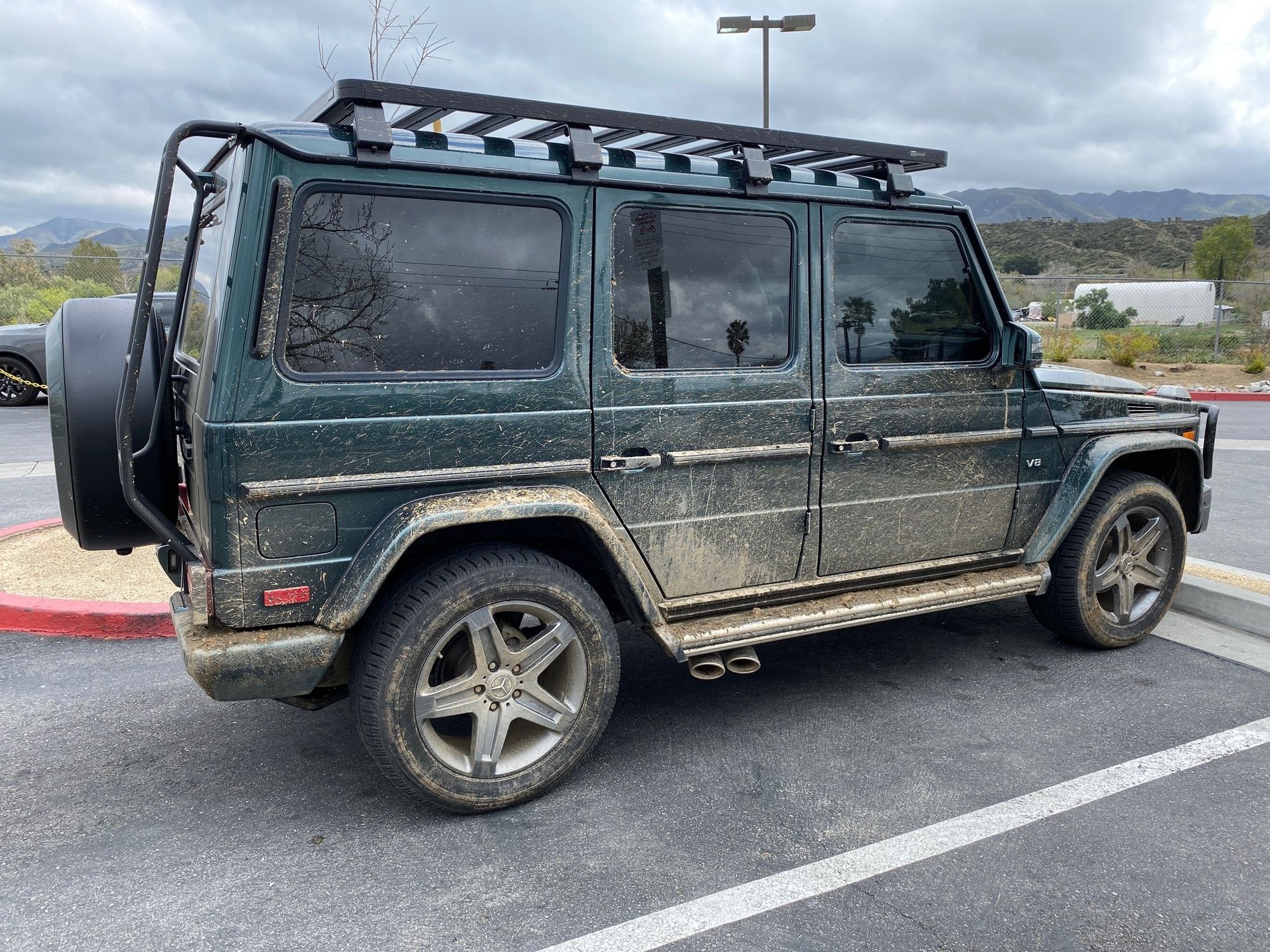

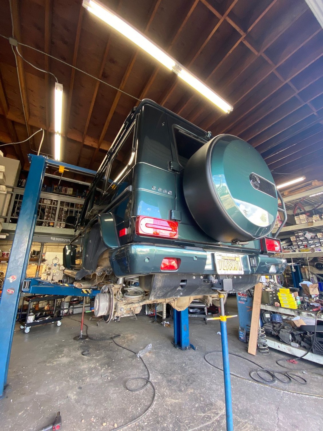

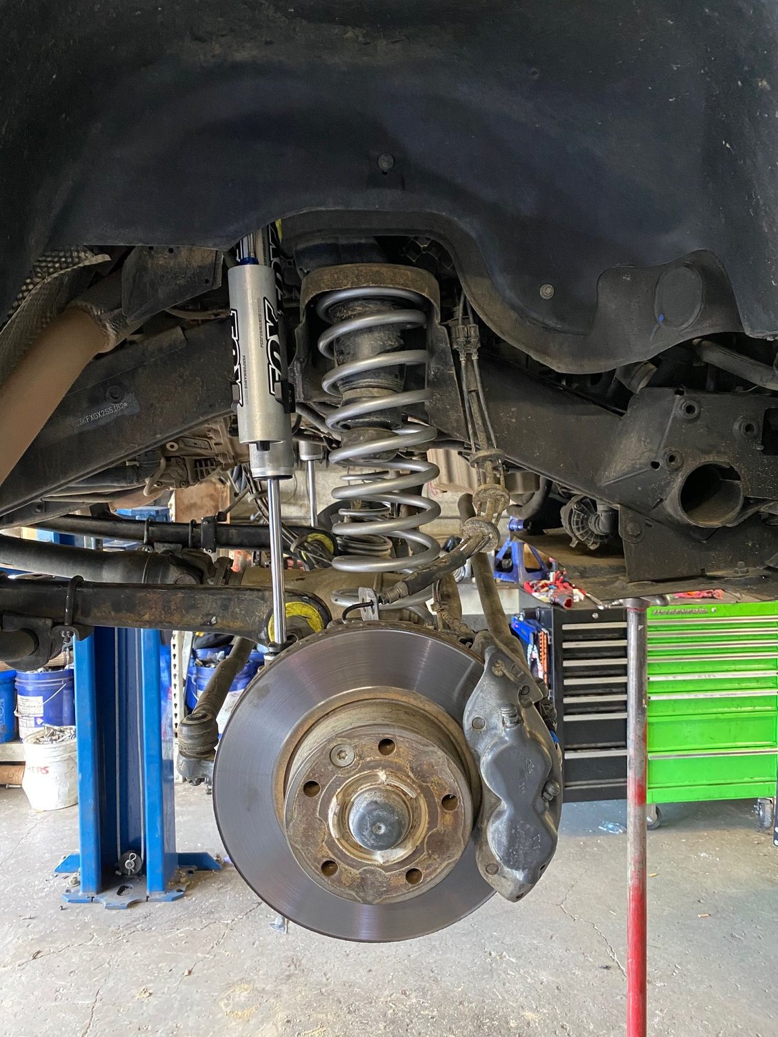

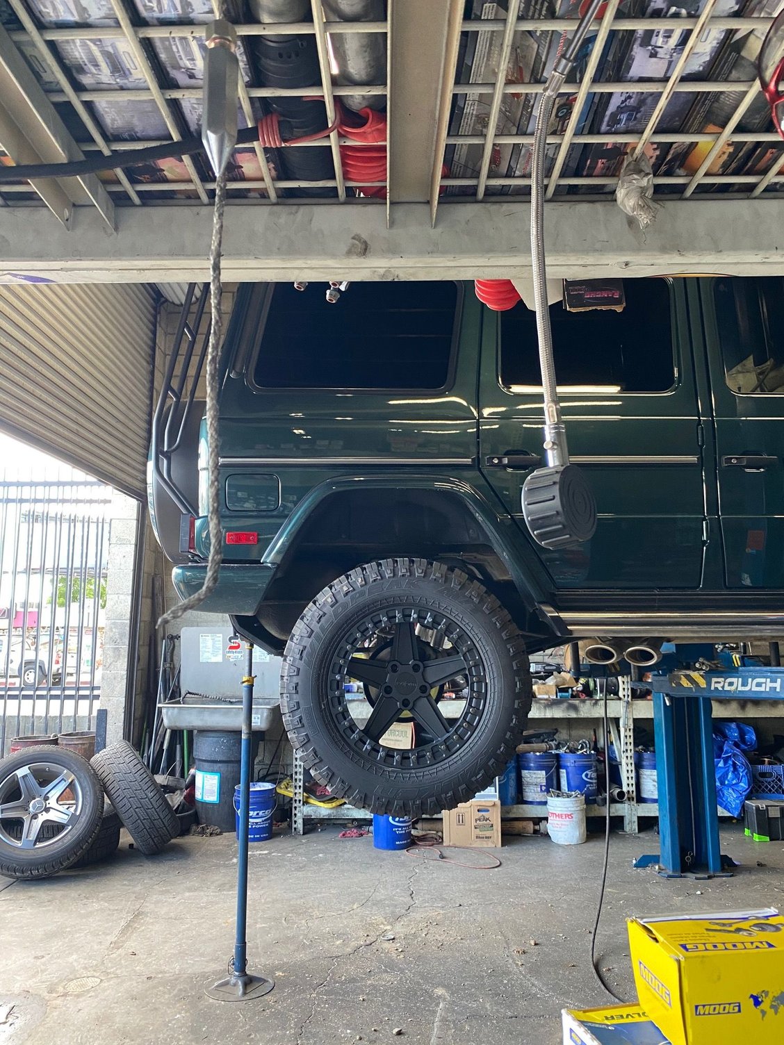

2016 G550.
AFTER DOING SOME RESEARCH ON HERE I DECIDED TO GO WITH THE FOX SHOCKS AND THOR SPRINGS SET-UP A COUPLE PPL ON HERE RAN SUCCESSFULLY AND SEEMED TO REALLY LOVE. I COULDN'T BE HAPPIER WITH HOW THE RIG TURNED OUT. IT NOT ONLY LOOKS INCREDIBLE BUT THE RIDE IS SIGNIFICANTLY IMPROVED. IT'S DEFINITELY LESS STABLE AT HIGH SPEEDS BUT THAT'S NOT WHAT THIS TRUCK WAS BUILT TO DO SO I'M GOOD WITH THAT.
FOX SHOCKS
THOR SPRINGS
FOX STEERING STABILIZER
CASTER CORRECTION OFFSET BUSHING KIT
ROTIFORM PNT BEADLOCK 20" WHEELS
FALKEN WILDPEAK M/T 35" x 12.5" TIRES
INSTALLED AT:
4 WHEEL SPECIALTIES UNLIMITED IN NORTH HILLS
BEFORE LIFT AND RIMS:
FRONT
FRONT
FRONT
REAR
STEERING STABILIZER
AFTER LIFT & RIMS:

With the lift and the rack, what's your height looking like? I only ask because when I had Jerry Cans on my lifted LR I couldn't get into any garage less than 7 and a half feet.

Thank you! Just went out and measured and from the ground to the top of the rack I'm rich at 7ft 1" or 85in. total. So I'd need at least a 7.5" height to clear comfortably..

I lifted just about 3”
amswered this in OP, “ IT NOT ONLY LOOKS INCREDIBLE BUT THE RIDE IS SIGNIFICANTLY IMPROVED. IT'S DEFINITELY LESS STABLE AT HIGH SPEEDS BUT THAT'S NOT WHAT THIS TRUCK WAS BUILT TO DO SO I'M GOOD WITH THAT.“
Yes, def feels heavier and slower off the line... Benzworks going to tune it for me to add some HP & TQ

Nicely done! Did the same setup with mine, the Thor springs lift the front right around 70mm, while the rear is lifted 50mm (it's supposed to level out the truck as well). I have my Fox shocks set at 3 clicks in from fully soft, since anything less than that and I get some rocking back-and-forth motion when I come to a stop at a red light. Ride is smooth on road, and offroad it's been good as well. The Thor springs are on the softer side of the scale, so the only downside is if you load up for overlanding or extended travelling you may find the rear gets compressed too much with the weight. But I'm very happy with this setup as well! (Although I ended up adding spring spacers to the rear also).
