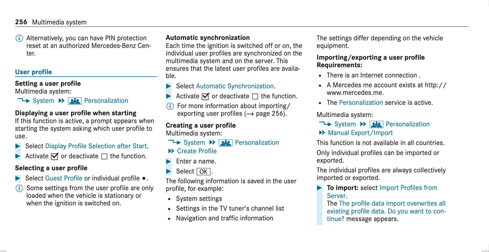

If there are multiple drivers for the 2019-20 G class, it looks like under System Settings one can make multiple driver profiles to save ambient lighting color, etc. Does anyone know if the same system settings allow one to make it so that when the vehicle starts, you choose the driver profile? Or do you have to go into the System Settings every time to switch driver/user profiles?

You can manually choose the driver’s profile

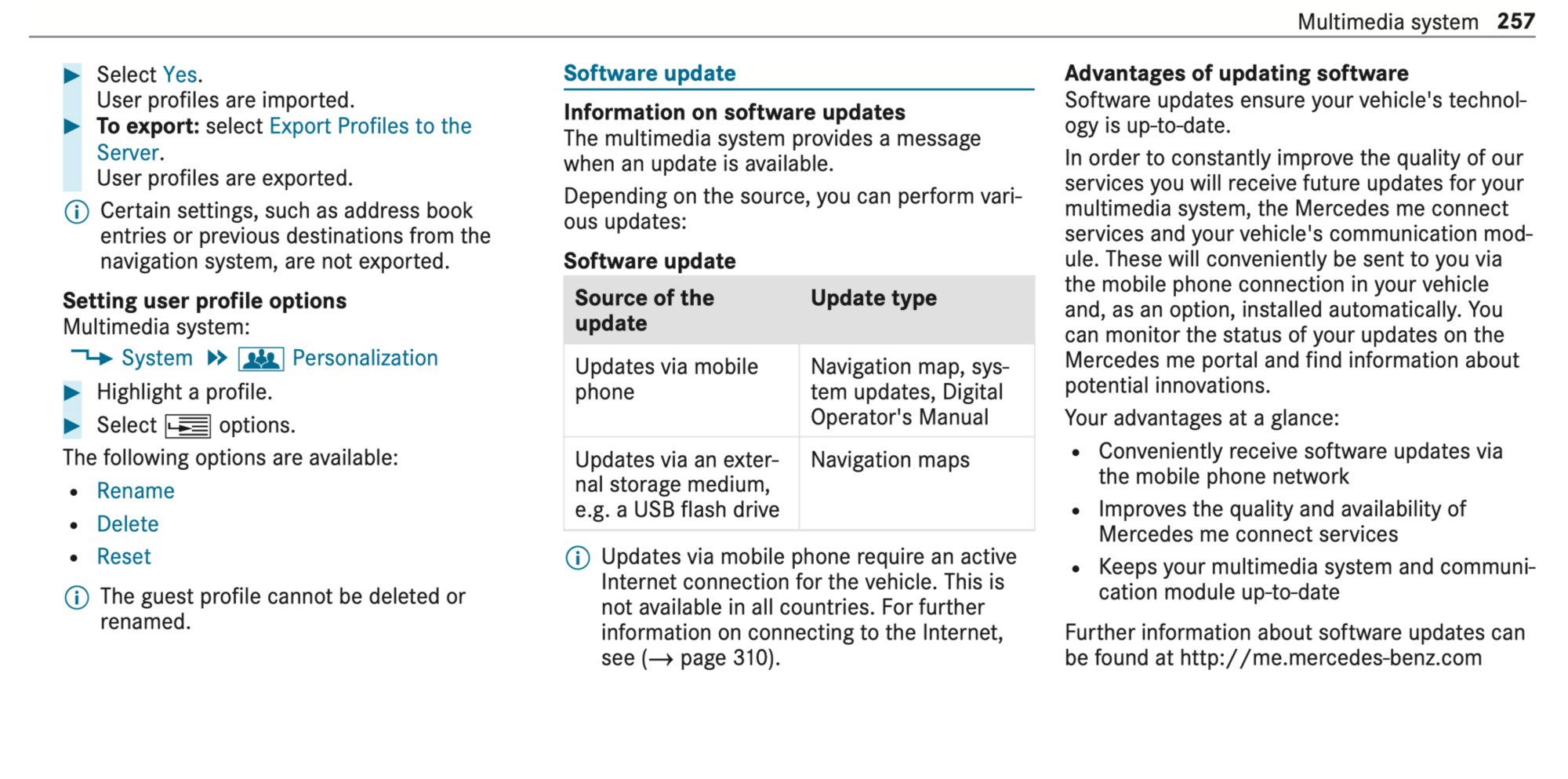

Is this it?
