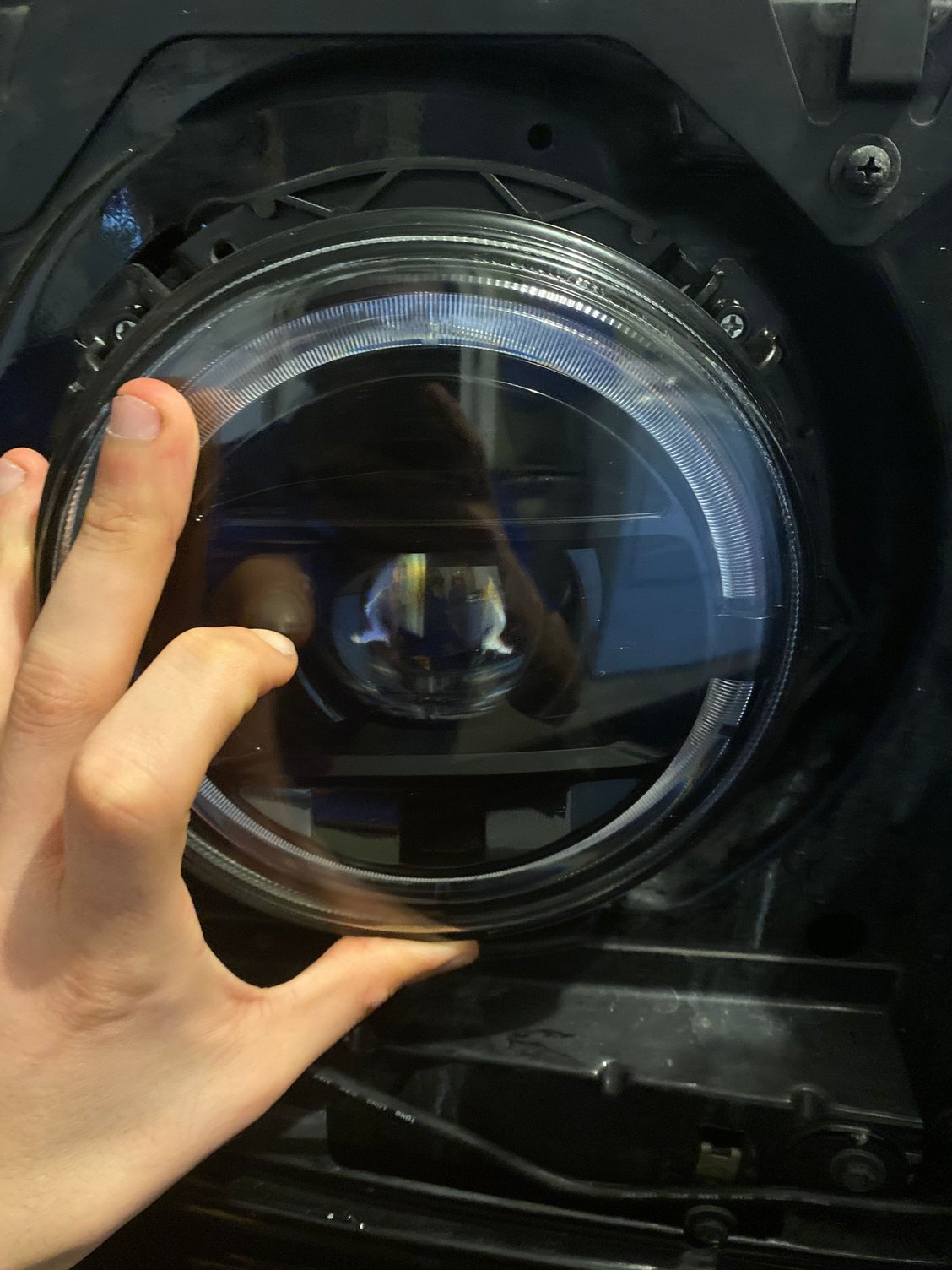

I bought new headlight for my 2003 benz g55 and I’m very happy to have them. But there is problem. I did install them and working fine but headlight is upside down. Low bean is pointing high and high beam pointing low. I did try to turn them but now i cant bolt them down. Im really frustrated bc cant figure it out.
please someone out there help me. Those are pretty expensive headlight and dont want to break them.

Is the headlight physically upside down, or do you just have the Hi-beam connector on the lo-beam and vice versa?

which headlights did you purchase? pictures would help a ton.

I finally found the issue. The company that sent me out the headlights did assemble them together wrong. They had projector inside of headlight upside down. I spend almost 2 days to figure this out. Finally they made decision to send me brand new pair. I really appreciate their help. Also the pair I bought were OEM look of w464 headlight with 6000k LED bulb. They are sweet and amazing pair. All the G wagon owners must try them. By the way I’m
Still in progress. I will update soon.
still new in here and don’t know how to use the web.
Thanks,
Noel
