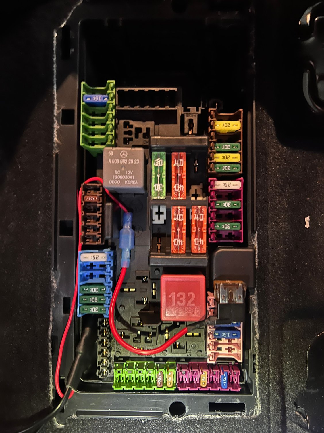

thanks for sharing the installation, it is really hard to find a procedure for the G Wagon. However, I just wondering should be the fuse tap plug in other way around since on the fuse tap the far end leg is +12 V? What I tested was the bottom of the fuse slot in the fuse box is +12V

The correct orientation depends on how the fuse block is wired, but your notated pic is correct.

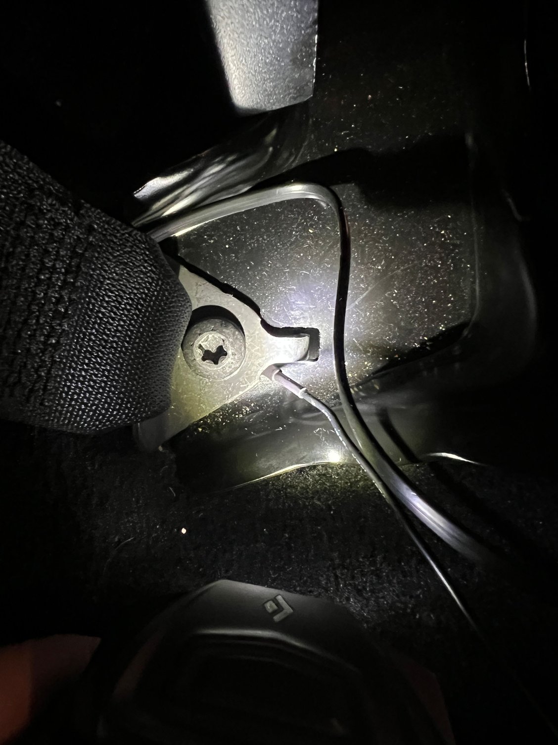

Now, the harness came in but the ground wire was only about 8-10" long so there was no way I could get it to the official grounding point in the front fusebox. The ground wire is an 18 gauge so I was planning to extend the wire and run it back to the front box. Since I have not extended a wire in a vehicle before and even though it isn't exactly rocket science, I decided to test if any of the bolts in the second row could work as a ground. Lo and behold I found a strong one in the bolt that secures the seat belt to the vehicle. The other bolts were not solid enough of a ground to work, this was the only one that was reliable. I removed it, saw it went into the unpainted portions of the body/frame so that was positive. The ground wire from the harness was able to stretch to it while keeping the wiring harness fuse inside the fusebox.
So I tapped the same fuse as many have used above. modified the grounds spade (cut it a bit and then widened it to fit around the large bolt) slid it under the metal bracket and around the bolt and tightened it hard (it is a seatbelt bolt so you have to ensure it is VERY tight). From there I ran the single cable straight up behind the hard plastic molding to the side of the seat and then over to the door weather seal. That hides the cord perfectly and ran it along the ceiling, tucked between the headlining and the front passenger seatbelt panel, back into the front passenger door weather stripping, over to the top of the A-pillar and into the roof lining at the windshield.

Here is a pic of the bolt I used for the ground. Hope this helps anyone else who is looking to only install a radar detector and does not want to go through extending wires or tapping into the front fuse box.

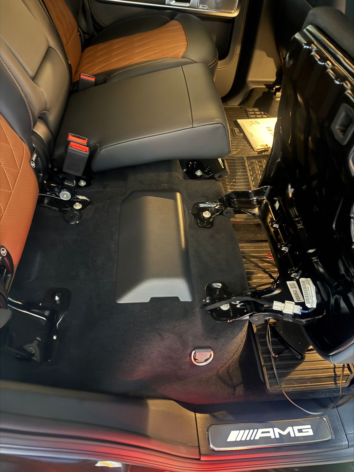

did you happen to take any photos of how you ran the wire from the rear compartment to the front?

Originally Posted by Theothrknd;[url=tel:8164993
8164993[/url]]Getting the wire under the carpet was easy. I simply removed that tie down on the floor under the seat, cut my wire and fed it from the fuse box to the hole left by the removed tie-down and then was able to push it down to the sill area where I pulled up on the carpet enough to grab the wire coming down. Spliced the wire back together and I was done.
what tie down are you referencing?
