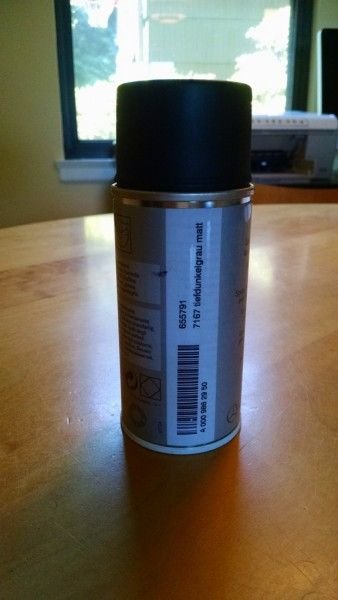

The gutter trim is aluminum as mentioned, The small clips joining the different sections are steel.
Parts painted this color are single stage paint with no clear coat, so are subject to degradation, but not as quick as this, as far as I have seen. This color was the bumper and trim paint on 460 and early 463 before 2000 as well.
The color is MB7157 Teifdunkelgrau, it is available in spray cans from the dealer A000-986-29-50-7167.
