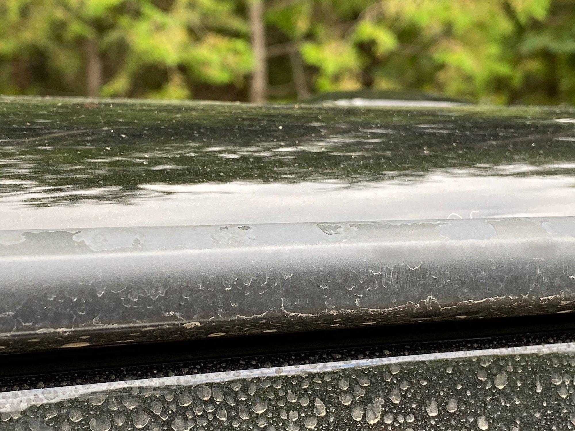

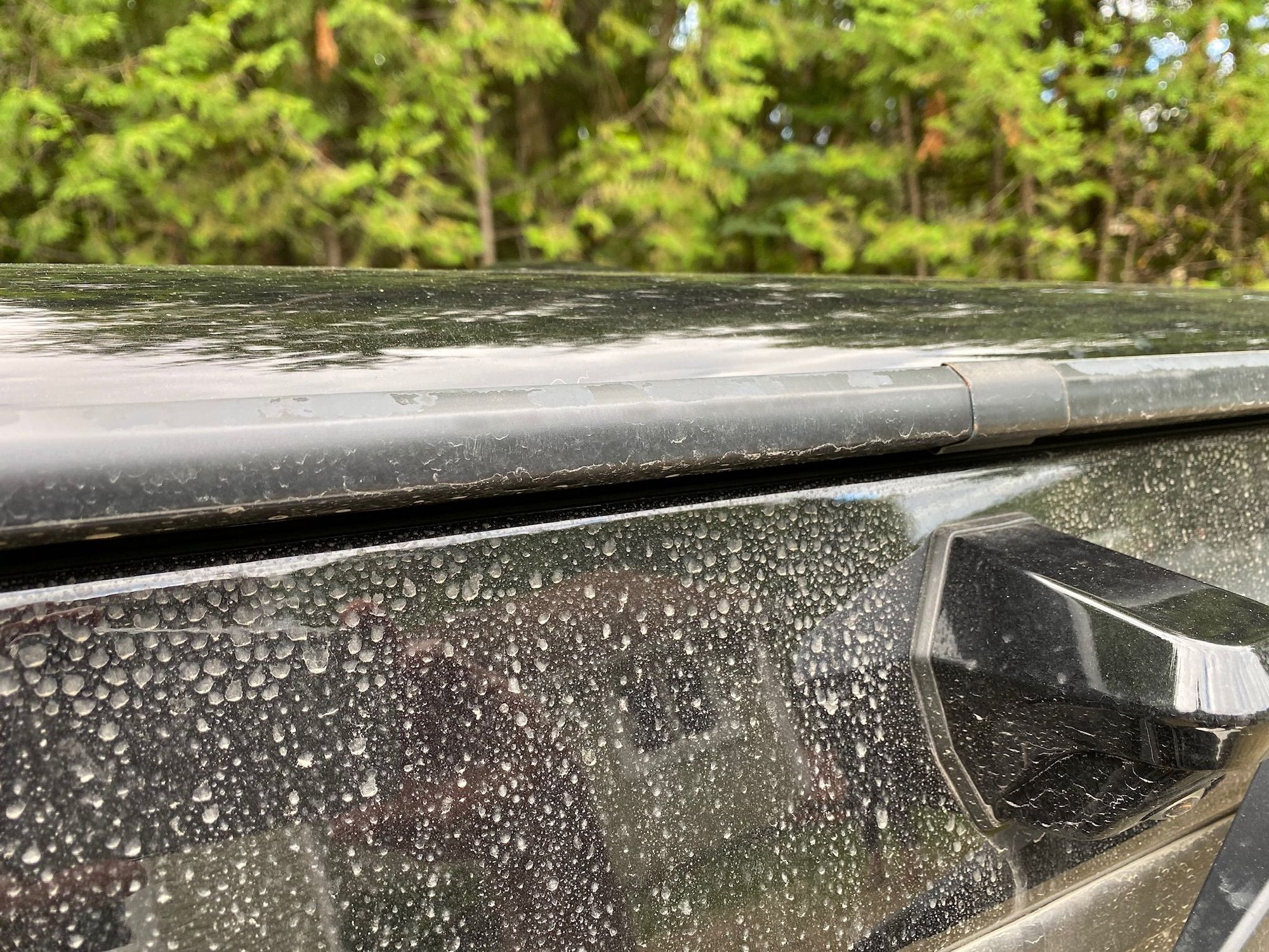

Just notice this.
Is it normal wear?
looks like paint is wearing of the plastic gutters from the rear and 1 side.
Is it under warranty?

That looks like a bad paint job. I would expect it to be warrantied under the bumper-to-bumper coverage. It is not wear, so if you take it in to the stealer be sure to express the problem as a defect and not wear.

Garage kept? Have you had it detailed? Maybe something got on it?

Not sure the gutters are painted, its a piece of hard rubber I think. Looks like someone used a solvent of some sort and ate some of the coat.

odd. my guess is either aggressive car wash chemicals, or aggressive car wash brushes that rub on the gutter surface and over time remove the factory coating. could be a combination of both.

My 2017 G63 has the same gutter issues. I believe it’s from the automated car wash. I showed the dealer and they replaced them under warranty.

I have has customer's with similar issues - like 15's thru 18's - with my customers they usually use a premium car wash to keep their G's clean.
Replacing the pieces with fresh factory pieces WON'T prevent the problem from re-occurring.
Sure 3-4 yrs ago when this "issue" first started to come up - sure we went the "replace-the-trim-route" - and replacement trim develops the same problem for the same customers.
Frankly - the righteous solution that works - our Mercedes Certified Collision Center with our guys 15+ yrs experience want solutions that work - they pull the trim - sand and the trim with matching trim/bumper paint - and for us that has been the proven "right solution" on our side - and we do that for our customers No Charge.
It isn't a question of "is it under warranty or not" - if you have this "issue" the question is how to fix it so it doesn't happen again - and what works, works.

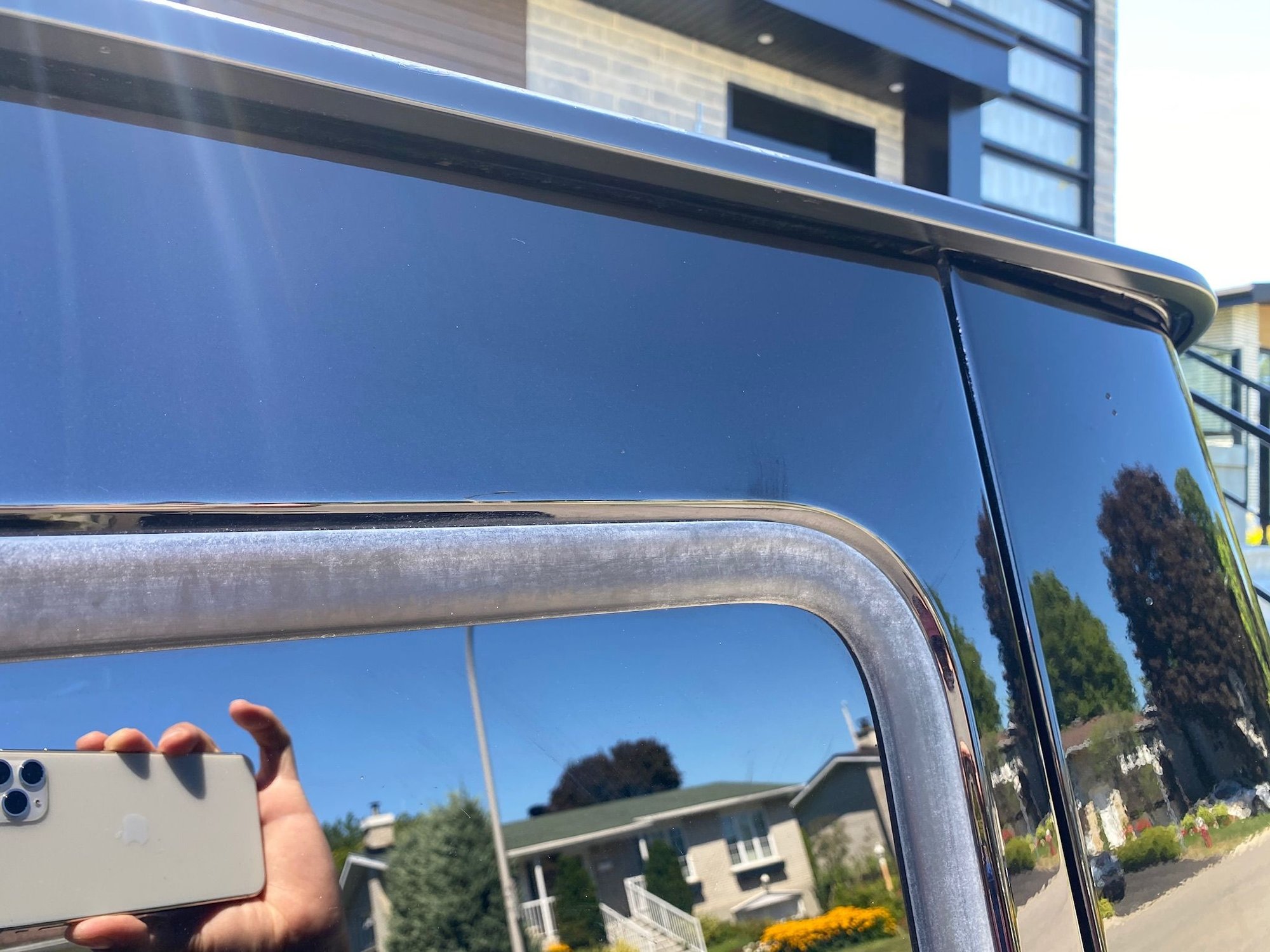

You guys know how to black out the rubber around the back window? It seems white and faded. Normal?

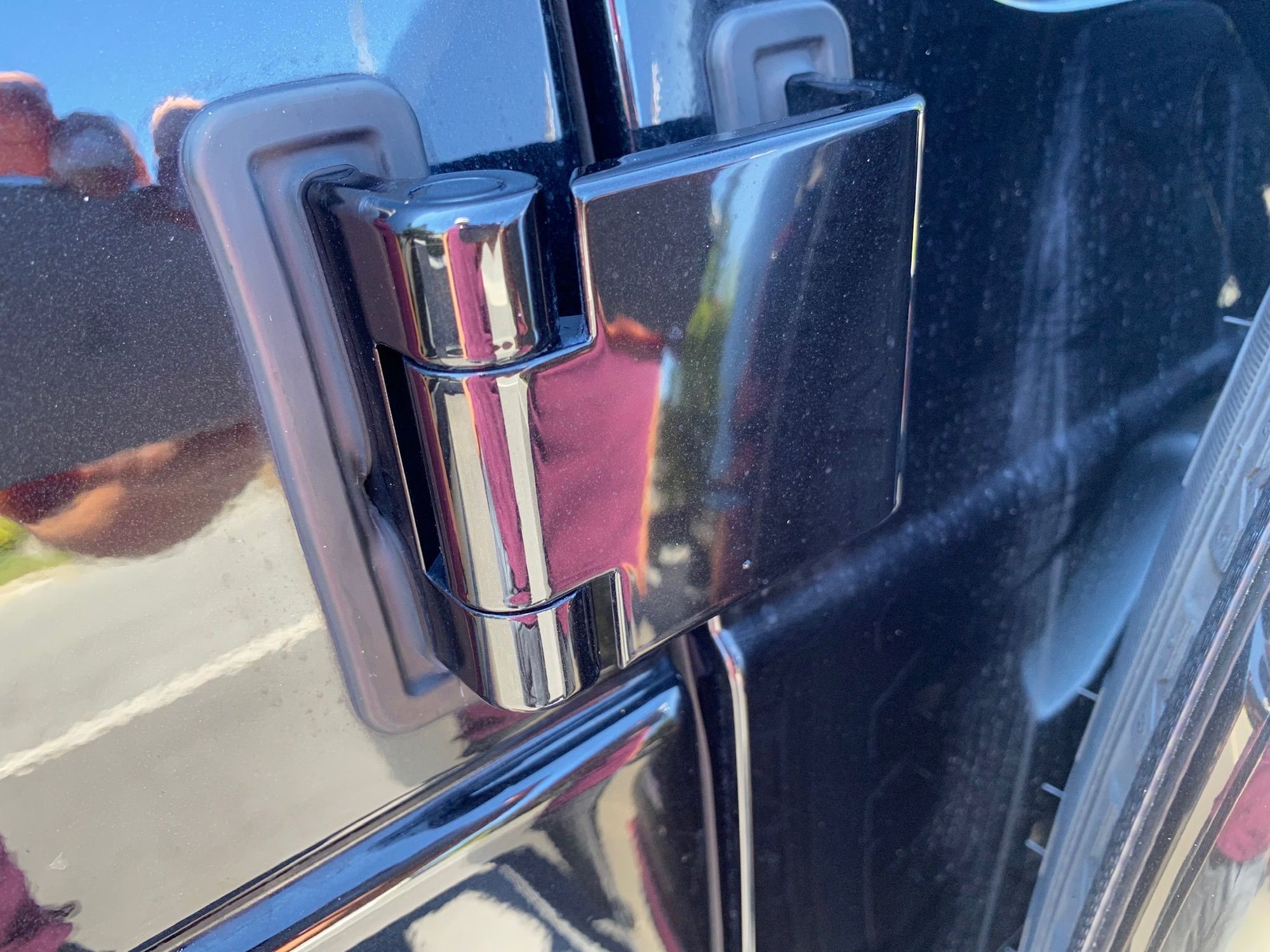

And just asking if your back door hinge rubber has that little crack in the middle? Seems like water could enter...
On my older land rovers I used this stuff and it worked miracles

We have had cases of "milky"/oxidized plastic trim.. we went thru testing on about 16-18 different products... this one stood out as the very best.. we also use it very effectively on VIP customer tires... a little dab goes a long way...
Rubber and black plastic trim it's the bomb..
