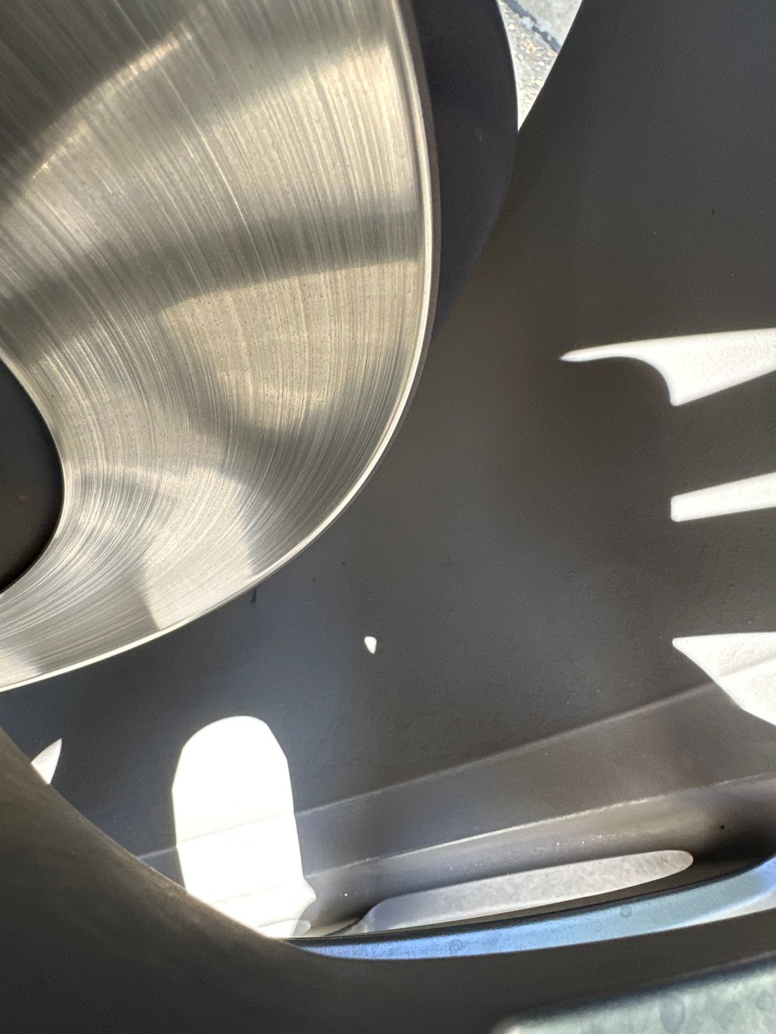

Old Nov 10, 2022 | 10:46 AM
vasbalint's Avatar
Joined: Nov 2022
Posts: 7
2021 G550
Our 2021 550 needs front rotors and pads with every oil change, every other oil change front and rear rotors and pads.
Brake or oil change always come up around the same time with only couple hundred miles difference
Car has 34k miles had at least 4 time the brakes changed already. Dealer serviced mostly, only the last brake service and oils, all filters change was done at my buddies shop and we used all original Mercedes’ parts from the dealer. Same results regarding the wear of the disk and pads. Oil is due now and the brake came up two days later
never had a car that eats the brakes like this. My extended Sprinter has a lot of brake dust but brakes last about 40k on it between brake pad change.
on the g550 the rotors wear out so bad that there is no way reusing them, has a huge lip when the pads are due, ridiculous
not enough info online yet on forums but we’ll see what other peoples experience is with this model

Old Nov 10, 2022 | 12:38 PM
vasbalint's Avatar
Joined: Nov 2022
Posts: 7
2021 G550
I wouldn’t believe it myself if someone tells me. Fletcher Joshns MB charged $5500 in the past for servicing the brakes few times and last we got the parts from MB in Beverly Hills and installed it ourselves at a reputable body shop in the area. Shop owned by my friend who is an expert in high end cars. Him and his brother couldn’t believe it either what’s going on
Everything moving freely before and after the brakes installation
Getting a little over 13mpg here in the city
I think parts cost was about $2k . All filters oil, front drums and pads. This time will be more because of the rear pads and rotors need to be added ​. All this with a pretty good discount from the dealer
Let’s see what other have to say later on about their experience on this model

Old Oct 31, 2024 | 03:32 PM
vasbalint's Avatar
Joined: Nov 2022
Posts: 7
2021 G550
The problem is that they wear out so deep in 10k miles that no shop will touch it to rotate them.
About 8k on them. About 3k left 🤪. Car has 61k now and had new rotors at just about every oil change due to the check warning light for worn pads. Cars is heavy, brakes are soft. My sprinter van does similar
Old Oct 31, 2024 | 03:46 PM
streborx's Avatar
Top Answer: 1
Joined: Oct 2019
Posts: 5,161
Likes: 1,772
From: Colorado
G550
It's costing you more per mile to stop than to go! Are the pads wearing out at the same rate?
