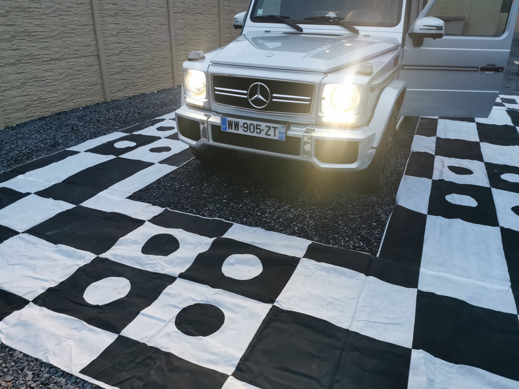

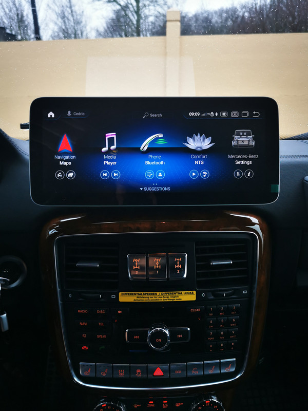

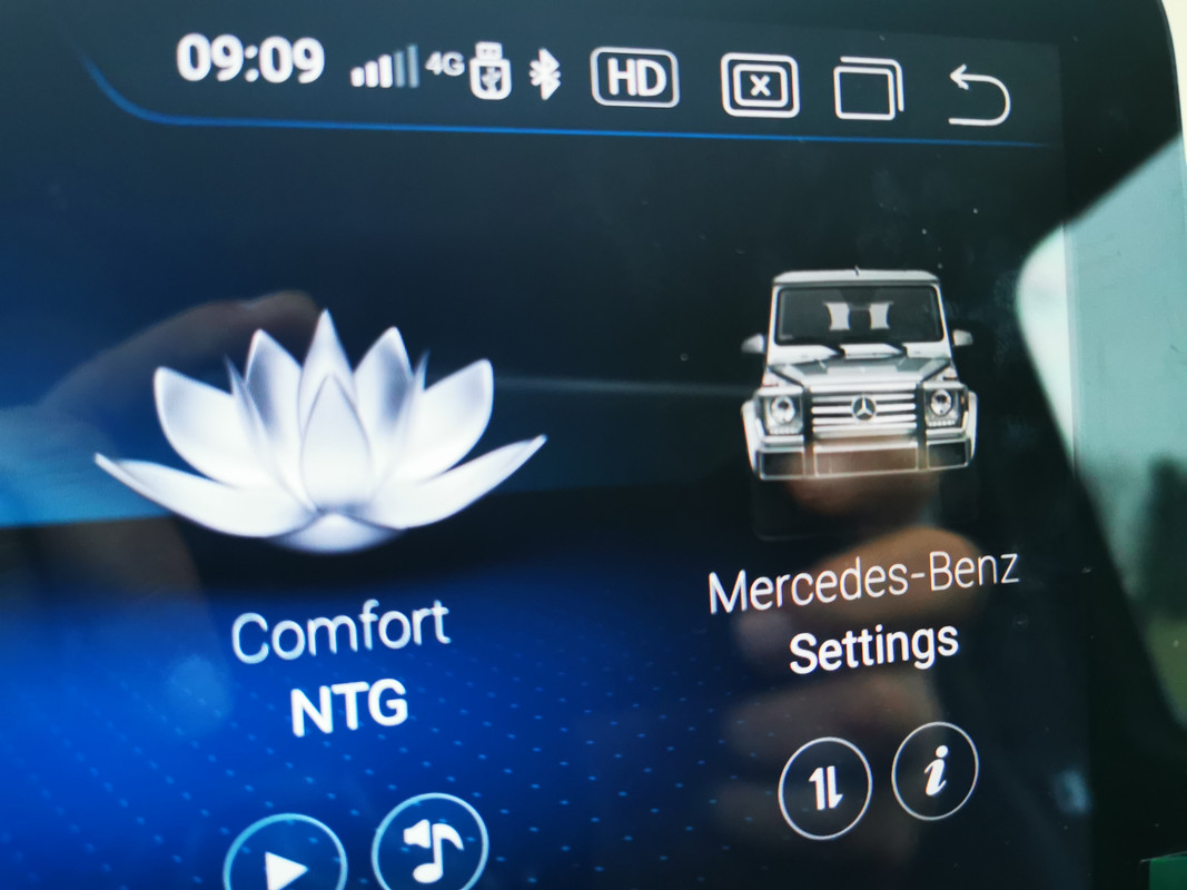

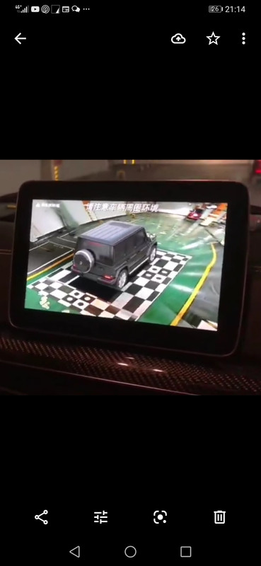

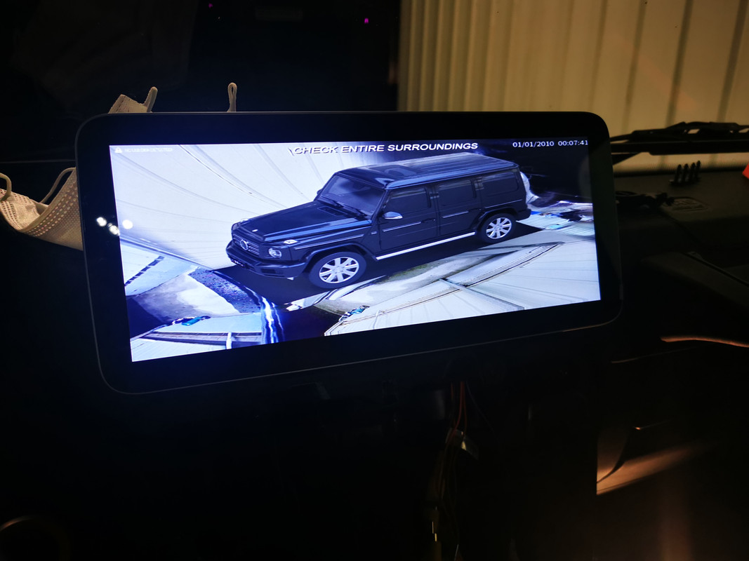

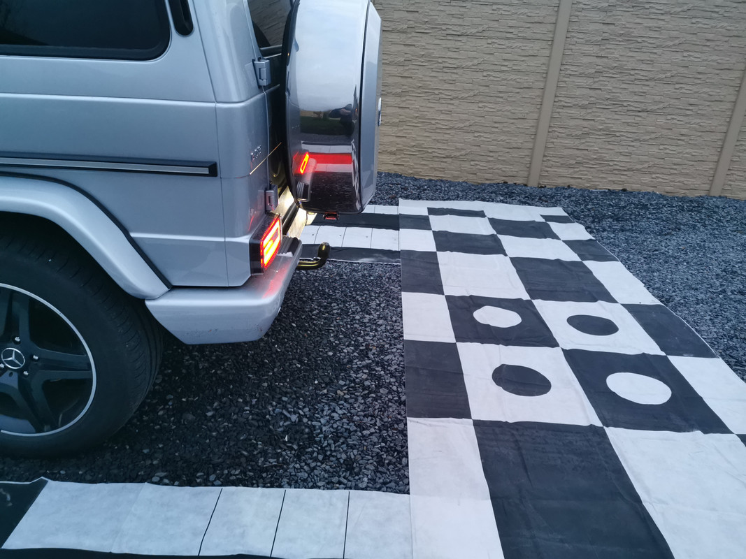

Hello everyone, I am completely satisfied with my screen bought from DMP, today it works perfectly, I have no problem, I upgraded it a bit by adding their 3D camera, the rendering is rather nice. that I haven't calibrated them yet. For the inside of the rear door, all you have to do is unscrew the inner cuff, you have 2 plastic covers to remove and you unscrew them, then you remove the door panel. I therefore changed the OEM camera, this one is simply clipped into its support that you can unscrew from the inside, attached some photos

NICE Upgrade! How does the 3D camera work? Do you have to install more than 1 camera (to get all 4 sides of the truck). I think the 2019+ might offer this, but it looks like yours is 2018 or older as well. The 3d camera might solve my issue of not being able to see if the spare tire is going to hit something.

Better as that, cam 360 gives you possibilities to see your car completely outside, so look

Which 3D camera system did you use? I've been researching these for retrofit but have not seen that many good reviews on aftermarket systems that aren't crazy expensive.

just bumping this: has anyone else done this 3D camera upgrade? Who offers them & what is involved?

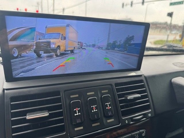

I just purchased 2002 G500 and instead of in dash unit, I have installed $140 11" Carplay unit and connected to stock Command unit via AUX.
Did not want to disturb the Command unit but to add Carplay.

how did you mount unit to dash?

I purchased this unit from Amazon. Base fits perfect with the edge of center AC vent frame with double sided tape that is already applied.

That is a great solution for a G500.

thank you. what's the source of power? i.e., how wired for power?

i tapped into fuse box by driver side. Purchased wiring kit for using fuse tap. Installed grommet on the center speaker and routed all cables and wires through that. I will take some pictures later

Here is the picture of install
