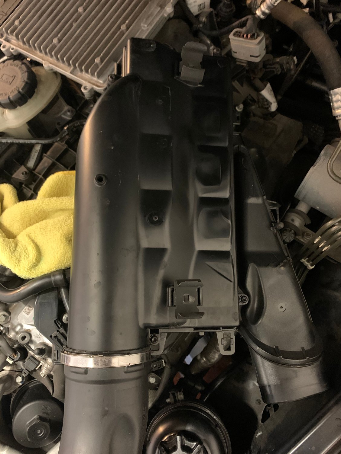

Does anyone have pictures to where these 4 torx screws are. I have been able to get the engine cover off on my 2014 G 63, but i cant find teh screw.

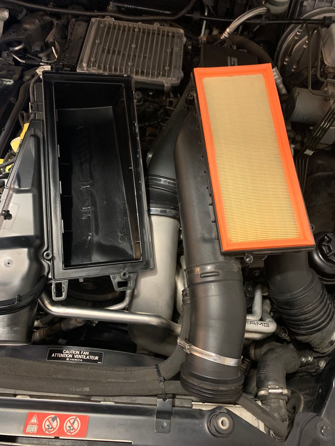

Old Nov 6, 2020 | 04:01 PM
streborx's Avatar
Top Answer: 1
Joined: Oct 2019
Posts: 5,156
Likes: 1,770
From: Colorado
G550
Thanks
Photo shows driver's side (passenger side is mirror image). Torx fasteners are located where red arrows point and are T25.
NIce to know that others are doing this kind of work for themselves.

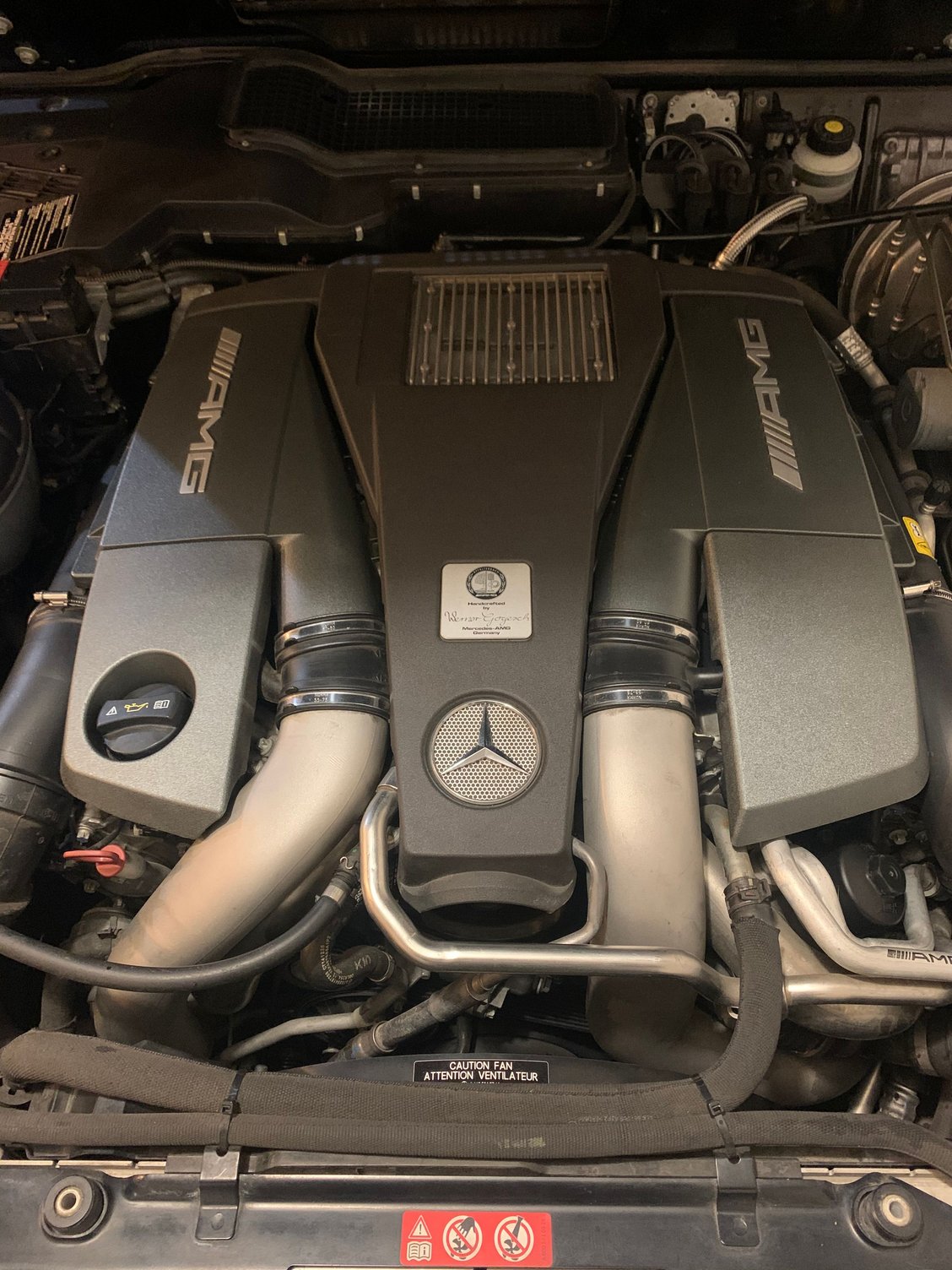

Old Nov 7, 2020 | 12:59 AM
ash0468's Avatar
Joined: Jul 2020
Posts: 64
2019 Mercedes Benz G63
My air box is different. Let me go home and post a picture. Thanks for the help though.
here is how my engine looks- so I need to remove hoses and the air boxes will pop out??
Old Nov 7, 2020 | 09:42 AM
streborx's Avatar
Top Answer: 1
Joined: Oct 2019
Posts: 5,156
Likes: 1,770
From: Colorado
G550
Sorry - my reply was directed to the OP. I didn't catch the MY "2014" in your question. If you know your engine model number, check to find its use in other MB car models. If you can't find a shop manual for your 2014 G, you might find one for another car model with this engine.

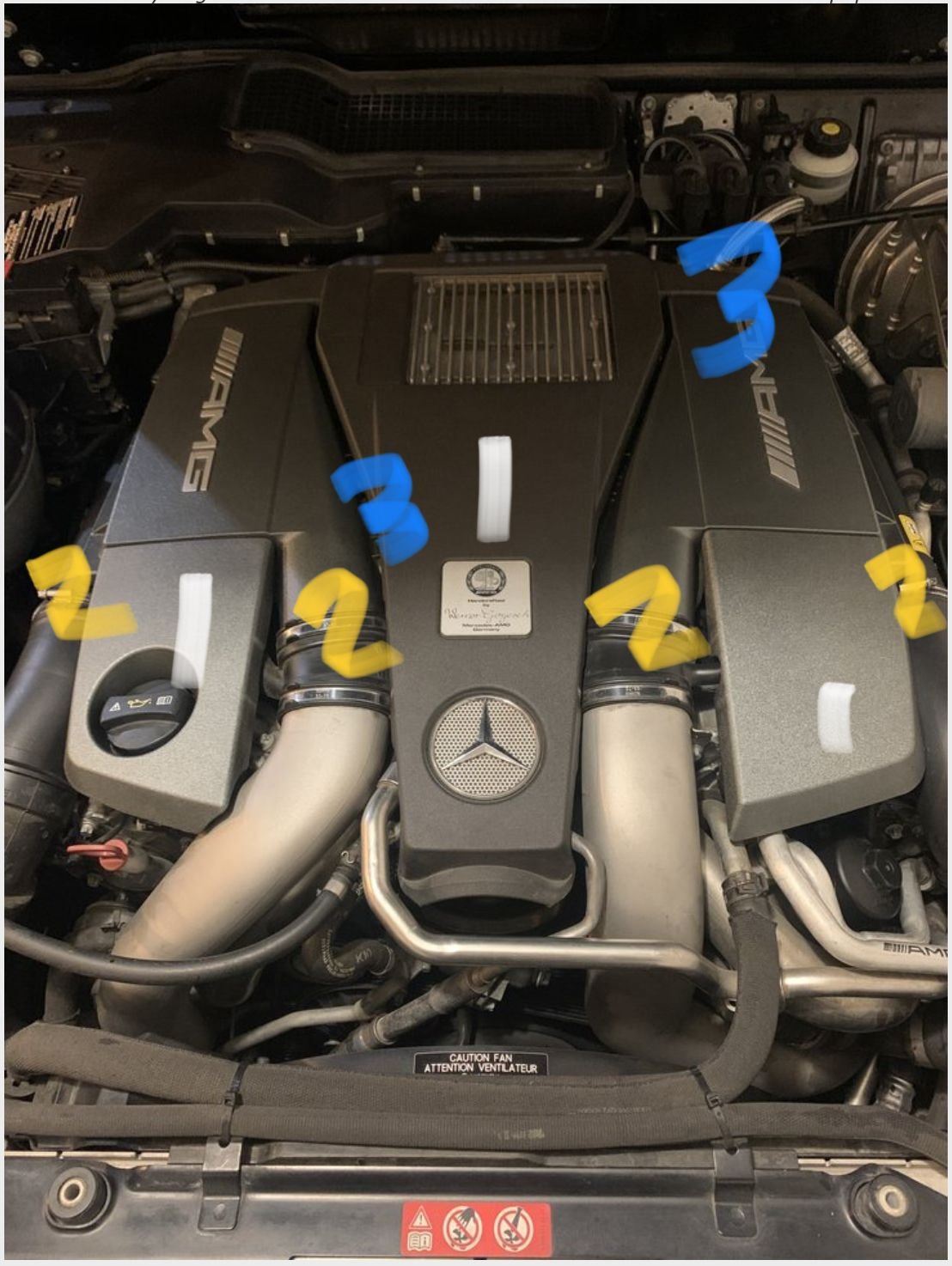

Old Nov 7, 2020 | 01:44 PM
EnigmaAW's Avatar
Joined: Jan 2009
Posts: 595
Likes: 36
From: Savannah, GA
2021 G63
each item is numbered.
1-remove the 3 covers by pulling each cover up gently
2- loosen the hose clamps, 4 total
3- separate the sensor connectors, one on the back of the driver side air box, and one on the side of the passenger air box. There is a small tab/lock that keeps the sensors together.
then pull the air box up and out of the air intake piping. Flip over and see the torx screws to open the air box.
Old Nov 9, 2020 | 10:35 AM
ash0468's Avatar
Joined: Jul 2020
Posts: 64
this was very helpful. I followed these instructions and was able to get my air filters switched. Thanks for helping out .
