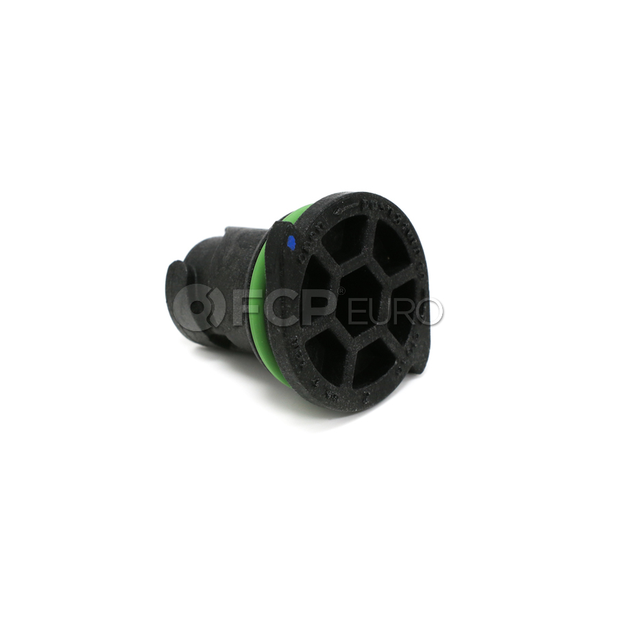

Does your drain plug look like this (MB p/n 178 014 03 00)?

That is the filter drain, I am referring to the drain plug attached to the oil pan.
My oil filter housing drain was 10mm as you described.

The filter cap drain plug is a bit different as shown in the photo toward the top of this thread. The photo I just posted is an oil pan drain plug that is used with some m176 engines that also have a plastic oil pan. If your oil pan and drain plug are both metal, then the drain plug's MB p/n should be 000000-008789. I can't find any info about this drain plug's thread, length or head style. When I next do an oil change, I'll measure it and post its dimensions.
In checking around some parts suppliers, there's mass confusion over fitment. FCP Euro says this plastic plug fits my '19 G550 and autohausaz says the -8789 plug doesn't fit.

Wow, I didn’t know any vehicle used a plastic drain plug, seems like a disaster waiting to happen.
I will slide under my G and take some photos.
I thought the same thing the first time I saw a plastic filter cap. Apparently this plastic drain plug is used on the m176 engine in the S-Class (see attachment).
Interesting that this service procedure specs 9 liters (9.5 qts.) for oil, while the OM specs 10 qts.
9 liters is the correct capacity.

Here is the drain plug, you can see the damage to the plug from initially using a torx on it.
