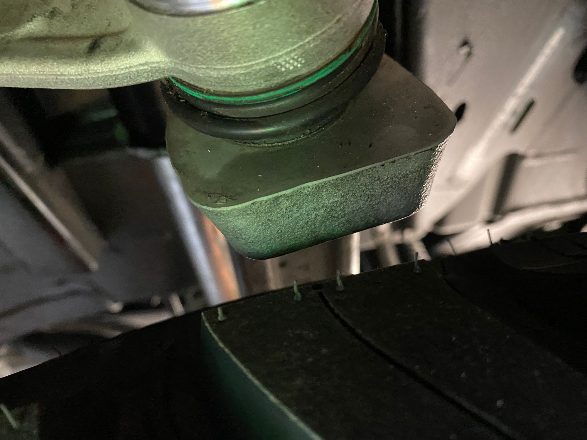

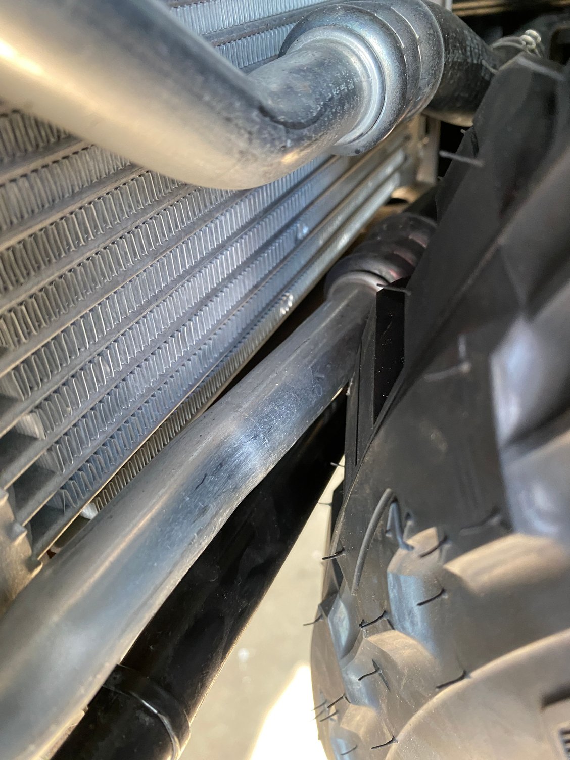

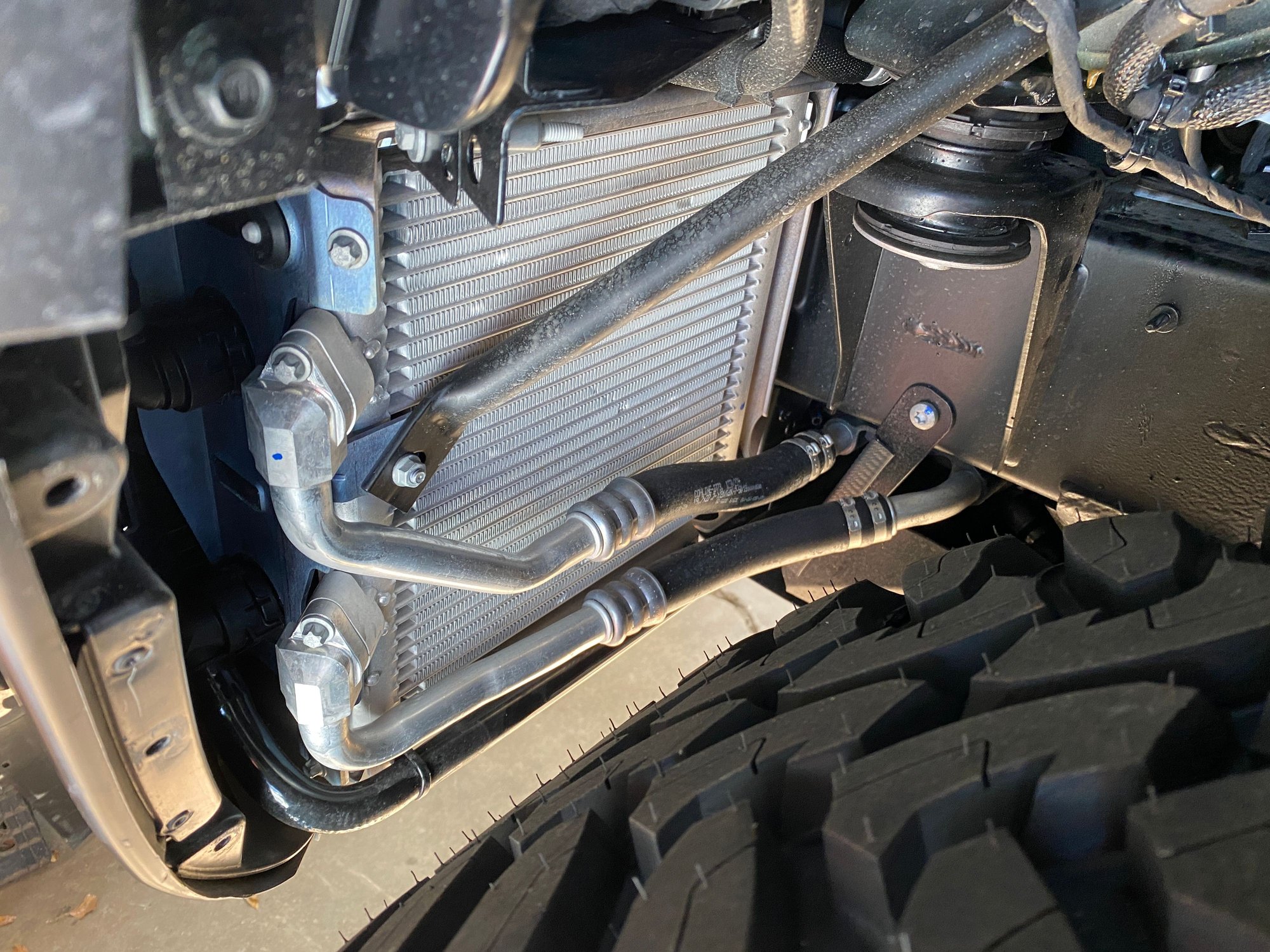

I know there are at least a couple of 2019+ G63s on 35s (at least in pictures), but I don't know how they are doing it. I'm running a 50mm LeTech lift with the perch all the way to the top, and the 35" tire still rubs the intercooler lines. If you put the fender liner back in, it makes it even tighter. This pic actually doesn't show it fully, but as the tire rotates it rubs the black lower line, as well as the lowest silver line. We are going to try and move the intercooler a little bit forward, but everything is packed in there pretty tight. Not sure how to get that extra space.
The wheel fitment is critical, and I'm running a 10.5" wide wheel with 35mm offset, and 23mm wheel spacers. That barely allows for tire clearance on the knuckle, so I can't run less wheel spacer to pull it in without the tire hitting the top of the knuckle.

I would think a race fabricator would be able to move those two lines fairly easy. You have several great turbo system builders in Texas especially the SAntiono area. Plumbing is not a big deal I would think especially as such a large part of the system is rubber. If you can’t find one let me know if you need a contact number.
update: I sent your pics to a fabricator I have known for 30 years and have asked him for some info/guidance

Thanks. Let me know what he says. My initial thought was to relocate the lines too, but wasn't sure how much of a pain it would be.

@Mopars did you ever hear back from your friend about this plumbing issue? We didn't end up having time to mess with trying to move the cooler forward because it was going to take a lot of work, so I'm just going to stick with the 33" tires for now. I'd still like to run the 35s though if I can figure out a solution for the lines.

Even with the lines moved and the cooler shifted forward, don't you still need the plastic shroud to keep the cooler venting from collecting debris?
Yes, but that's a pretty easy modification compared to moving the cooler. Several options exist like moving it forward some once the cooler is out of the way, or cut the protruding part out and recreate it with some mesh or other cover to protect it.
