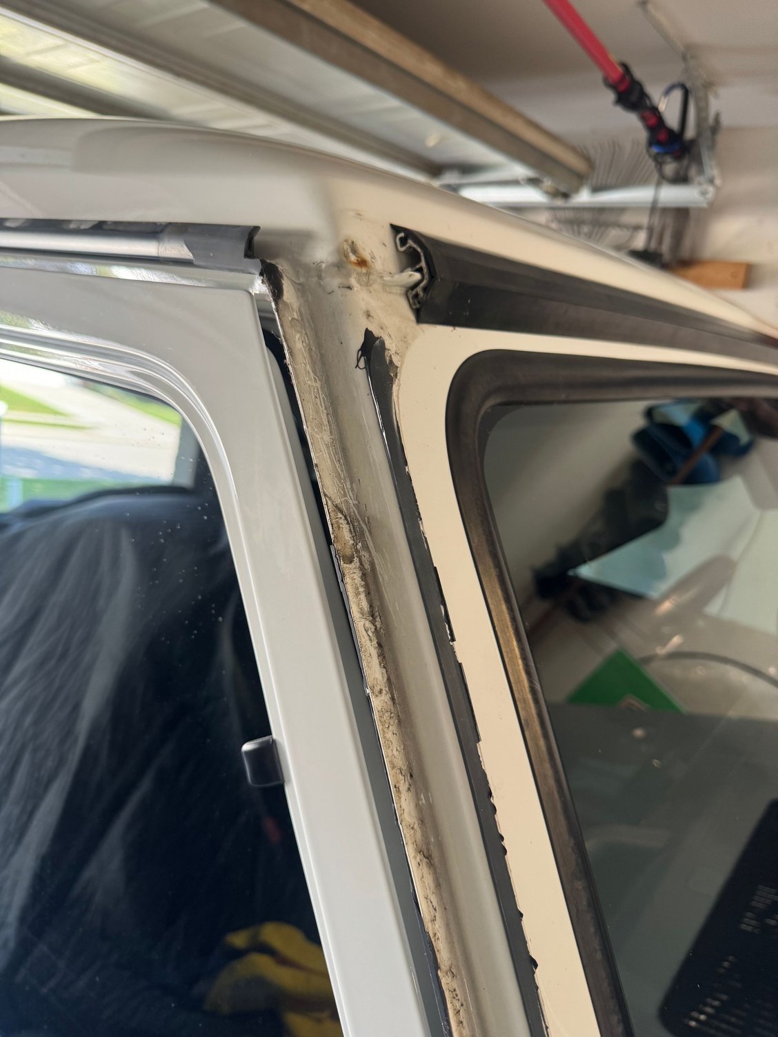

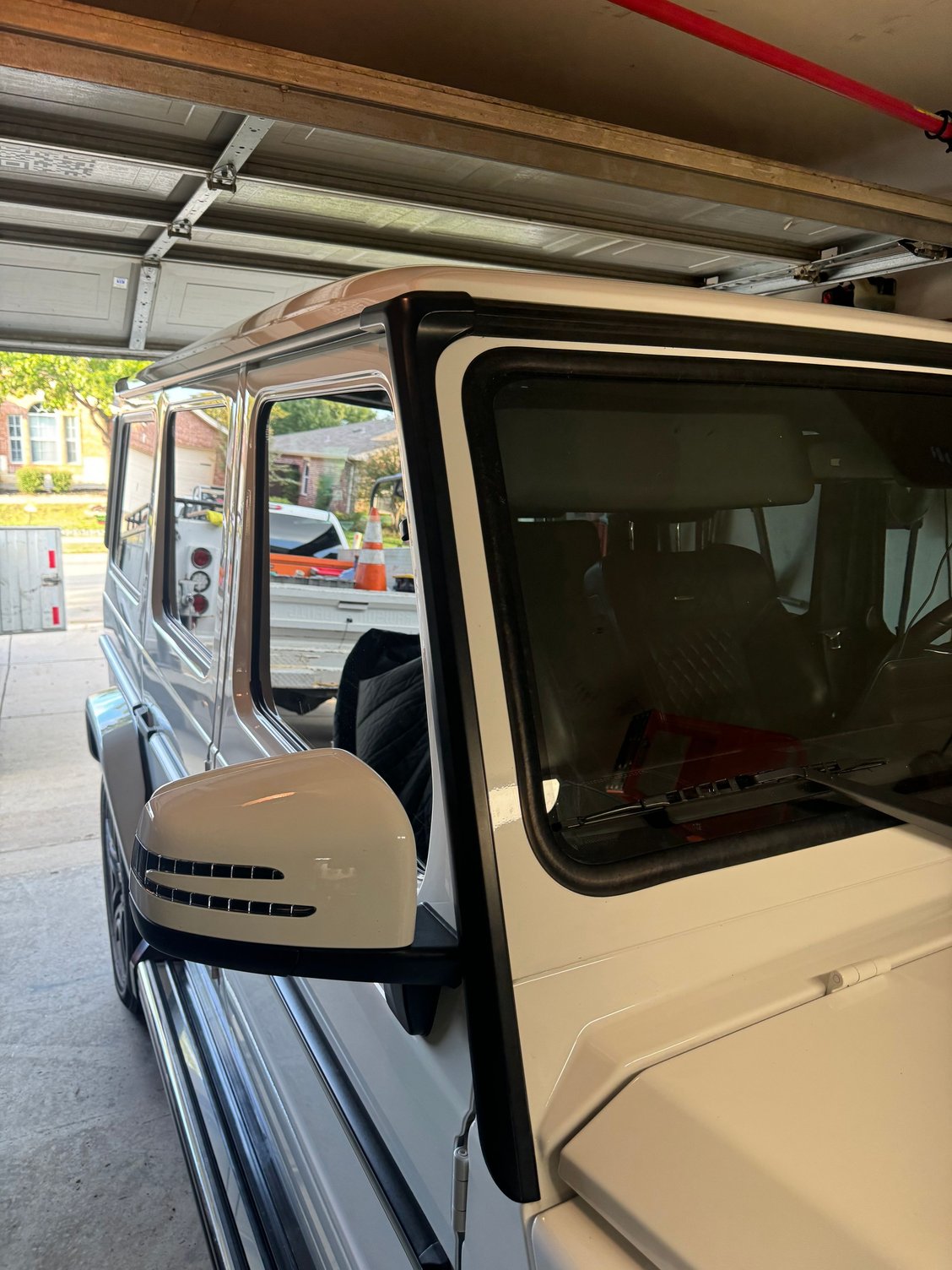

It was actually quite easy in the end. The vertical part that meets at the top of the windshield is just glued on. Ran a heat gun up and down the vertical parts where it’s obvious the glue is on the inside of the door jam and the windshield facing. Start at the top and start pulling outward.

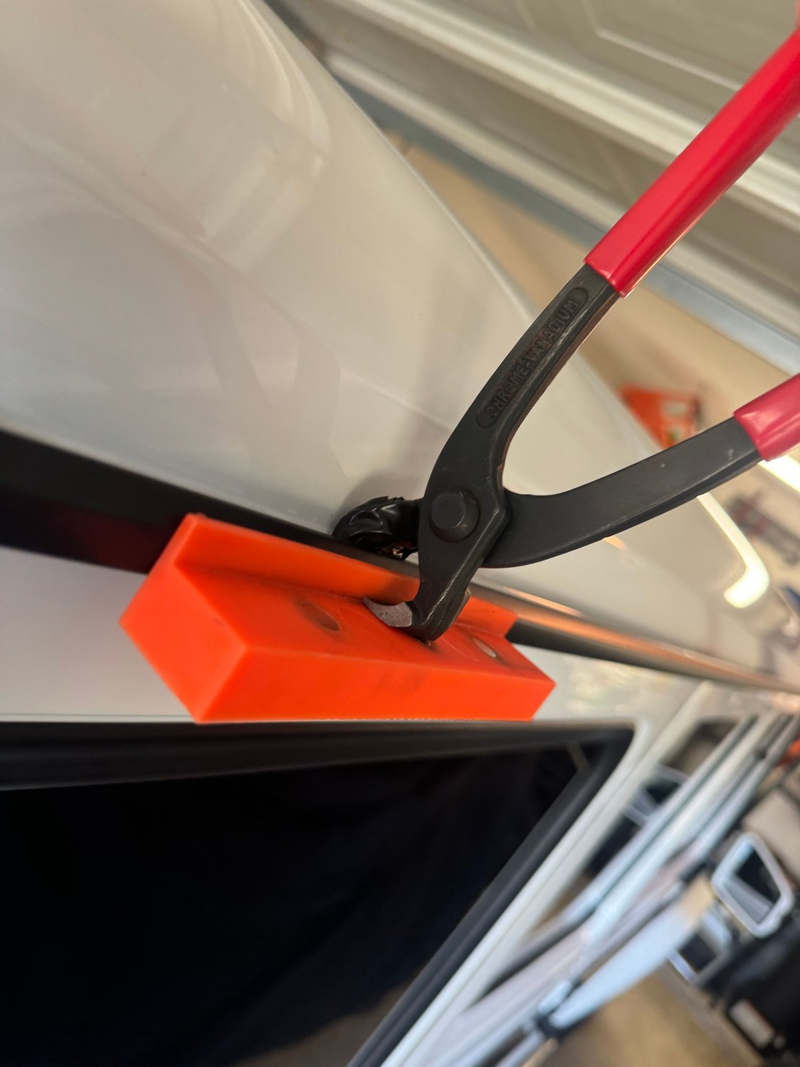

Made my own trim tool out of some plastic generic trim tools. Pry upwards to remove the trim pieces.
To put the new piece on it has to be crimped.

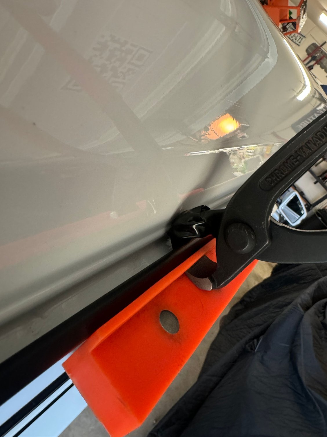

i’m sure there’s a special tool for this, but I accomplished it with my pinch pliers, some tape around one side and a plastic block to put against the face of the molding.
Work slowly from one side to the other. I made two passes out of it.
[img alt="The glue is just on the pinch weld, and at the front where the molding meets the face of the windshield. I believe it’s there so air does not get under it on the highway. I used 3M window adhesive (get it at O’Reillys) to put this back together. Be sparing with it and put it on The molding first then install.
There was also a little bit of glue where the long drip rail molding meets the top of this piece. You’ll notice it when you uninstall."]https://cimg0.ibsrv.net/gimg/www.mbworld.org-vbulletin/2000x1504/img_0970_6e1f46837e8772b893e6a1aaa4f1c7245a1efdde. jpeg[/img]
The glue is just on the pinch weld, and at the front where the molding meets the face of the windshield. I believe it’s there so air does not get under it on the highway. I used 3M window adhesive (get it at O’Reillys) to put this back together. Be sparing with it and put it on The molding first then install. There was also a little bit of glue where the long drip rail molding meets the top of this piece. You’ll notice it when you uninstall.
Using a heat gun on the outside of the molding worked for breaking the molding free from the glue. You’ll hear a physical pop when it happens.

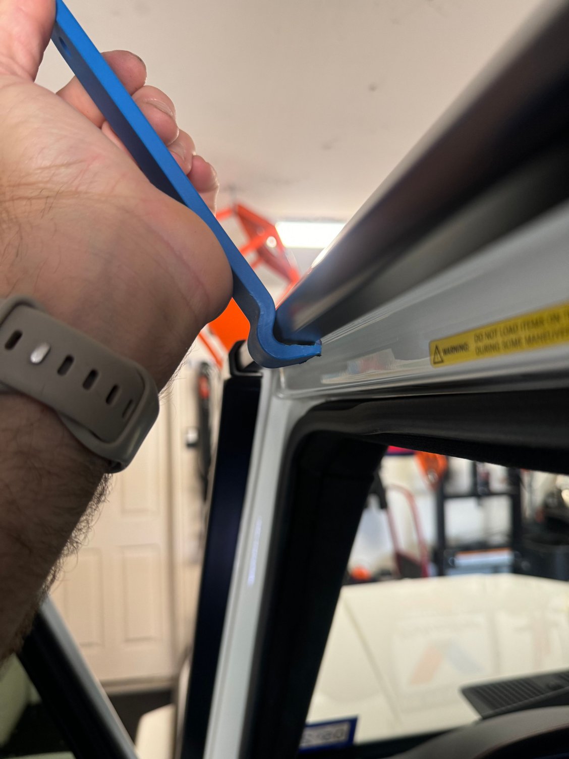

[img alt="This was a plastic trim tool that I cut the end off of and put a notch in. Essentially you need something that looks like a big bottle opener.
There are three small little molding caps that go on the three intersections near the back. I use this to remove those as well."]https://cimg2.ibsrv.net/gimg/www.mbworld.org-vbulletin/2000x1504/img_0975_7c5d6d1b2016dc9e7c870ed0b63b5e4cecb12d86. jpeg[/img]
This was a plastic trim tool that I cut the end off of and put a notch in. Essentially you need something that looks like a big bottle opener. There are three small little molding caps that go on the three intersections near the back. I use this to remove those as well.
Pull up like a bottle cap. Start on one end and work slowly making two passes. This will ensure the old one comes off easily without scratching anything.

You’ll notice the inside of the molding has a little flap that is meant to be squeezed onto the drip rail. I accomplished this with some pinch pliers and this plastic block. I started at one side and pinched it snug but not tight. Worked my way all the way down crimping every inch and a half or so. Worked my way back with a little bit tighter crimp closer together. When you’re done the rail should be firm and not jiggle or move around.
I wrapped tape around the side of the pliers that was coming close to the paint. This helps with more protection.

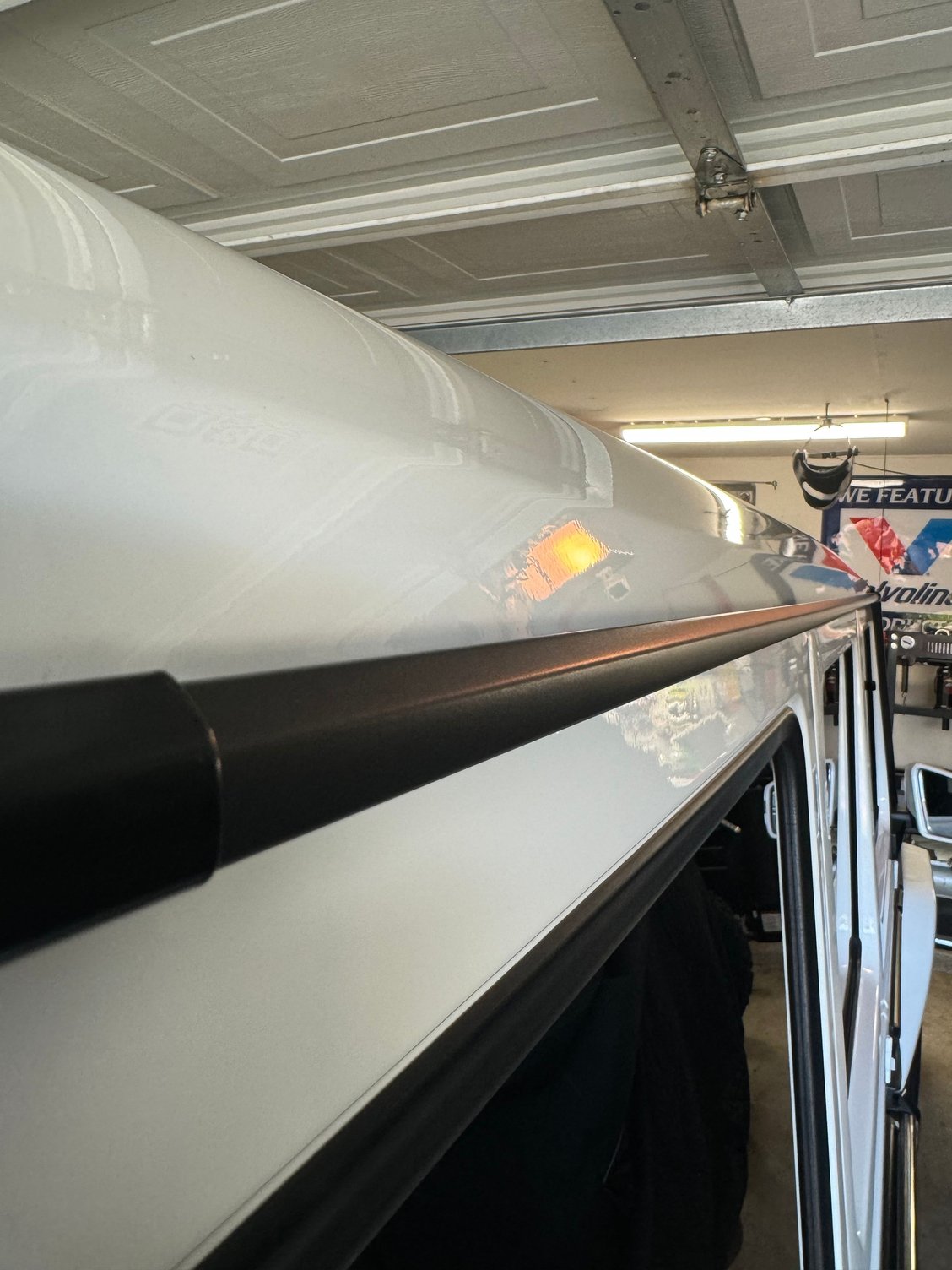

As you can see there’s no dings in the new molding. The plastic works good to distribute the load. One of the plastic molding tools probably would’ve worked fine for this. I used a plastic vise insert.

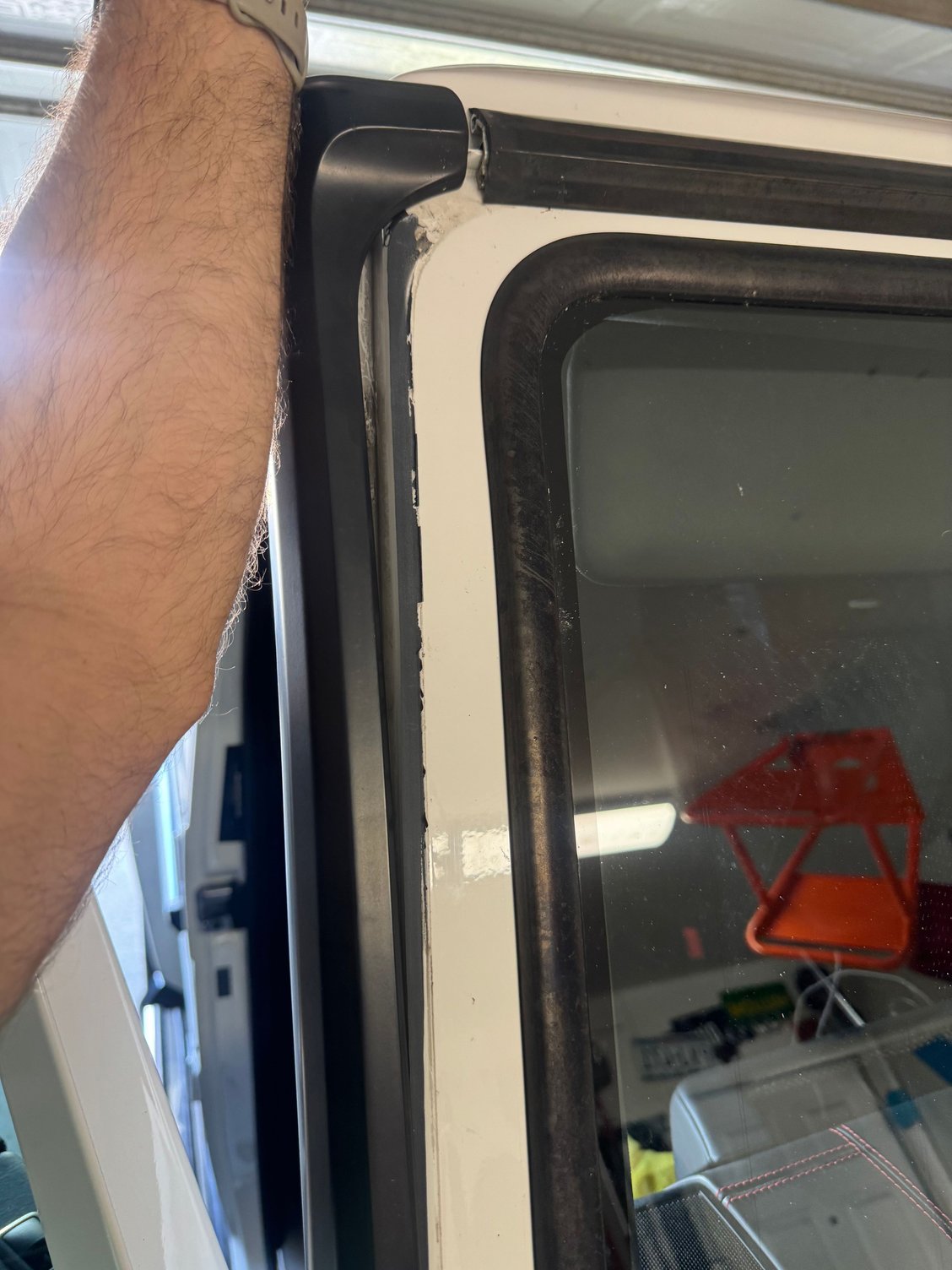

Seems like maybe some of my pictures aren’t coming through. Here’s a shot of the inside edge where I used the plastic tool to get started.
It is reusable, start at the top and work your way down. Use the heat gun to heat up where you see the glue. Use a plastic pry tool to wiggle the plastic. You can hear an audible pop when the glue separates from the plastic. prying here on the inside edge where the metal is folded worked for me. The folded metal is strong enough to withstand the plastic pry tool.
