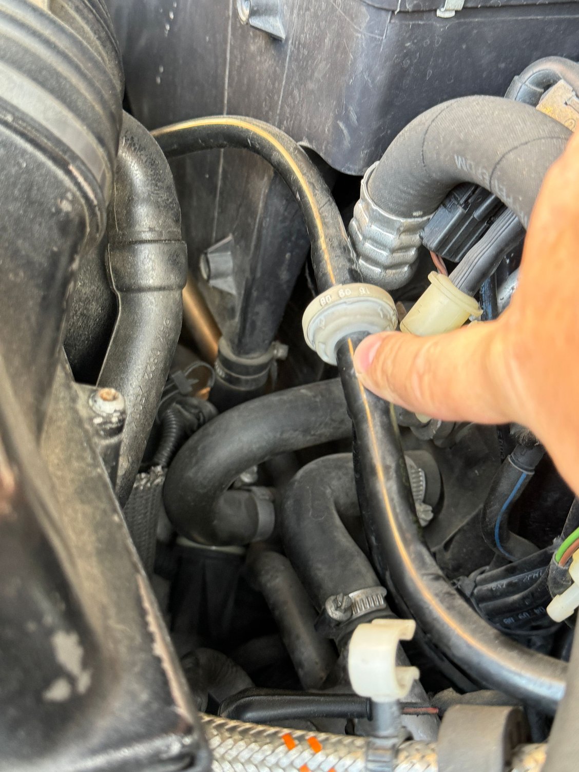

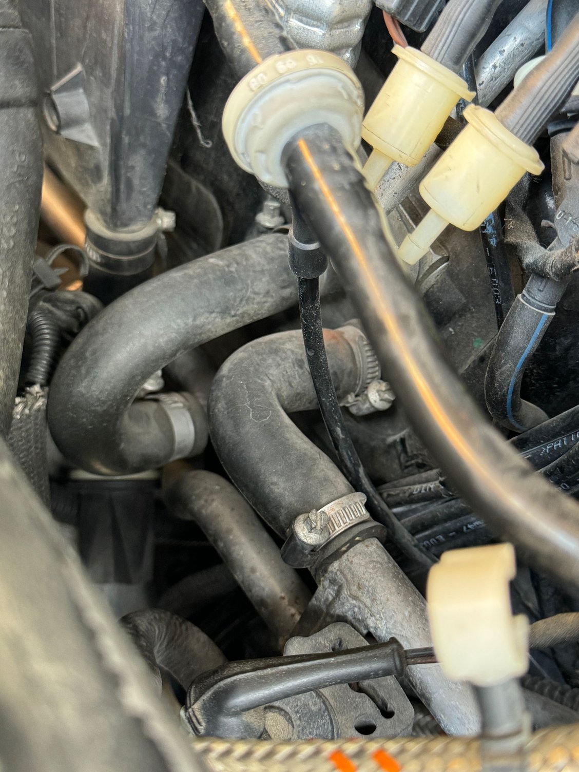

I know his is old thread but I didn’t see a solution so I wanted to share how solution.
i had same issue after changing #8 ignition coil. I found Xentry didn’t really give me much help other then to say vacuum leak. So upon looking I saw this vacuum and hose disconnected from bottom. Upon reconnecting then clearing all codes issue has been resolved. Hope it helps.
