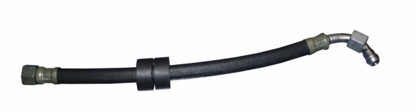

I am however having hell of a time finding the stupid replacement hose. I've checked few Benz part sites, including https://partsouq.com however no luck
I think it's https://www.mbonlineparts.com/oem-pa...ine-4632701496 however unsure as diagrams don't match what I see on my truck
I might even just have local shop make me one. They usually can make any hose with any fitting.
If someone has experienced the same, please share (including part number of the hose)
It looks similar to this

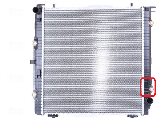

I got replacement Nissens radiator and had local shop make me the line for $40 CAD
There is no need to buy this from the dealer.
I also found out why the fitting rusted out. Someone had a great idea to put foam insulation around the fitting, which attracted moisture and rusted out the fitting
I still don't understand why manufacturers use foam knowing that moisture will get in there and cause rust...

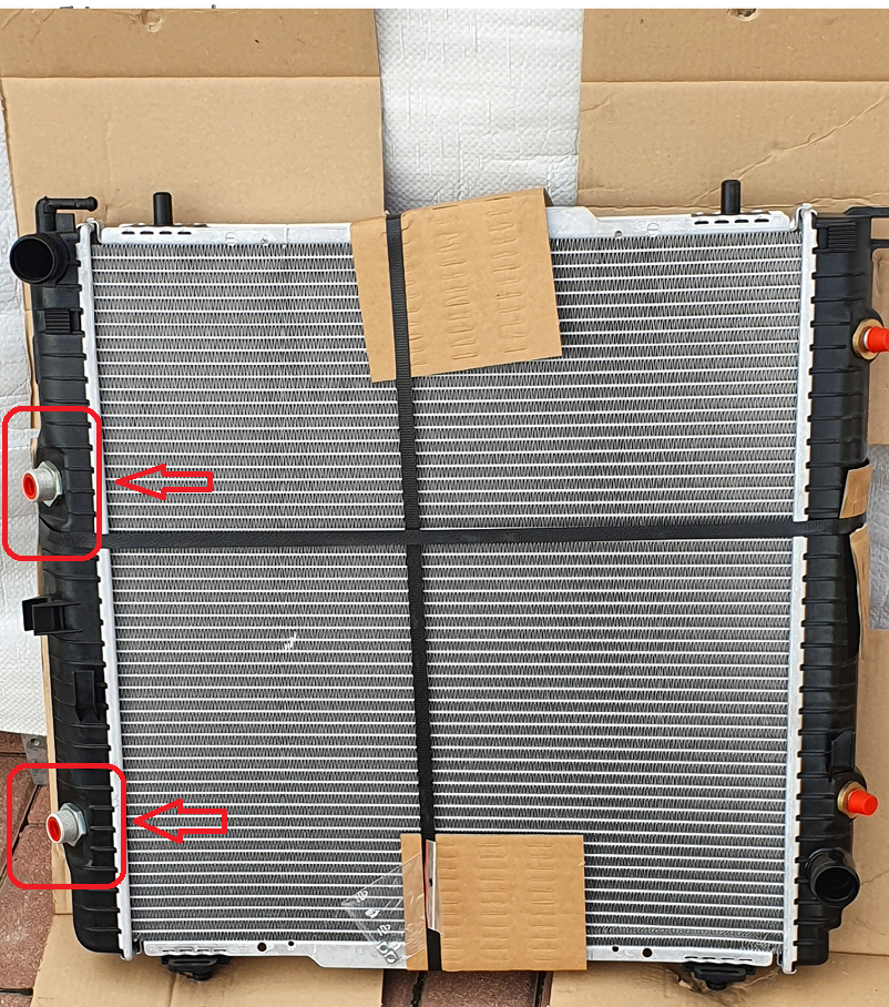

And finally, Nissens radiator comes with transmission cooler bank on other side, that's not used on G55.
No ATF will flow thru it, however if you want to cap it (like I did), need two M26x1.5 Caps, part number 5204L-18.
More details at https://www.adaptall.com/products/Me...4/5204L-18.php
