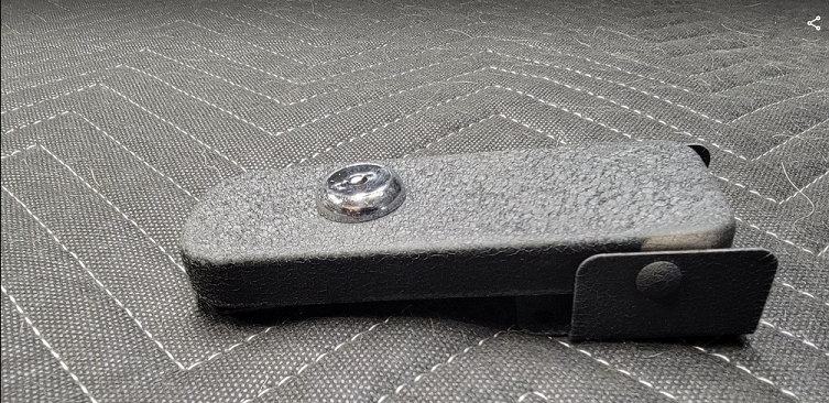

Here's the black one from 4x4club that I decided not to install

Got it from my local MB dealer. The latch was special order but the cam lock wasn't. Latch was $109 and the cam lock was $112. However, you can also get the OEM cam lock from eBay for around $65

Why was this not a factory default? Were people losing the keys and Mercedes didn't wish to support copies? I just finished the install, similar to JW001, in which I bought the older latch and key lock, and I had to special order the latch across the pond. Drill out the existing rivets, use a rivet gun to attach the new replacement plate, attach the lock. The latch comes with rivets.

You don't have to drill out the old rivets. Just replace the screw hook part from the new latch. It just screws back into the existing latch that's on the wheel carrier.

Exactly what I did. I ordered mine from UK. https://www.ebay.com/itm/302726668179
I also transferred the lock from replacement piece into factory latch, so didn't have to drill any rivets

I hope you didn't pay $250+ for this?
Check out https://www.ebay.com/itm/302726668179
It's the same part, just powder coated or whatever that amateur-style-painted black stuff is on that at 7x the markup. Yes, 7x the markup
It's actually insane that some of these old school business are doing this in this day and age, considering so much information is available out there
I personally had a very bad experience some time ago and will rather burn my G than ever give this guy a single dollar
