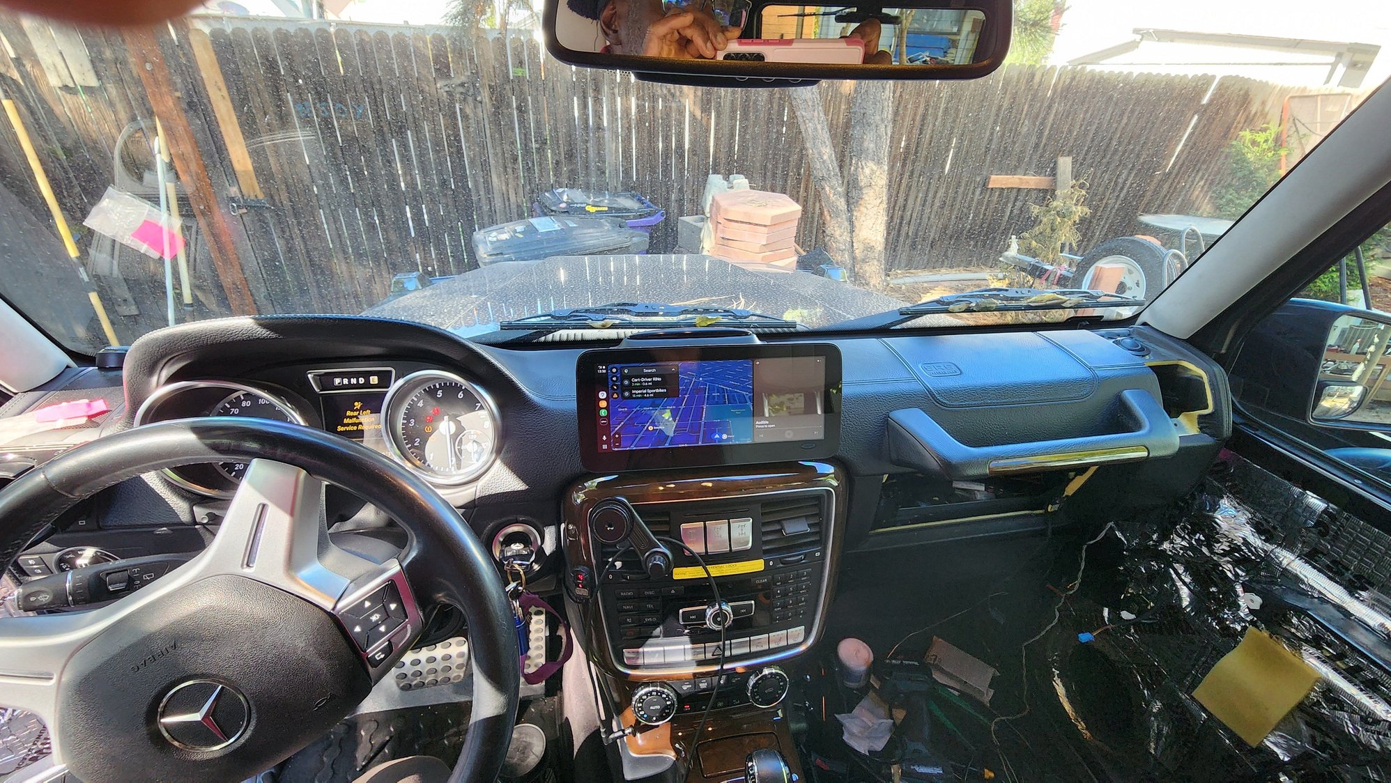

Does anyone have a photo of the 10" screen installed in the cabin for comparison to the 12" screen?

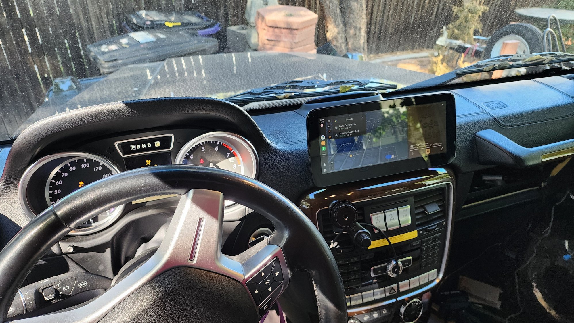

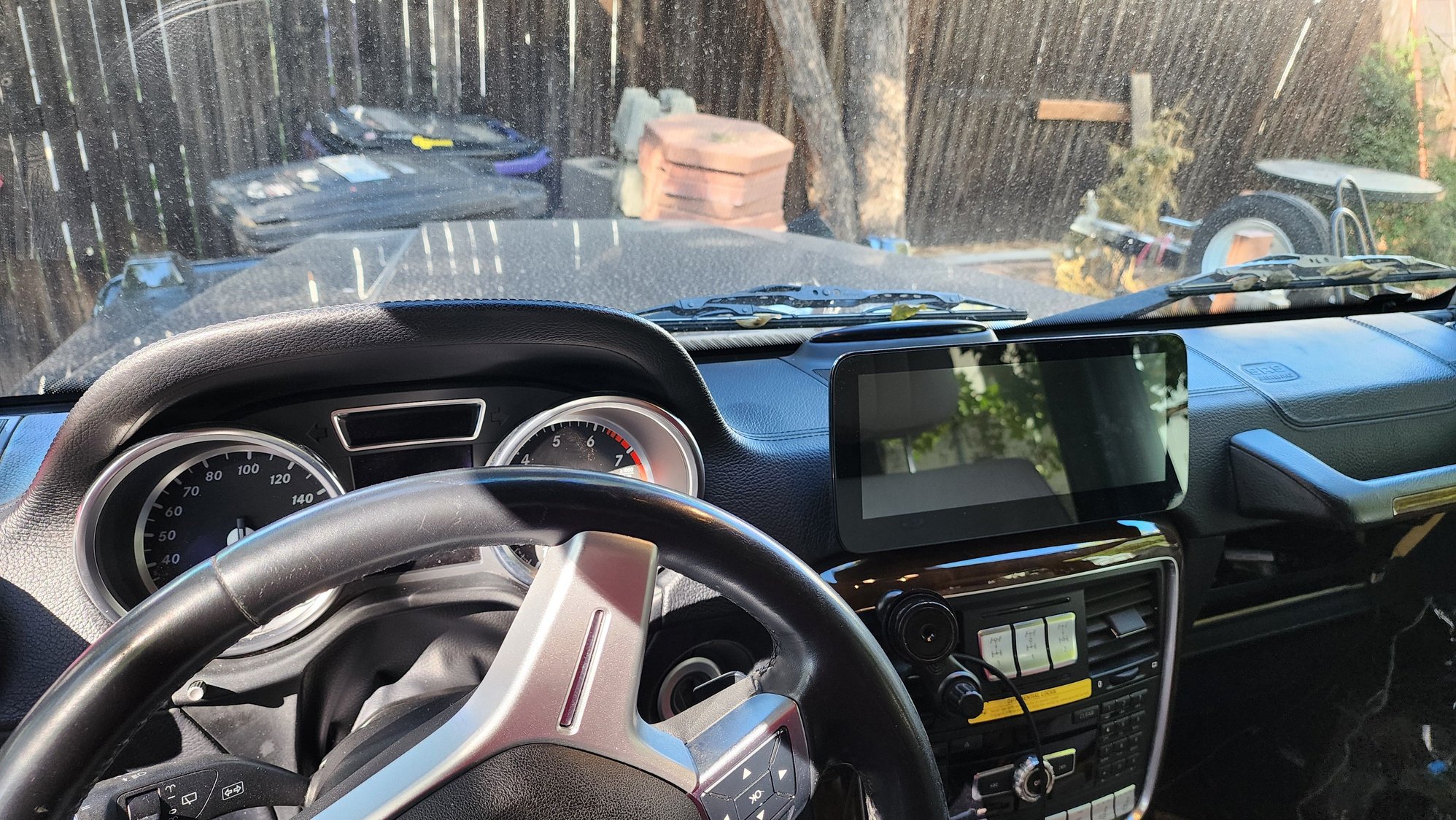

Old Oct 18, 2025 | 12:09 PM
  #36
bejoy's Avatar
Joined: Mar 2024
Posts: 80
Likes: 33
2015 ml63 amg (w166/m157) | 2015 g550 (w463/m273)
here are photos. i'm installing new speakers, hence the mess. i have 12" screen in ml63 and, i like 12" because fonts are bigger and so, easier to read. 10" and 12" have same screen resolution. so, letters on 10" look smaller. i like size of 10" in smaller cabin of g wagon. if you see in photo, i think 12" would be taller and block the parking indication lights. that said, i think both 10" and 12" work in g wagon.
