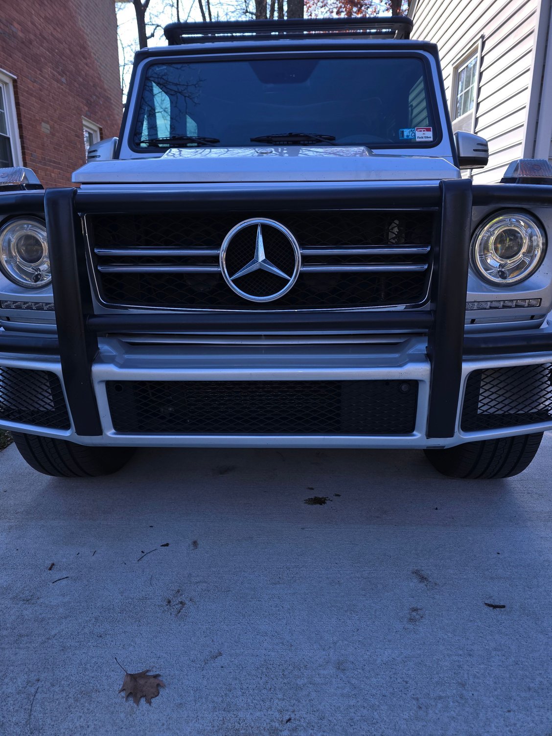

Howdy all. 2002 G500, 180k miles. Very strong service history from original owner.
After a 2000 mile road trip, have come back with an oil leak coming from front left of the engine. I THINK it is possibly the inspection gasket under the oil filter housing? Can't see the leak from the top, but can see it leaking from lower half of the front left. Drops about 3-4 square inches a night. Truck drives great, engine doesn't sound funky.
Anyone have any other ideas as to what it could be?
