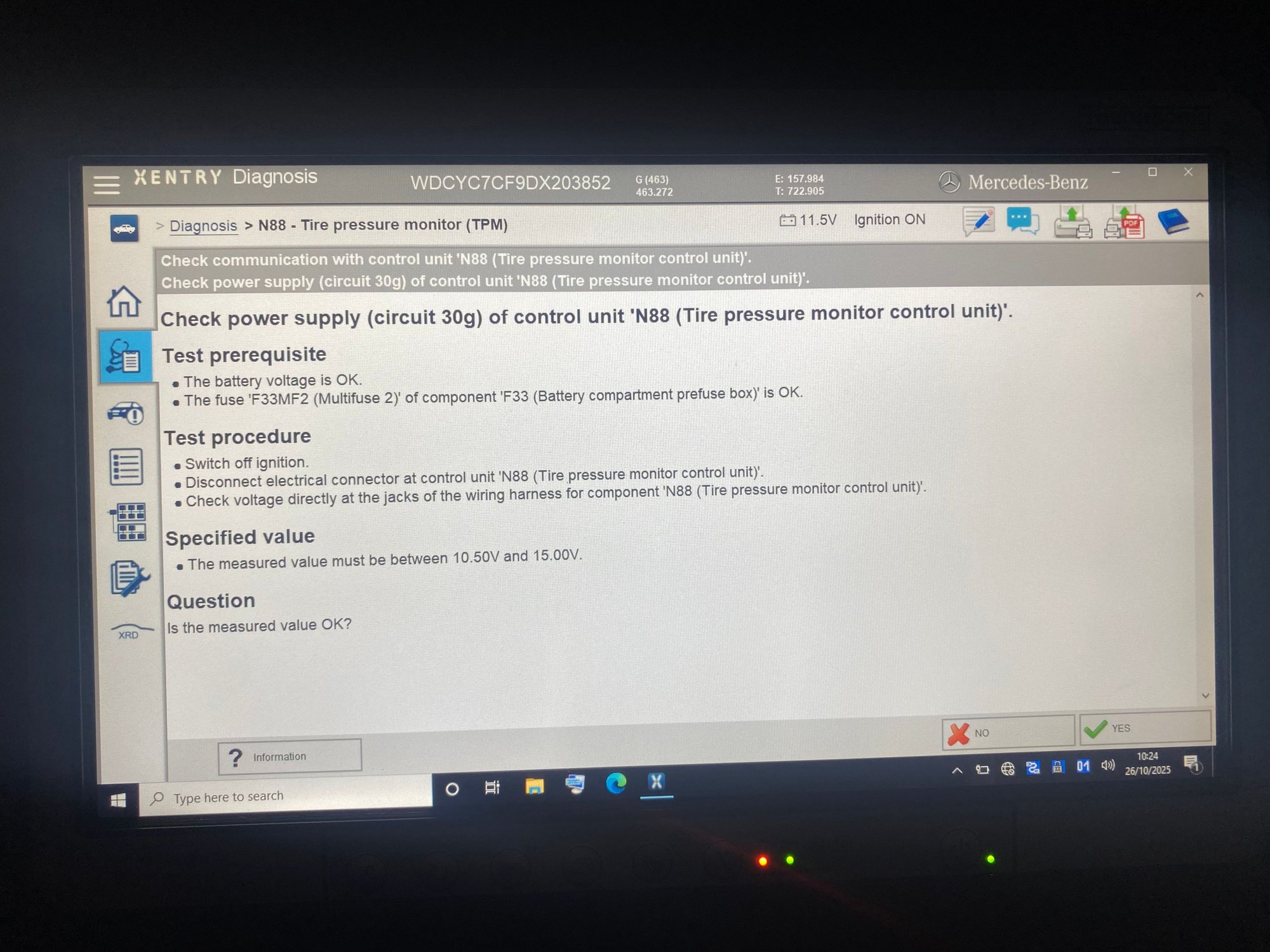

Looking for some help as I can’t locate where the fuse F33MF2 is!
Any ideas are appreciated as everything I’ve googled says it’s by the battery - which it’s not, I checked, multiple times!
Next course of action will see if there is any power to the TPMS itself.
