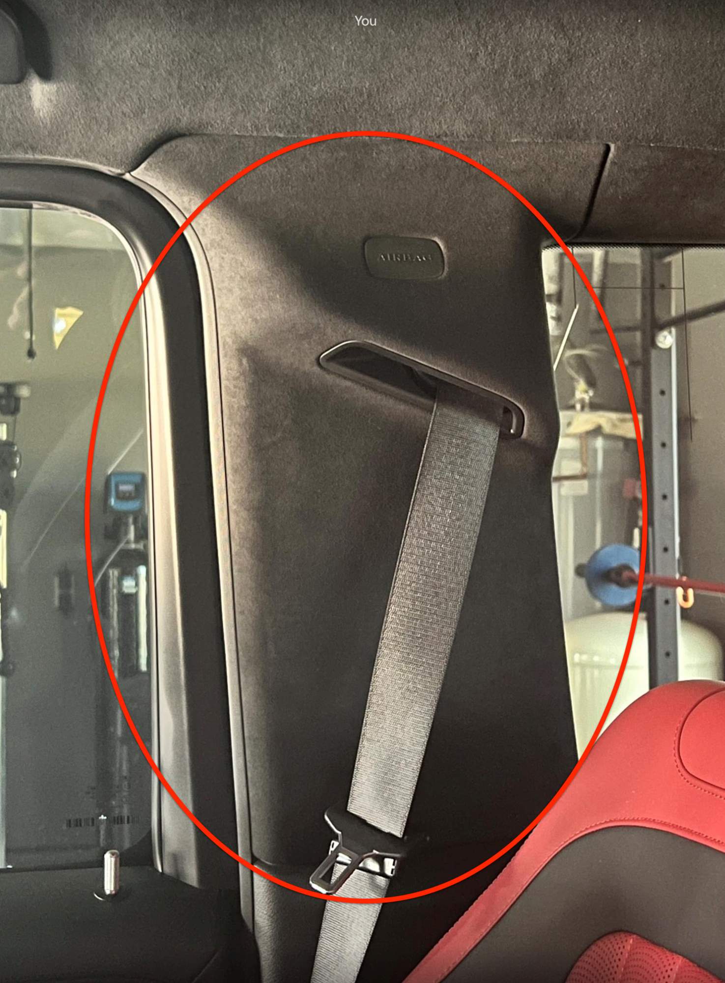

Does anyone know how to remove this cover? A friend told me to pop the "airbag" cover off but even with a pry tool i couldnt get behind it because its embedded in the leather...is there a trick? Thanks!
cover off from left to right behind you will find one screw, remove and then unclip the 3 clips around cover
Unscrew QUOTE=PPL;8651717]Does anyone know how to remove this cover? A friend told me to pop the "airbag" cover off but even with a pry tool i couldnt get behind it because its embedded in the leather...is there a trick? Thanks!
