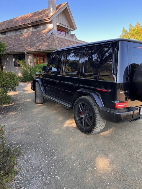

Smile 305-45-22 on '24 G63
I know I’m a few years late to this thread, but I wanted to share my experience. I Installed 305/45/22 Nitto Recon Grapplers on a 2024 AMG G63. No modifications, no level, no lift — and no rubbing at full lock. The extra sidewall on the 45s gives roughly 3 inches of additional height compared to stock 295/40/22s, adding a noticeably more muscular stance while still keeping factory ride quality.
Thanks for the update. Do you have pictures of the 305s look? Want to compare it to the 285. Thanks

1034BCR's Avatar
Joined: Aug 2025
2024 amg 63
Old Aug 31, 2025 | 11:41 AM
2023G63's Avatar
Joined: Mar 2023
Posts: 43
Mercedes G63 AMG
looks really good! Definitely going to go for the 305 especially since it doesn’t rub

Thanks so much for posting this follow up. The OEM 22 rims you have in the picture are a 22 x 10 and have an offset of +36. It looks good and I'm happy to hear there's no rubbing on a stock W463A setup. The 22's I'm interested in are 22 x 10.5 with an offset of +20. So probably a bit further out by a few mm. Anyone feel like that might have more clearance issues than the OEM 22s on 305/45r22 pictured here?
