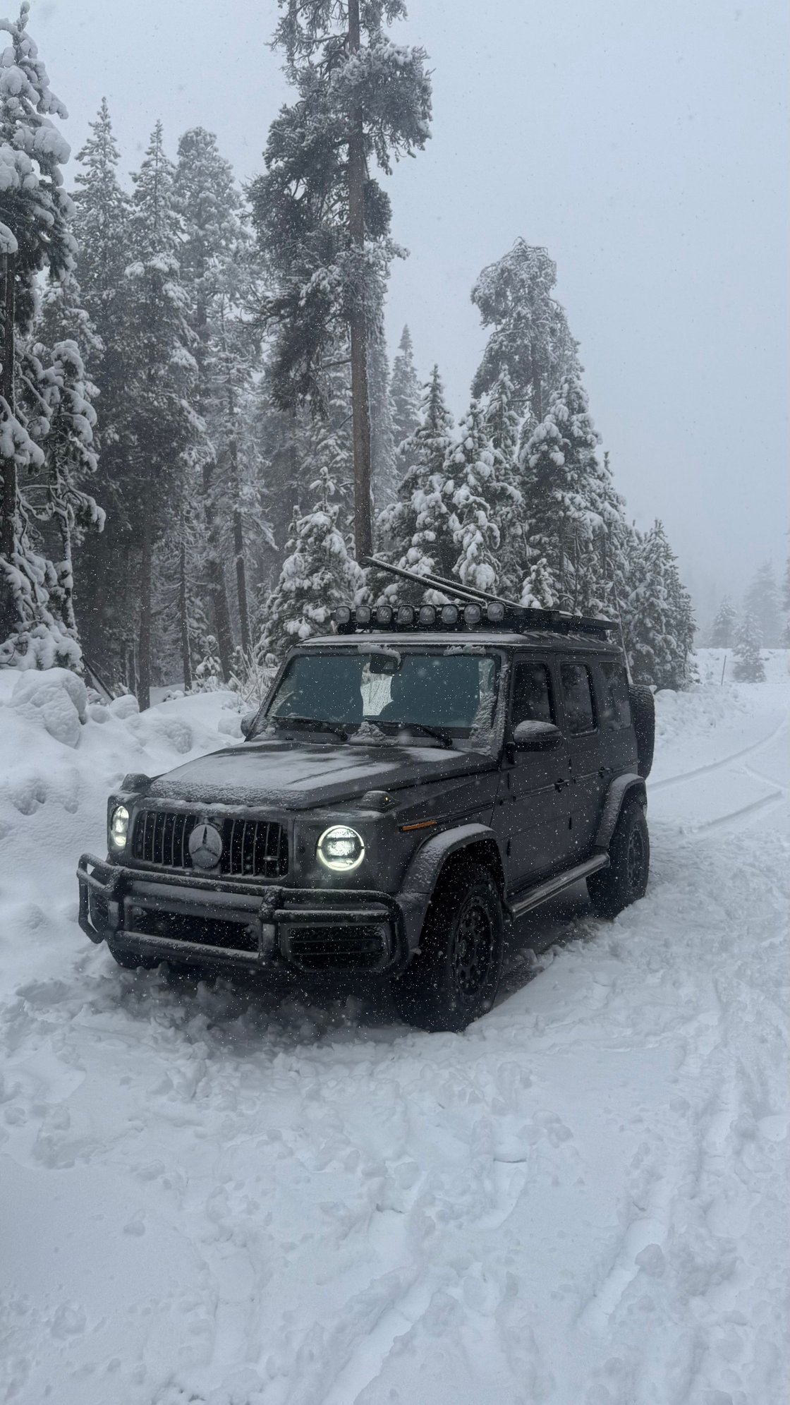

first off I would like to thank you for making this post. It’s what helped me make the decision to go with upgrading my tires also on my G550. Did have a question tho, what PSI are you running on with your tires. After the tire shop got finished, they put in 36 PSI in the front. And 43 in the rear. Max psi is 80. Obviously won’t run at that. Would kindly appreciate your input.
thanks!
Quote: Posting this thread for those who might be looking for such info in the future because I felt the Information on this topic was a bit scarce when I was researching.
Vehicle:
I got a 2023 G550 in mid July and immediately went on a road trip from the rocky mountains to Oregon & California Pacific coast and back putting on 4K miles in the first 2 weeks of ownership. Very impressed and satisfied with the vehicle on the interstate highways as well as back roads.
Intentions:
Being in the rocky mountains I have experienced a fair number of off-road trails with my prior off-road worthy vehicles (LR4, Land Cruiser, Jeep JK, 4Runner TRD Pro) and plan to do the same with G550, so I looked for 18" wheels that would work with some off-road worthy tires. The 20" OE wheels will get dedicated winter tires in the winter.
Wheel Choice:
I ended up ordering 463 Industries CG01 18 inch (Overlanding Edition) wheels which have a +20 offset, making spacers essentially unecessary. I like the fact that these wheels are compatible with Mercedes center hubs caps as I did not want to have 3rd party logos on the caps. Point is that not all wheels are compatible with OE caps.
Lift:
I considered getting the LeTech or Eurowise lift but after a lot of thought, I decided to leave the suspension alone. I have tinkered with enough prior vehicles and decided to leave this vehicle on stock suspension for the foreseeable future.
Tire Choice:
I considered BFG KO2s, Nitto Terra G2s, Falken Wildpeak AT3Ws and Nokian Outpost. In the end I went for Falken Wildpeak RT01 tires in LT275/65R18 (32.3" diameter, E rated, 55 lbs). This is a recent offering from Falken tires and sits between their Mud Terrain and All-Terrain. I think RT stands for Rugged Terrain (or something like that). My first impressions are quite positive in terms of road noise and handling but long term opinion will be formed in the long term.
Tire Size Choice:
The choice of tire size LT275/65R18 was based on the desire to get 0.5-0.7 inch additional ground clearance without a lift. The consensus is that a 32" diameter works without any concerns. RT01s are 32.3" - so I was not sure if this setup would have any rubbing. So I actually ordered 2 sets of tires (Discount Tire) and requested a test-fit i.e. if the RT01 had obvious clearance/rubbing issues, I'd buy my second choice Nitto Terra G2s, which are 32". In. the end, these specific tires on these specific wheels with my vehicle's OE springs seems to have no rubbing in normal situations. No issues lock-to-lock. Once I hit some trails, I will know (and share) if there is any rubbing while articulated.
Spare Mount:
Jack from Jack Wagon Overlanding recommended 911 Motorsports reverse mount. I was able to install it with a little assistance from my teenage son in less than 30 minutes. So it's a simple DIY thing. There are 3 versions of this mount offering 3 amounts of clearance from the back of the vehicle. I got the mid option, but I think with the wheels I got, the least clearance would have been plenty enough.
Shoutout:
@JACWAGN from JackWagonOverlanding was very helpful in sharing information and advice. I felt very comfortable working with Jack.
