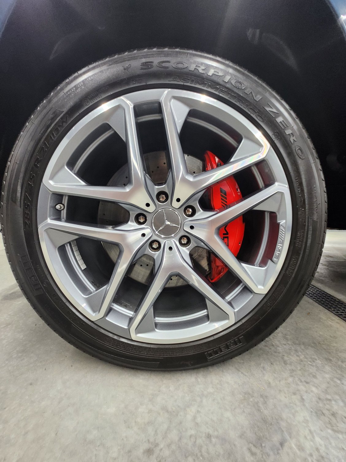

I have 21" wheels on 63 but I would like A/T tires. You can't find any for 21". I wouldn't mind 20 or 22. Any recommendations? I really like the ones I have now. Thank you all!

OEM trail package looks very similar and is 20". That may be the easiest route to go.
There are good A/T options in both sizes so just depends on your preference. The OEM trail package tires are A/T (but not as hardcore as others) and of course OEM-sized approved, but the 22" A/T's are all different than OEM 22" sizes. I'm not sure if there are other options in the OEM 20" tire size.

20" has a much better selection of brands and tire styles, not to mention lower prices and availability. And if your intended use for A/T's is off road, the 20" gives you an extra inch of sidewall cushion.

Is there a good way to know which 20" wheels will fit over the AMG calipers?

The easiest way is to have your wheel/tire dealer check. If you're buying wheels online, call and ask about the wheel's inside diameter. Nominally, a 20" wheel will have 1/2" less clearance than your 21". If you can slide a 3/4" thick gauge between your caliper and 21" wheel, you should be fine. I ordered my G with 20" and it's not AMG caliper equipped, so I can't verify for you. But my BMW X7 came with 22" wheels and massive M-Sport calipers, yet a set of 20" wheels cleared its calipers with 1/2".
