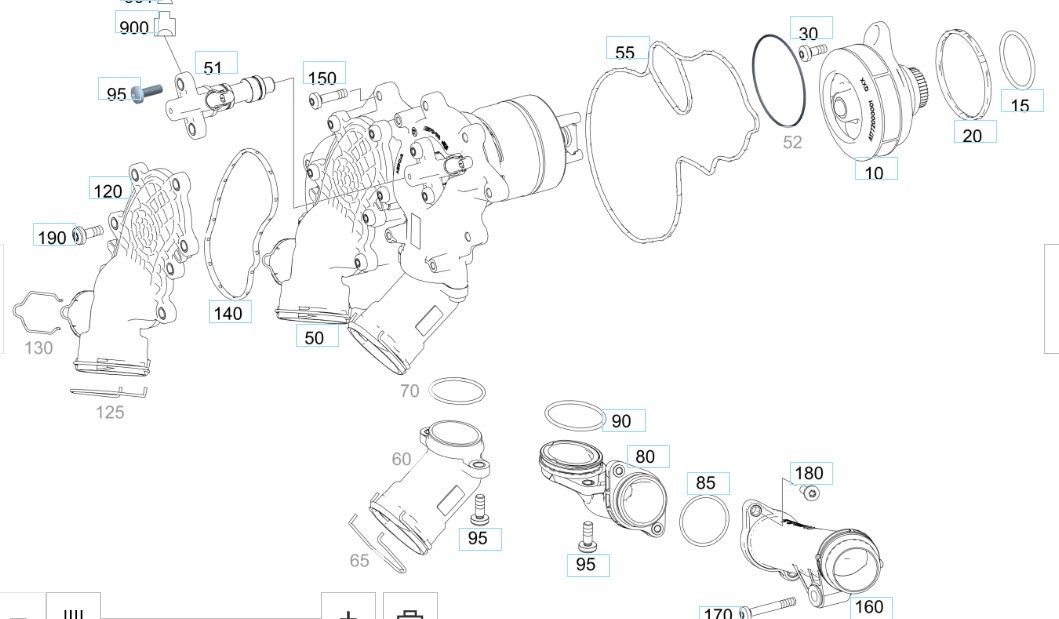

i have a check engine light on, when scanned it shows thermostat is stock open, I am looking to replace the thermostat and water pump together, but I can not find the proper part numbers to buy, could anyone advice

Electric part from the thermostat Item 51 Expansion element A 177 200 06 15
Item 10 COOLANT PUMP A 177 200 04 00
The Item 50 - THERMOSTAT A 177 200 79 01 will came together with the electric part Item 51, but without the Coolant Pump.
I would use a specialized workshop as even if your diag is correct, the labor will need a lot of knowledge and many gaskets.

Do you suggest I should buy gaskets with item #10 and #50 or they are included with them

If you buy #10 and #50 most of the gaskets will be included, but you have to check as the procedure for replacing water pump and thermostat may add to your shopping list some other gaskets/o-rings too.
Your car is expected to any official dealer for 3 free campaigns and one is related with some wires,
