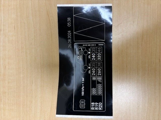

Originally Posted by streborx
Here's a photo of my sticker. There's no copyright marked on it, so feel free to print a copy and paste it on (lol).
Your sticker varies considerably from the sticker my dealer ordered for my 2025 G550. Now I'm wondering if MB changed the PSI recommendations from your 2019 to the 2025's or if my dealer maybe got the wrong sticker.
Here is my sticker, not yet applied to my gas door.
Old May 18, 2025 | 10:49 AM
  #42
streborx's Avatar
Top Answer: 1
Joined: Oct 2019
Posts: 5,154
Likes: 1,769
From: Colorado
G550
There is some difference in the psi specs between the 2 stickers, but note that for normal load conditions, front and rear tire pressures are the same. As I noted above, I run all 4 tires on my G at 34 psi. Recently I have read a couple of articles on the importance of equal tire diameter (front vs. rear) on transfer case and transmission wear and tear (https://www.aaa.com/autorepair/artic...-tire-concerns). Running a high tire pressure on the rear set when not max loaded makes the rolling diameter of the tires front-to-rear unequal (for all 4 tires being identical). I don't know if MBs are affected this way, but why risk it over a couple psi?
Old May 18, 2025 | 11:05 AM
  #43
Risley's Avatar
Joined: Mar 2025
Posts: 173
Likes: 66
Your input is appreciated, thx! I'm at 35psi on all four right now, was at 38/46. What I notice now and understandably so, is a softer ride on crappy roads and heavier steering.
