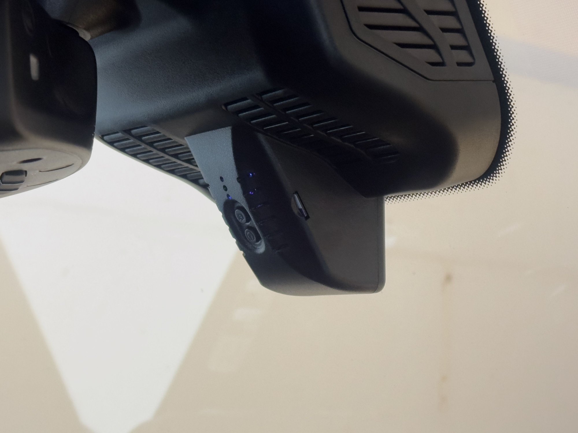

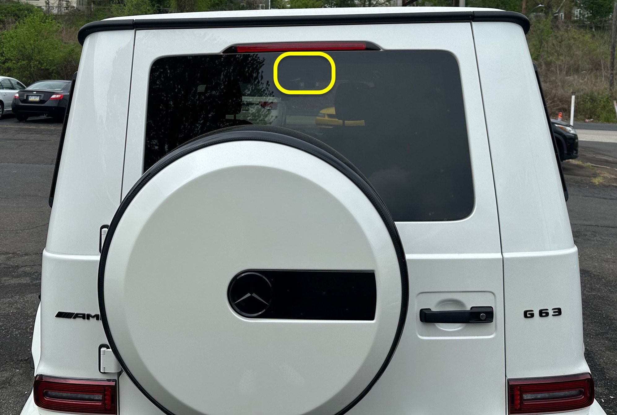

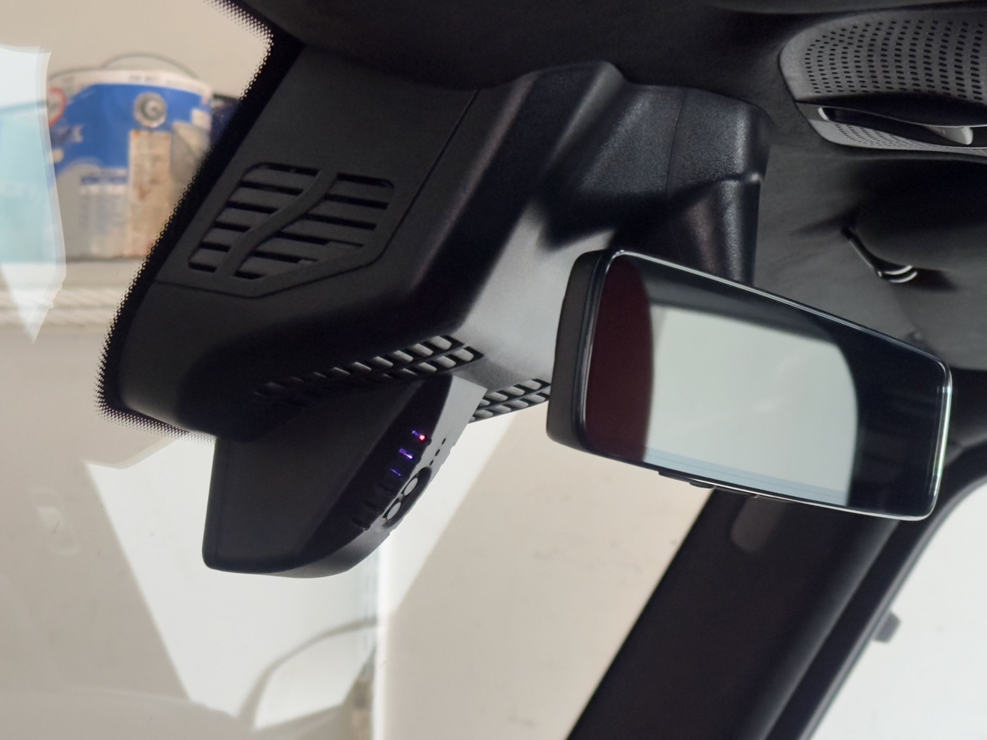

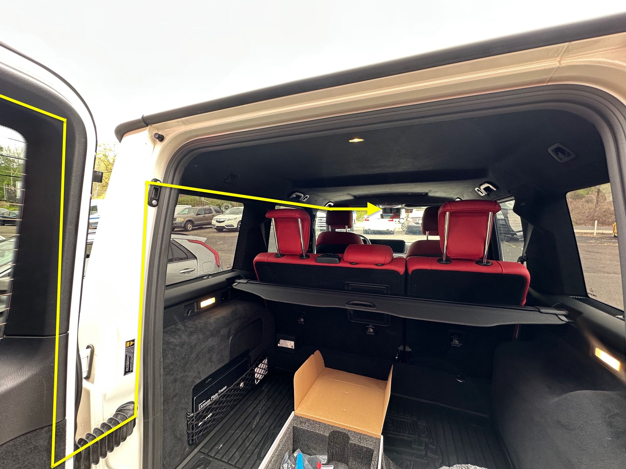

I ended up ordering a forward- and rear-facing unit and decided to tackle the install myself. The kit included clear instructions and even the plastic pry tools. I started by removing the rearview mirror surround, then tucked the wire neatly into the crevices of the seams along the headliner on the driver’s side, down through the door gaskets, into the rear hatch, and mounted the rear camera dead center. Clean, simple, and much more confidence-inspiring than the old setup in my other AMG.
Overall, the install took about an hour and a half. The biggest challenge was the rear camera—while not technically difficult, it required a lot of patience to pull factory-sealed trim away from its original position without damaging anything. Once both cameras were in place, I powered it up to make sure the hardwire kit wasn’t triggering any dash errors. Thankfully, it worked perfectly.
Initial setup with the iPhone app was a little slow, and the interface itself lags when scrolling through footage history, but it does the job. Functionality is solid, even if the software experience isn’t the fastest.
As an overall score, I’d rate the FitCamX dash cam 3.5/5.

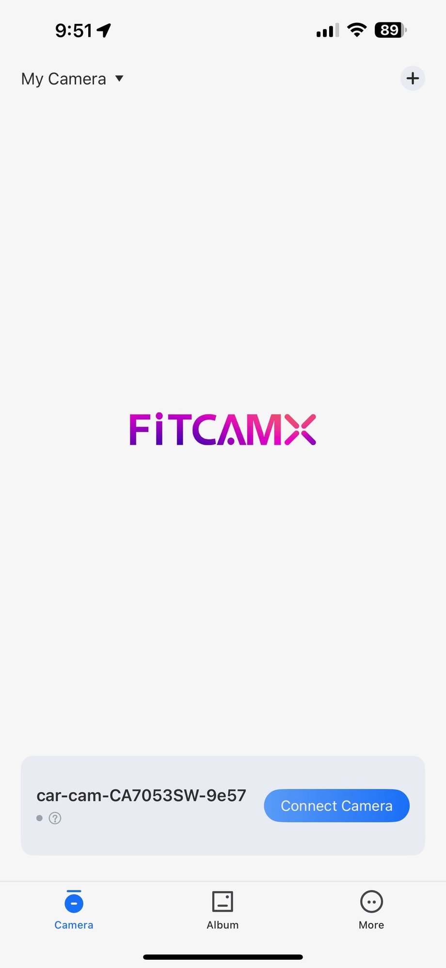

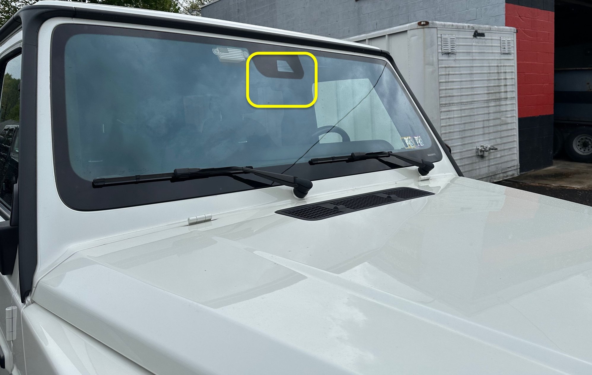

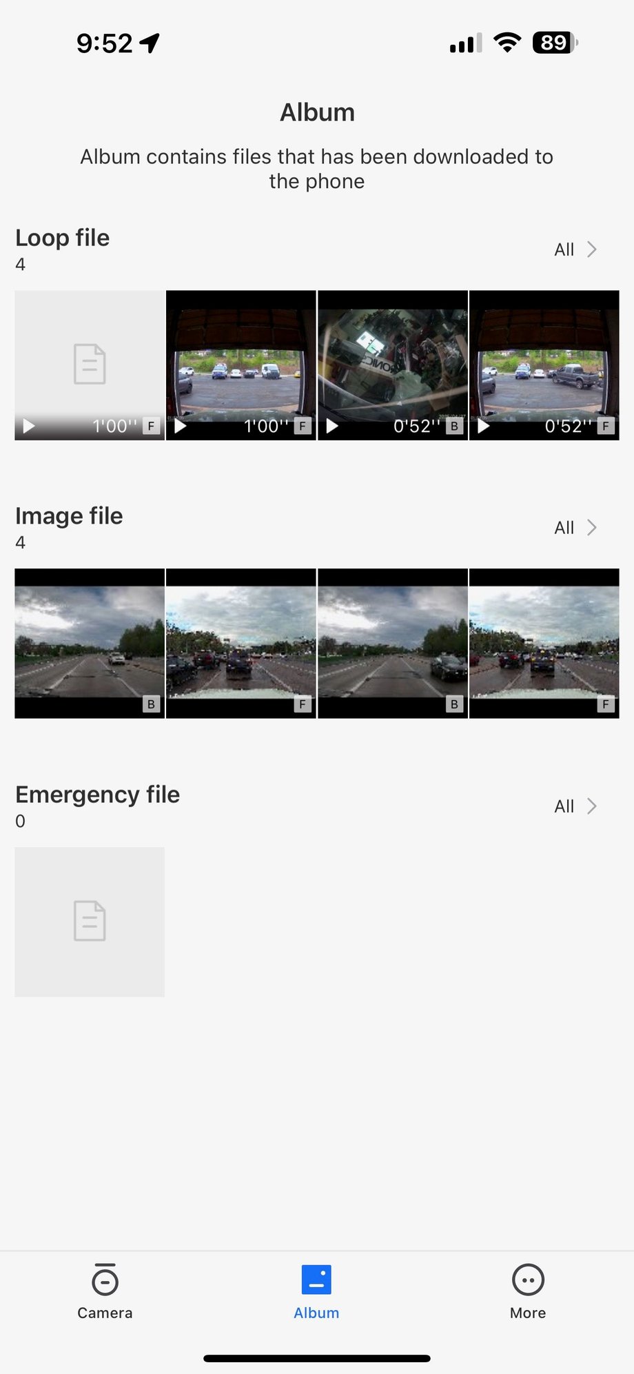

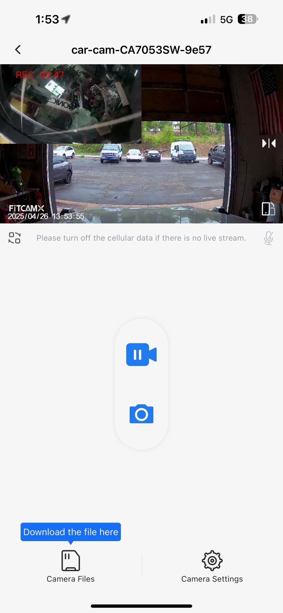

Thanks for sharing....Looks good. I have been interested in this camera primarily because of its rear camera. The factory set up only does front capture. If you can, can you please share
  • Some video clips from both rear and front camera
  • Screenshot of the phone video interface
  • Picture of the housing that holds the front camera.
Thanks in advance!

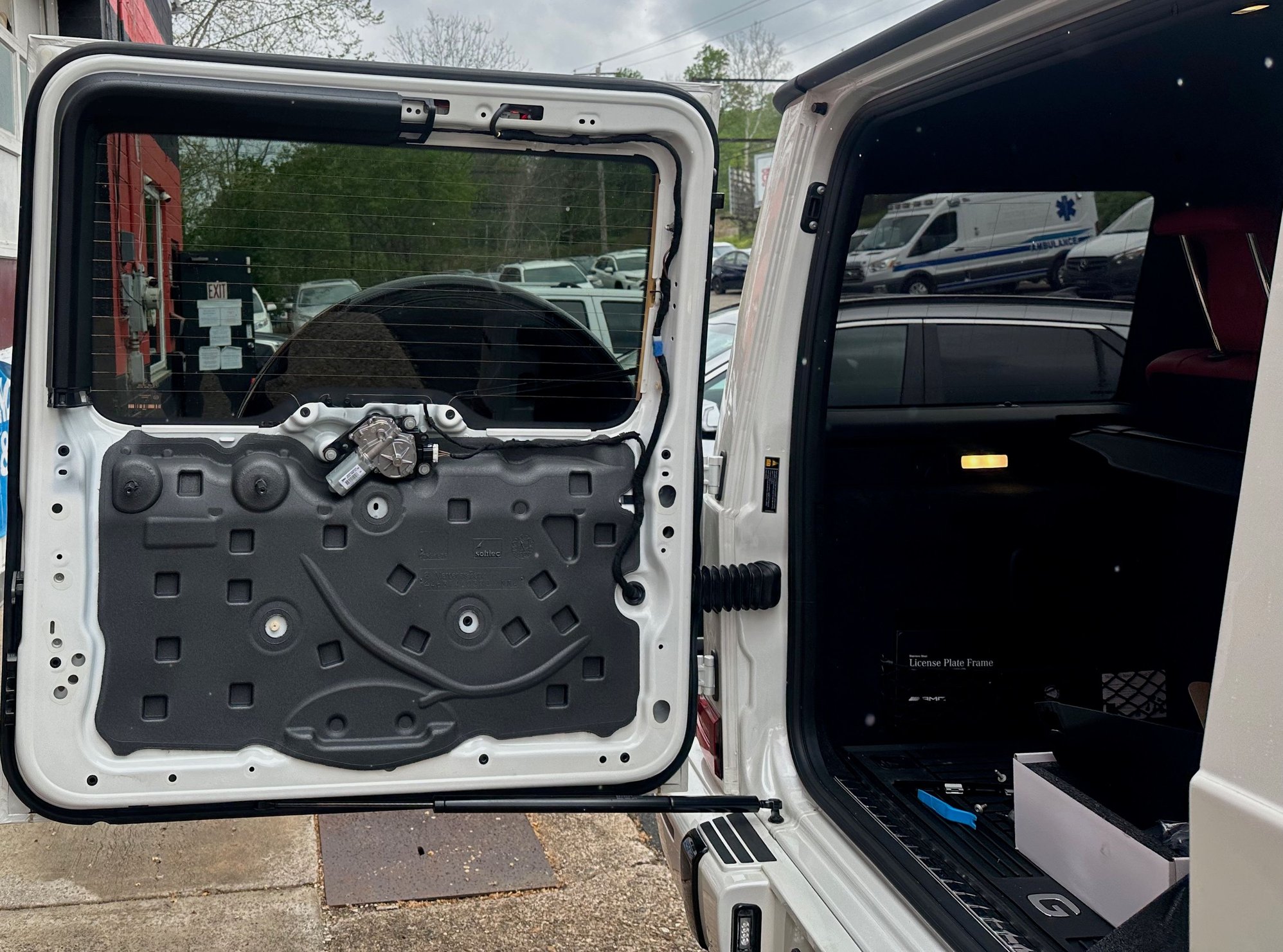

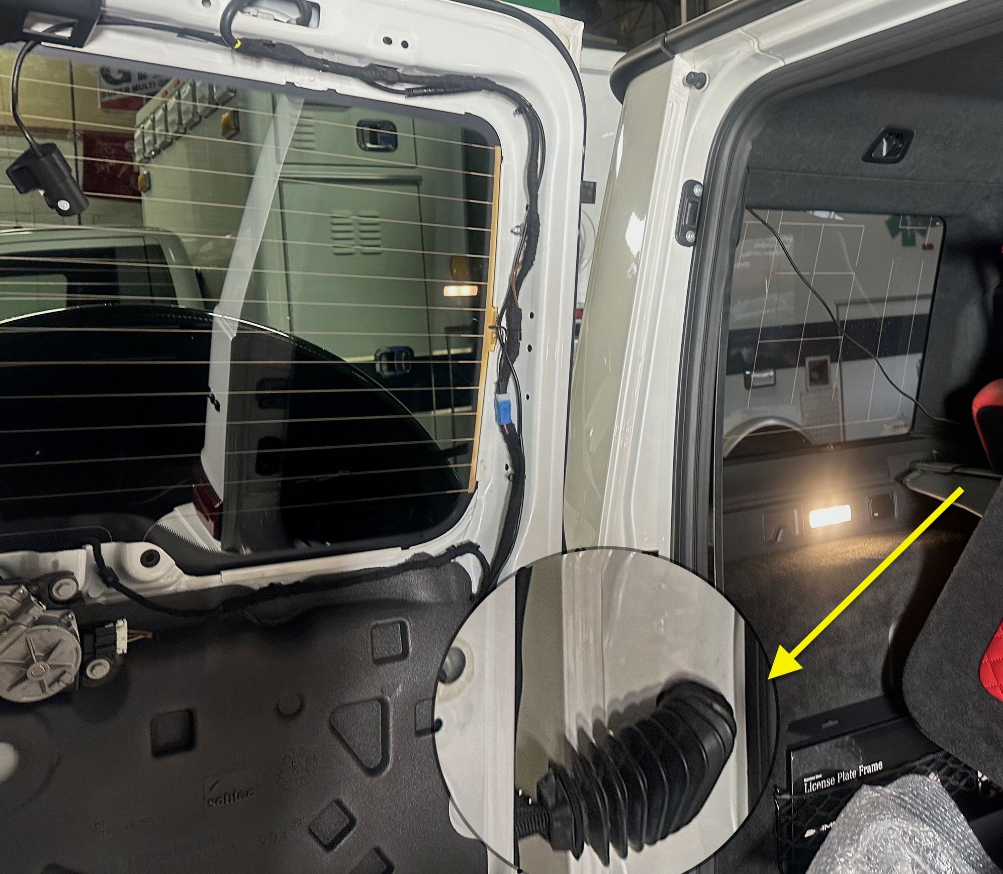

DysCompLexSick How hard was it to tuck the wire neatly into the crevices of the seams along the headliner on the driver’s side, down through the door gaskets? I've been meaning to install this but afraid of the difficulty in running the wire to the back. I was thinking I would need to remove the pillar coverings between the front and back passenger doors, the front A pillar cover, in order to get the wire from front to back? Also thought I might have to pull the rubber seals off as well. Would appreciate more details here. Also, how did you fiche the wire through the grommet to the door panel? Thank you!
Thanks in advance!
Thanks! I am traveling, so I am sharing so pics I have on my device.
It was relatively simple. For anyone DIY'ing anything it's rarely a measure of genuine difficulty instead it requires a mix of patience and determination. I would advise against removing the A pillar and rubber door gaskets as its seems unnecessary. You can easily route the wire falling the seem in the roof using a plastic pry tool to push the wire in place. The main difficulty is removing the gasket covering the rear door hinge. (Picture Included Below) That requires you pulling it "down-then over", my best friend owns a shop and advised me to be careful with this piece as damaging it will require ordering a new one, leaving it unsecured would create a moisture entry point. Other than that the whole process was pretty straight forward.

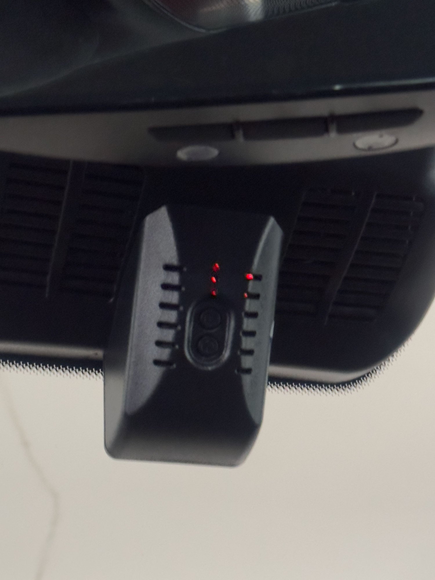

Love Fitcam's have used them in 3 vehicles. Looks like they redesigned the G Class's a little as the SD card slot didn't used to be so close to the edge.
