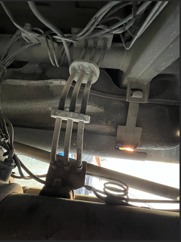

Does anyone know why there are two brake nose for my front wheel?
One is about 20cm and other one is about 50cm, they are connected together in series.
Really curious that why it is like this?
Can I replace it with a long steel brake hose?
Further more, I found total 8 hoses on the car.
3 are at middle on rear transfer case and 1 is at middle on front transfer case.
Shall I replace them as well since they looks like rubber hose.
The on at the front middle is with one side of banjo fitting.
Any suggestions?
Thanks

Yep, I'd replace all. The one for the lockers looks the same as the other two in the back, the banjo fitting bolts to the hose. So, you'd need 3x equal length of those. Then 2x in the front (they are called inner and outer, or upper and lower), then 2x (lower) by the caliper in the rear. That makes a total of 9.
