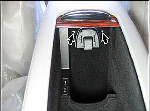

IF you have the connector in your console you are good to go.
If not, you have lots of wiring and electronic boxes to install first. Plus that connector. This will cost WAY more than $500.
The connector should be on the back wall of your console and look like the one in the photo (ignore arrows).
The latest version of the interface module is Mercedes part # B6 787 6131 and MSRP is indeed $493 for that part. It's $369.75 here: https://www.getmercedesparts.com/oem...des-parts.html
When entering part number at that website, omit the "B."
