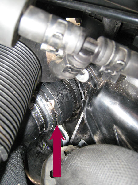

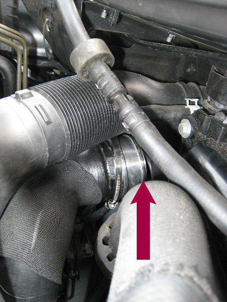

First photo is the Q2 hose which is detached
Second photo is the Q2, Level II hose after installed
Attached Thumbnails The end is near....-q2-level-i.jpg   The end is near....-q2-level-ii.jpg

Thought this might make it easier to see the difference...thanks for the images Jack. Tight quarters and hopefully for all 320 users a good fix.

You are *** kidding me!!! A worm drive hose clamp? How about a threaded collar and nipple arrangement with Lock-Tite sealant? Big opportunity for the aftermarket.
