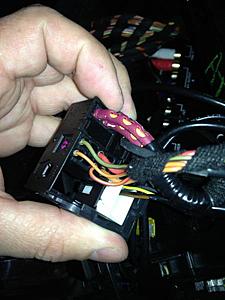

Thank for the help! That is exactly what the problem was. When looking closer at the IPod kit it does not have a jumper for the fiber optic cables and it was simple enough to remove them from the original connector and plug them into the new harness.
The attached photos show the orange colored fiber cables with a purple strain relief. They are removed from the original and into the new connector.
