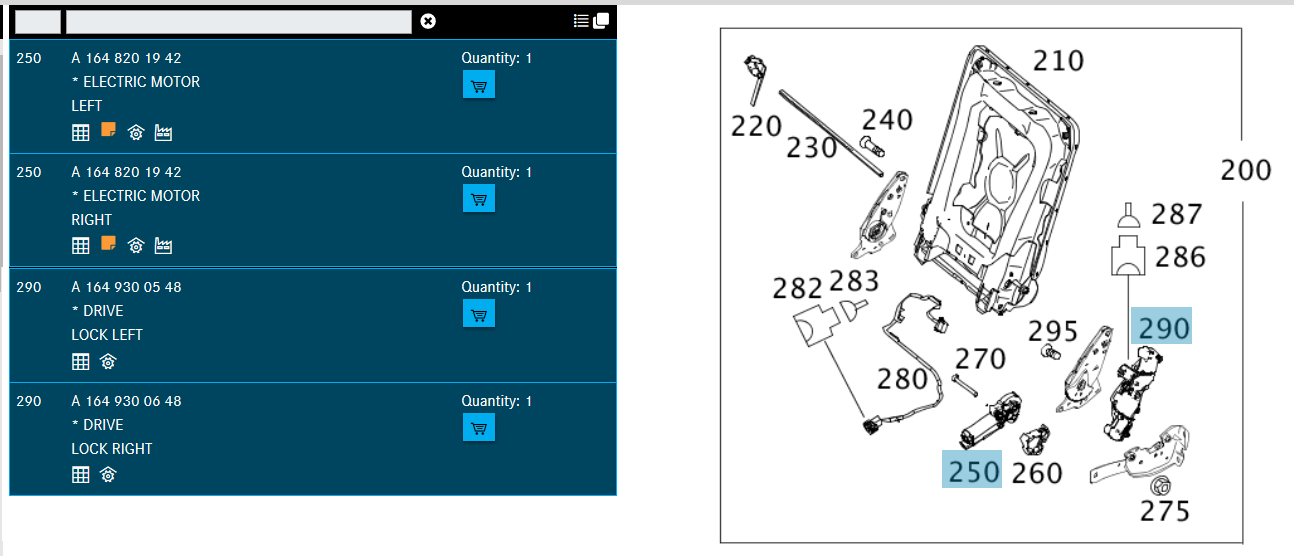

the motor on this diagram is number (6)
if there is an Actuator what number would it be ???
Is part number 8 the Hall Sensor, or?

The sensor is part of part #290:

I appreciate that very much. Unfortunately the right and left Drive Locks are each over $400 at the dealer. I'll find a way to make my seats manual before dropping over $800 for power rear seats.

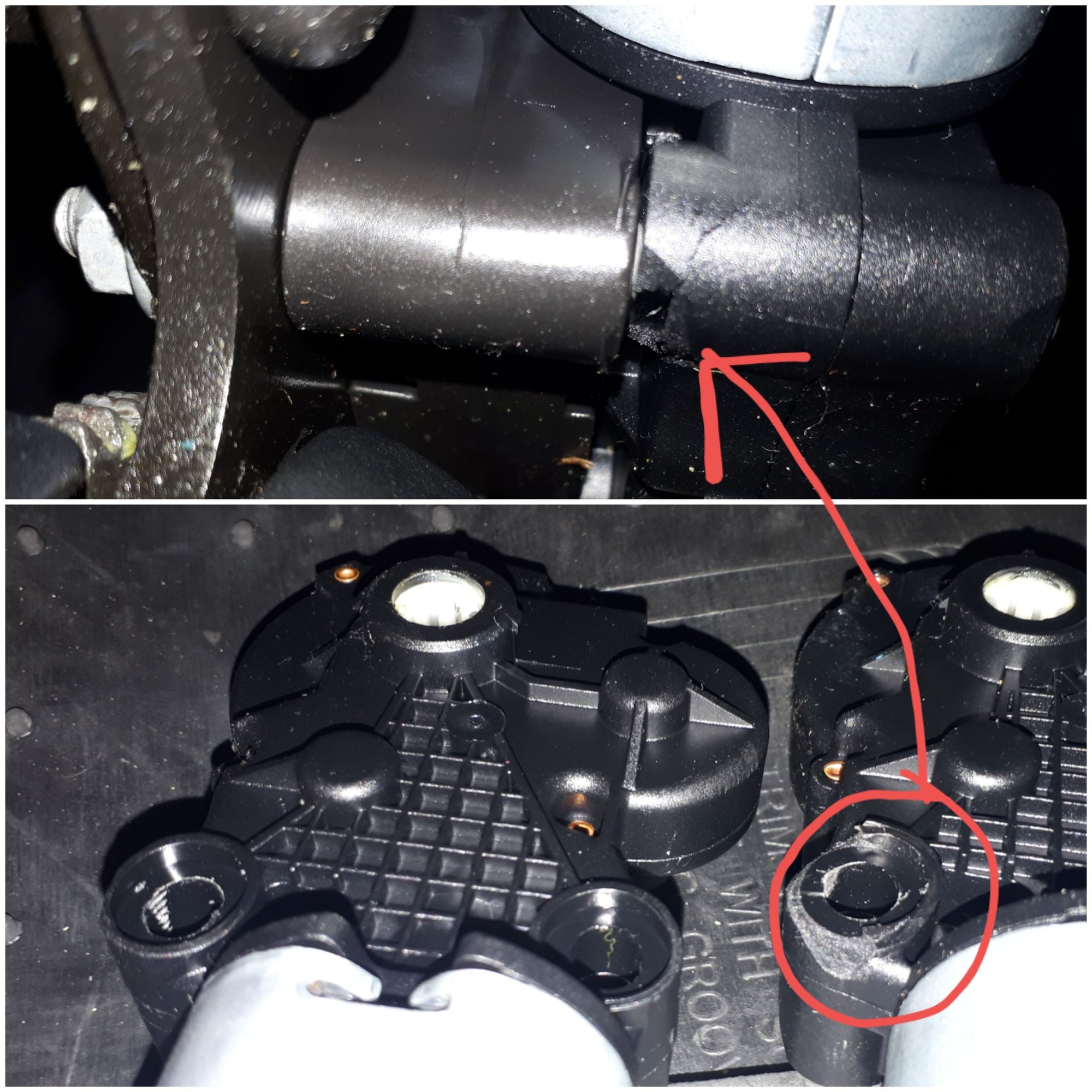

Anyone who didnt find stuff under the seat figure this out? My left seat was moving slowly and skipping and wouldn't lock up or down. Close inspection showed damage where the motor is bolted to the frame. (Anyone else think its dumb they attach the motor with one bolt, and the mounting point is a thin plastic collar? If it cracks or loosens at all the motor gets out of alignment. There is clearly another mounting point, I'm going to get another long bolt for that.)
found a used motor, swapped it out. Now the seat moved smoothly but still won't lock. Do I need to change/adjust the hall sensor? Is there a way to test it?

Update, fitted a used seat and it now works properly. Clearly it is the lock or sensor in the seat that goes faulty, but in my case a used seat was cheaper and much faster than buying and replacing the lock mechanism.

junk yard. Suspect in could have made the old one work, the motor I think skipped a tooth (or six) but I couldn't seem to get it synched
